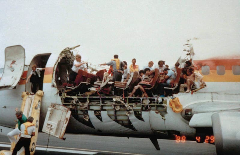

Seattle times story said:
No one was injured in those incidents, but in 1988 an Aloha Airlines flight attendant was blown out through a hole of a Boeing 737 as it flew over the Pacific Ocean.
'Hole' sort of understates it. The stewardess blew away because the plane no longer had a roof and she wasn't seated with a belt on.:
To be fair, I don't think a modern aircraft would have survived that with only 1 fatality.
It also had 90k sectors/pressurisation cycles.
Which is the life limit for 737's for most of the major parts such as the main spar etc.
Here is the report.
Quiet how you can't spot a split in the fuselage skin during walk round during the day I really can't understand. I can only put it down to shite standards by the crew. Ie it was bounce multi sectors and they couldn't be bothered getting out the FD to do a proper walk round. And that's old school American home boy's. I know its boys because it was purely a male job in the 80's apart from under 100 females who all worked for the likes of UA and AA and the like.
But you have to be impressed though that sort of failure and they still managed to land it and the fuselage stayed in one piece. Proper Boeing engineering. Not some Macdonald Douglas MBA designed crap like the MAX.
The window belt on the 737 classic is only good for 50,000 cycles before required modification, for the airframe to make 75000 cycles. For many examples 50,000 cycles became the effective life limit cost wise.
Relevant Boeing article on airframe limits.
A freight operator I worked for a few years ago, had an incident where one Saturday morning while washing an aircraft they found a fuselage skin crack on a 737 Classic freighter(lower aft fuse, classic acoustic fatigue resulting in chem milled step cracking), by the time they had washed all 4 airframe, three of them had been found to have the same crack. The last one of which wasn't found officially till Wednesday. It wasn't great but we didn't find it greatly concerning, having no paying punters simplifies things a lot (& we had bigger fish o fry).
The FO on the Aloha plane was a woman, who was PIC at time of incident.
Glad to be wrong on the sex of the pilot flying.
Where does the 90k come from is that the wing spar limit?
