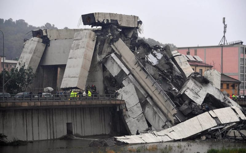

This is the third deadly collapse in which maintenance on a bridge, open to traffic was a factor: twin cites interstate, FIU pedestrian, and this. The video shows one of the tower structures collapsing after the roadway. I haven't been able to see how many of the non-cable stayed segments of the viaduct collapsed (edit: apparently none.).

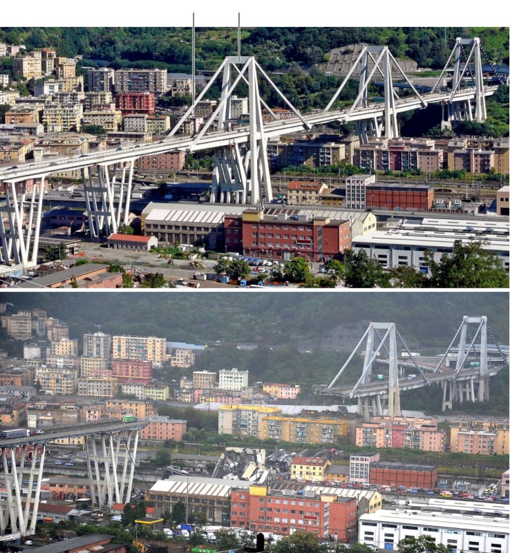

"From the photo posted by bimr above, the two cable-stay assemblies are still standing."

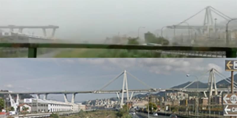

Two of them are, but there were 3 stayed spans (see the Google streetviews posted by cooperDBM).
I think you're on the right track, though, because the video appears to show the tower collapsing (or being pulled down) after the deck had already come down.

I'm thinking the obvious happened and one of the stays failed - either in the stay or, more likely, at the upper attachment, causing the deck on that side to twist and fall, which then overloaded the other stay on that deck segment. Since the main span could not survive as a cantilever it fell, the unbalanced load cause the upward V to tilt and fail, dragging with it the other span. The finale was the stays on that side pulling the tower down. Because of the asymmetry of the initial failure the failure of the far side was also a bit asymmetric.
It's possible the stay was already compromised enough that a lightning strike was the last straw, though the additional wind load might also have done the trick. Or maybe a rust fragment finally grew a bit too large.
The stays for the spans over the inhabited/apartment areas had already been reinforced with bolt-on steel, and the failed section had it's upper stay ends reinforced with external steel plate. It's clear that someone thought that the stays had a high risk of failure.
I'm still wondering if the pier was partly undermined by the floodway beside it - enough to cause a tilt and overstress. Seems there was a severe storm and judging from the video I posted earlier the floodway can fill up. Many bridge have come down that way. Some relief that the span over the apartment blocks didn't come down.

I can't find any photos suggesting any additional external reinforcing to saddle region of the Western tower that collapsed. Certainly none in the Google Streetview of 2017.
Just a couple of observations based on the street view posted by DBMcooper:
DBMcooper said:
* The most eastern tower stays have been girdled and surrounded by cables that appear to have enough material to entirely replace the original stays.
* The middle tower stays have supplemental steel girdles at their upper ends, possibly to reinforce their attachments to the tower.
* The western tower and stays, which were involved in the collapse, appear to have none of the reinforcements applied at the middle or eastern towers.
Not that that means a lot, but it does suggest some possibilities:
* The reinforcements applied at the other towers worked, making the unreinforced tower the weakest link.
* Officials underestimated the deterioration of the western tower and stays, and so failed to apply any of the reinforcements to it.
Of course, it is quite possible that other factors such as instability at the tower foundation dominated the collapse, and that the reinforcements were irrelevant.
