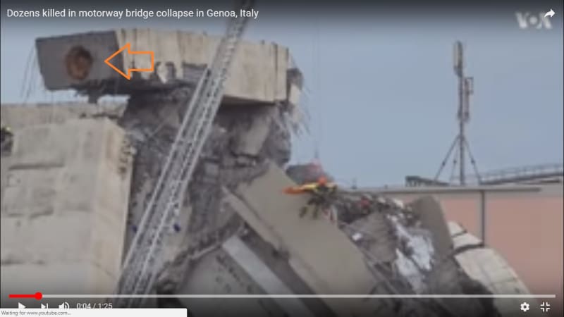

I don't even know what part of the bridge structure I'm looking at, or if the rusty circle is a tube or solid, but I have seen it in more than one video and at lease once in sunlight so I'm sure it's very rusty...
A screen capture from this video:

Stress corrosion cracking (SCC) was a big concern at the nuclear plants I've worked at. I don't know much about it, but I always heard that term being floated around in meetings. Link Might be what Mr. Brenchich was referring to.

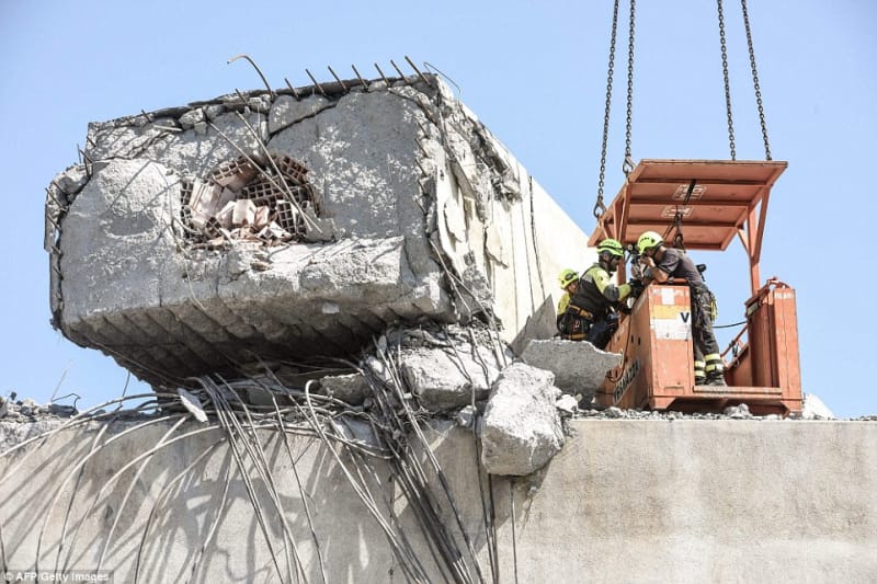

SFCharlie - The voids in the photos are in the columns of the towers. It looks as though they were made using cardboard void forms. The voids are to prevent the heat of cement hydration (exotherm) from causing subsequent stress in the mass concrete from shrinkage and other ill effects.
epoxybot,
You're a structural guy. That doesn't look like much rebar in that tower, in fact I only see a layer just beneath the peripheral surface. I don't think that would make the grade today, would it?

I have been wondering about the apparent skimpy re-bar also.
Referring to the picture posted by epoxybot, is it normal for a single layer of re-bar to be positioned that close to the surface?

thebard3 - My knowledge of structures is from a manufacturer/supplier career in the Concrete Forming, Repair, Materials & Sub-Contracting side with a strong emphasis on structural repair - namely epoxy and other polymers. When I first registered many years ago I wasn't sure what category I should list. Last time I checked there isn't really an "Associate" category.
I don't disagree, that the column looks "Basic". My knowledge of Mass Concrete comes largely from reading the Bureau of Reclamation's "Concrete Manual". Certainly by today's standards this would be considered "Under Nourished".
What also stood out to my eye was the shape of cleavage plane. I would have expected more of a fractured surface. The photo I posted is suggestive of a cold joint region and the rather smooth, almost chalky break raises concerns of carbonation of the cement.
Cant comment on the amount of reinforcement, but concrete cover of steel reinforcement can vary between 1 and 3 inches. I dont know know Euro-codes of from the 1960's. But I would guess its in that range.

We're professionals here, let's try to keep the speculation under control. As we saw in the FIU collapse, sometimes members of the public or press tend to wander in here and take the opinions offered as engineering fact.
As for the reinforcing, yes, it was and is common in piers of this size to have reinforcing only around the perimeter. After all, that is where the steel is most efficient.
A failure surface like the one shown above is an indicator of a sudden failure, rather than one that developed slowly over time (which would be rougher or more "fractured"). As such, it is most likely that the column failure was a result of some other issue, rather than the root cause.
