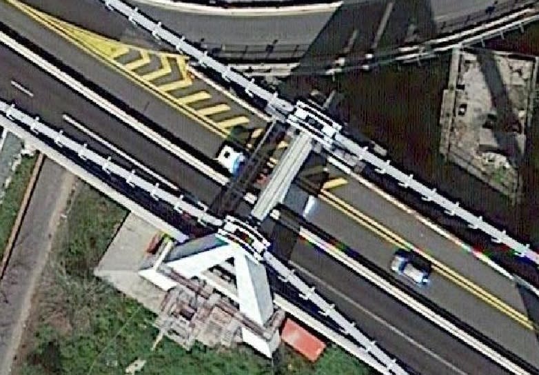

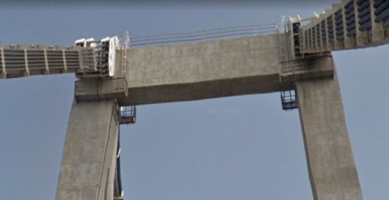

I can't single step the video, but kept clicking back to 00:37 from 00:38, and it looks like a truck/bus passes by the "closer" right side stay, then there's an almost imperceptible movement in the stay/deck - not sure if it's happening on the "farther" right side.. maybe the stay moves, I can't see deck move. At ~00:39 the cross-piece breaks in middle, then everything comes down - can't see the top of the tower, but I'd think it'd get pulled to the "farther" side.

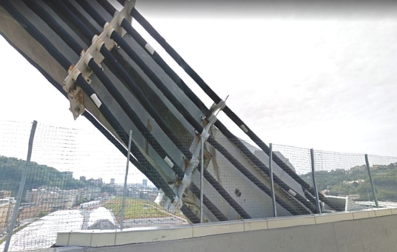

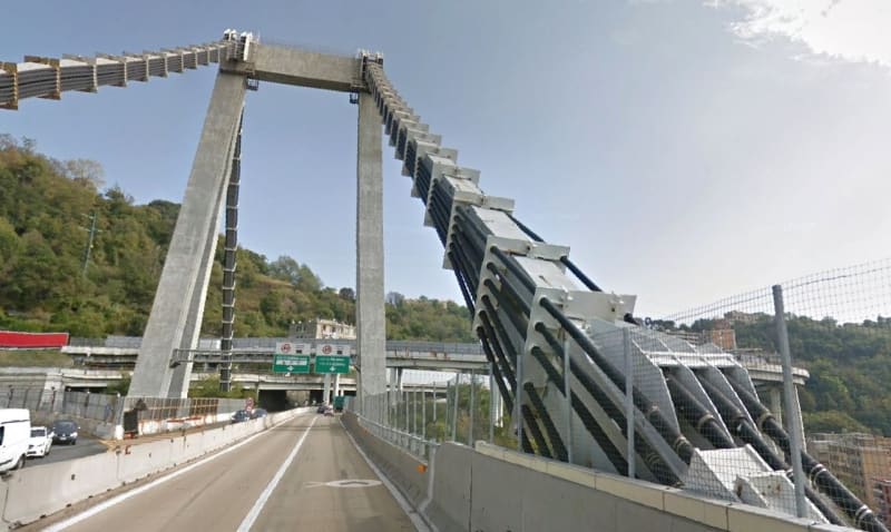

I wondered how bad the east end was before they stabilized it, and how they determined the condition with cables embedded in concrete. Seen in Vikko's post above 17 Aug 18 17:25, the center tower had plates at the top, the west (failed) had nothing, and the east end looks "super supported" and expensive (I'm not structural but looks much stronger than what could be within concrete stays).
