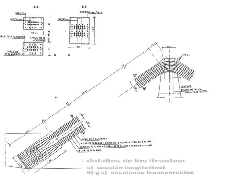

As you can see on page 10 of the document posted above by robyengIT (31 Aug), the tendons are continuous over the top of the A frames, so breakage on one side, especially if near the top, where corrosion was likely deeper, implies immediate detachment of the other top end.

Thanks, Prex.[ ] That would explain it.[ ] I was misled by the animation showing that both stays broke near their middles.

Hmmmm,
Had missed that drawing. I think any break anywhere in the top half of the stay above the split would be enough.
