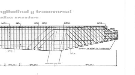

the full project explained in details by the designer himself, Mr Morandi (immediately after the opening)...
Wow, the level of detail in the diagrams is pretty amazing.
Kind of a hijack, but one of the things that impresses me about the design is the use of diagonally-oriented rebar to increase the shear capacity in the area where the support struts react concentrated loads into the viaduct sections. I think if Denney Pate had seen these diagrams a year ago, we might have a lot less traffic here in the failures & disasters forum.

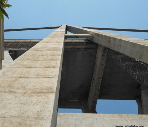

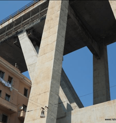

I have my doubts about this also. I'm not sure that the designers of the video / slideshow, realize that the pier structure is actually two separate structures as far as I can tell. You have the two A frames which are held together with two concrete beams at the top and under, but not supporting, the road way. These then have the suspension stays at the top.
The second structure within the footing of the A frames is a Y shaped support which actually holds up the deck in two locations centred on the A frame. See the pictures below.
Thus when the slide show shows the bridge deck rotating, it would impact the horizontal support tieing the two A frames together which would probably start a collapse of the A frames.
