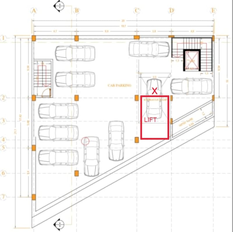

Your points of view are highly appreciated. If I move columns in gridline 2 (except the one on the right side boundary) to gridline 3, would that help? Would that make any concern?

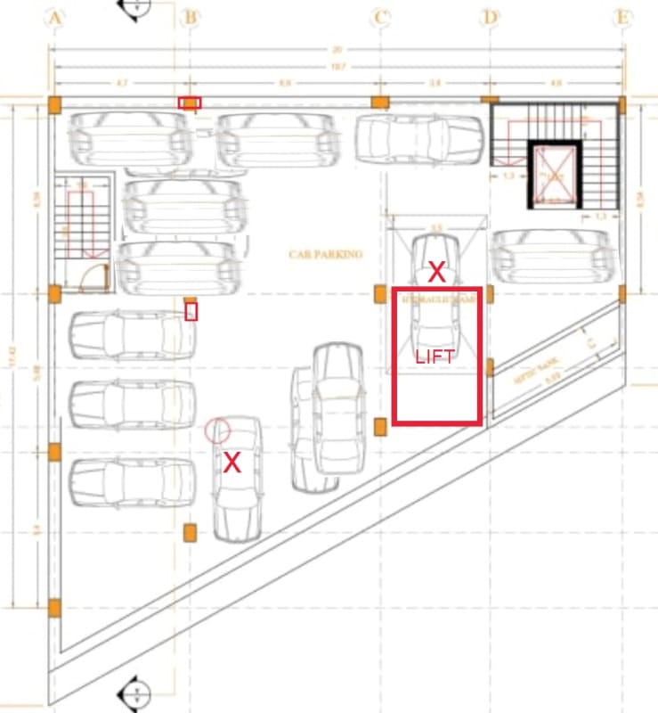

If you can relocate the columns, you should determine their location based on how it affects the parking. It's not a matter of simply moving/removing columns. with your beam system you should be able to move them along the grid independent of the 'crossing' grid location. You should look at the parking layout, determine what works best, and look at the column locations that best suit this. You have to look at this first. If there's an architect involved he would normally be the one that determines this. There's a little more to it... can you look at where you have your elevator? There are so many variations. Moving the elevator forward gives you a little more main floor space and may improve parking like the attached.
another possible layout... You need to determine the best parking layout first, then locate your structure. In addition, you can designate some parking spaces for 'small cars' if that helps.

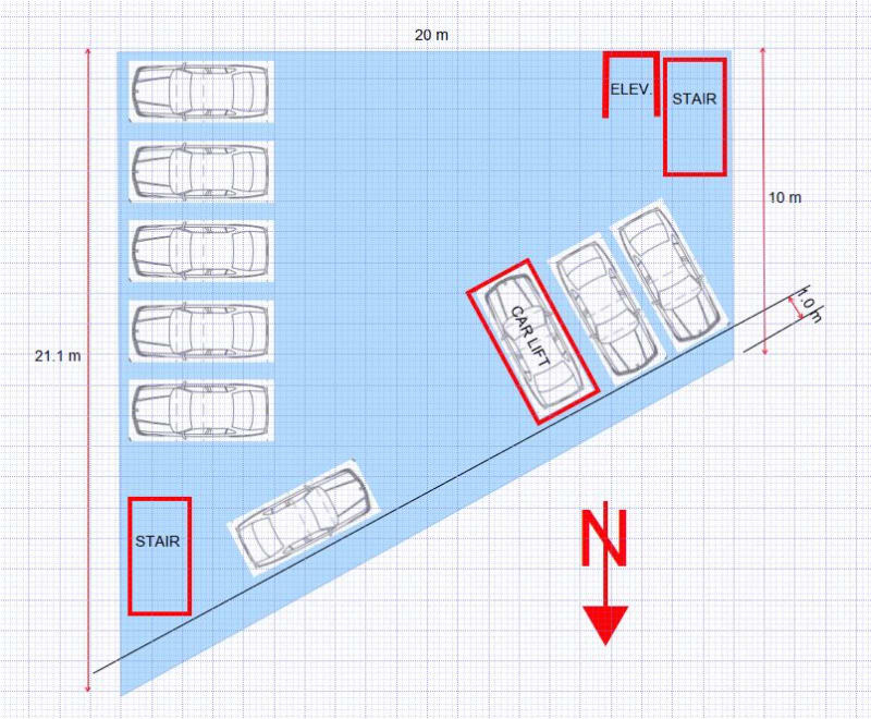

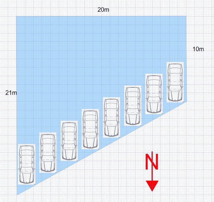

My suggestion: Move the north wall to the property line and park eight cars as shown. The advantage is that a portion of each car extends underground beyond the current north boundary, so it makes maximum use of the space. The hydraulic lift should align with one of the stalls.
Locate the stairs so they do not prevent access to parking stalls. With a bit of luck, you might find a ninth parking stall somewhere else.

If I assume that a room with a cross is some type of shaft (for example for ventilation) it gets interesting. There are a number of rooms with windows into shafts, perhaps some type of light intake but it still looks weird. Regardless of that, it should be easy to move the inner columns vertically in the walls. That could be useful for improving the parking.
Can't be moved. It's a requirement to setback substructure 1m from the property line.
Can you elaborate more on this?
I don't think it needs more information. But if you look at dik's post from 31 Dec 23 21:28, he moves a column in Grid line B and instead of two cars near the staircase there is a possibility for three cars.
Another option is if you take BAretired's post from 4 Jan 24 01:18, say that you remove two cars at the bottom corner near Grid line A. Then it might be possible to add a line of cars along Grid line A.

The best approach is to find a parking scheme which works, then worry about where the columns go. You have to leave enough room for the cars to maneuver. Otherwise, you'll be having collisions. The plan below is by no means ideal, but it is a little better than your original scheme.

Thanks for your effort. Where the septic tank should be located in your scheme? Also for the apartment floor, your scheme has too much corridor between the stairs (main stair for daily use and an emergency stair for fire exit etc.) Not enough area will be left for the apartments and opening area (20% of total area requirement), isn't it?
