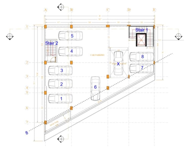

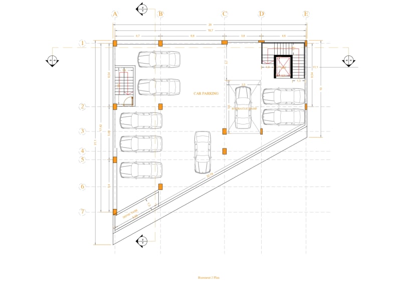

The septic tank can be underneath the grade slab of the lowest floor. That is where septic tanks usually go. The stair on the left is only two flights to provide a second exit to ground floor from the parking floors. I am not aware that two sets of stairs are required in the upper floors of the building.
Which code requires 20% open area? Are you using mechanical ventilation? And if not, why not?
hoshang said:
The left stair is 3 flights.
What did you mean with that comment? And why three instead of two?
How do you intend to meet fire separation requirements at the car lift? I think it will require a firewall on each side plus a fire rated door on the inside face, similar to an elevator.
If you intend to stick rigidly to all of your original design constraints, hoshang, the site is just too small.

The left stair is for emergency. For the left stair, if you count the number of steps in the OP and observe the height of floors, you'll find out that two flights won't be enough.
hoshang
Do you think that the original parking layout that you gave meets all the constraints? I think that it fails on a very basic requirement, you should be able to get each car into and out of the parking independantly of the other cars.

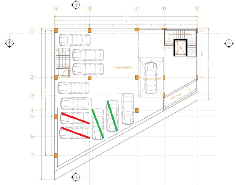

Now I have played a little with this. I started with the ideas from dik and BAretired. You will need to move the columns in B2 and B6 and you can't have both the red-marked and the green-marked cars. But I would say that the location of the lift is not good. If you could move the lift, and the septic tank, that would open up the space.
The layout is not ideal but I think it shows some of the problems you have.
Appreciate your reply. In your attached image, you removed B6. If B6 isn't there, the slab will be supported by A2, A5, A7, C2, C4. Isn't it a Big slab?

In my figure column B6 is hidden by the lower red car. It's fairly close to a wall so it might work without it. But if you choose to have the red cars you can probably move them further down and add a column at B5. If you go with the green cars and skip the red this won't be an issue.

The whole area between lines D and E is useless in terms of parking. I suggest moving the septic tank down beneath the building and moving the lift up towards line 1. That would open things up. I think you have shot that idea down due to constraints. But I agree with BAretired, if you insist on meeting all the constraints you won't get usable parking to the extent you want it.

Column B6 can't move down or it will be outside the building on Ground Floor. Columns on sloping Gridline 8 have to stay on Gridline 8.
Car 6 blocks cars 1, 2 and 3. Car 6 cannot turn around easily. Even with car 6 gone, car 1 has difficulty getting out because he can't back into the wall.
Cars 4 and 5 project too far into the drive lane, making too tight a turning radius for incoming car X.
Cars 7 and 8 can't reach their stalls if the car lift requires firewalls on three sides (similar to the Elevator).
Stair 1 has more risers than Stair 2. The extra risers are not needed in the parking floors, but may be required in the Ground Floor.

I am also wondering about the concept of 20% "open" areas. I interpret that to mean that the areas shown crossed in the Typical and First Floor Plans have no slab. I understand this is a local municipality requirement. I question whether this is even possible, let alone desirable. But perhaps I am misinterpreting the local regulation.

You do not want an opening between the parkade and the structure above.

How can you avoid it? The hydraulic car lift, the elevator and two stairs each create an opening between parkade and Ground Floor. Fire regulations require an approved separation in each case.
