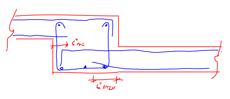

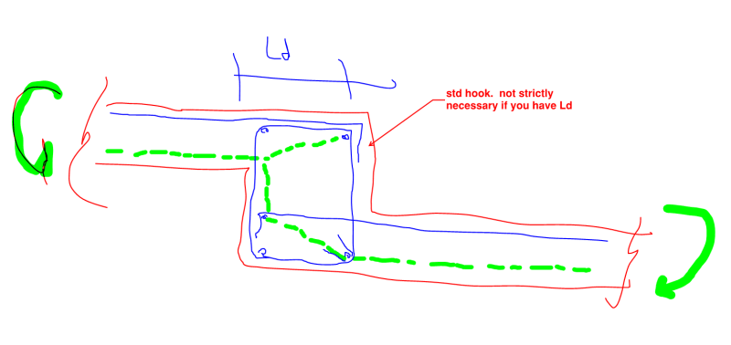

Suppose we have a slab with an offset that at the same time acts as a supporting beam (happens a lot in projects where there is an underground garage for example). In the static analysis the slab is assumed to be continuous. The beam acts as a support therefore the moments in the slab will be negative requiring top reinforcement.
The question: Is it enough to anchor the top reinforcement inside the width of the beam? Or is it necessary to overlap the required reinforcement with the beam stirrups in order to provide continuity of the moment resistance between the top and bottom slabs?
By my estimate, this has to do with the width of the beam (b in the sketch). In sufficiently wide beams (how would that be defined though?) the beam can be assumed as fully rigid and therefore I would expect a mere anchorage of the slab reinforcement to suffice. If the beam is not wide enough (perhaps close to the depth of the slabs) then I would expect a need for overlapping the required reinforcement of the slabs with the beam stirrups so the moment can be fully transferred.
Below I have two sketches: One is the described situation - slab offset as a supporting beam and the second is a typical slab offset with the proposed reinforcement for moment continuity.
I would definitely go for the top option (assuming that the straight laps are sufficient for the required development - probably need hooks in reality)

I use a standard stirrup with a 4-bar cage running into the page, then return my top and bottom steel in both the upper and lower slabs into the cage with hooks

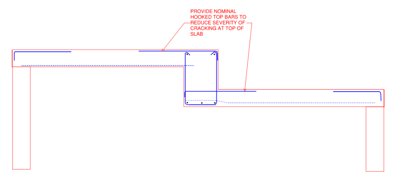

If you don't want the moment to be continuous across the beam, you can add a slab line release at the beam face (I assume you're using an FEA software similar to CSI's SAFE).
In this situation you'd typically provide nominal top bars with standard hooks to reduce cracking at the top of the beam but otherwise assume that there is no significant negative moment at the beam faces.
The additional benefit here is not having to design the beam for torsion (i.e. open stirrups)
If you want to design for a moment, the top and bottom reinforcement should be bent through the fold in such a way that forces can be transferred across the joint & development length requirements are satisfied. I typically see them detailed like in my attached sketch. This is typically cumbersome to provide when beam stirrups & reinforcement are in place.

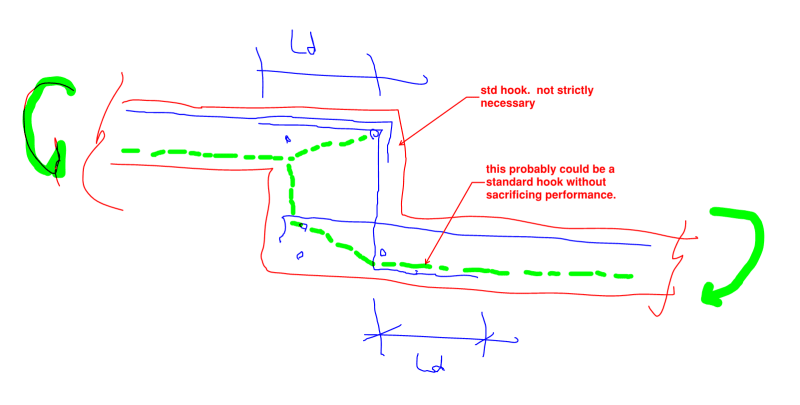

I will add two details, the first one uses hooks for the slab top reinforcement (say ∅12/10cm), while the beam stirrup is something less (say ∅10/15cm). The second one uses a closed stirrup that also acts as slab top reinforcement and the bottom part uses a hook - in both cases covering the full requirement (∅12/10cm).
If this is a suspended beam then I don't see how you can avoid enploying this detailing. Reality doesn't care about simplified model assumptions and pin detailing in a concrete beam is a dubious option at best
I prefer Z bars in couples, height of both full depth, extending horizontally to far face in each case. Do not turn any bars around an internal corner.
I would think that in your first option, the top bars (red) of upper slab would be hooked down into the beam unless it was perhaps really wide to develop by the beam-slab joint. Similar but mirrored detailing for the bottom bars (green).

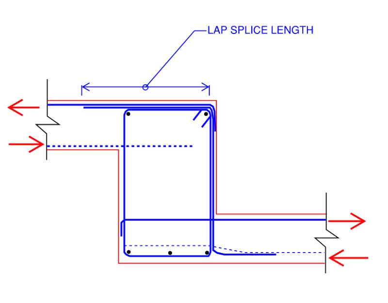

In this situation in my market (North America) I would consider the detailing shown below to be conventional, economical, and structurally adequate. You know, the "big three".
Koot, in your stirrup you have no horizontal leg on the stirrup
Isn't this required to complete the strut and tie for a torsional concrete beam? Is the theory that the hooked bar at the top provides this?
If so, isn't that of pretty marginal benefit compared to just completing the stirrup cage?

Ostensibly, the beam has no torsion. It's rectified by the rotational restraint provided by the adjacent slabs. Obviously, unless the moments are balanced on either side of the beam, there will be some torsion. It will, however, be self limiting.
I do see it as doing that job in a somewhat non-rigorous and non-explicit fashion.
It is marginal but, then, in the world of business, the margins are precisely where profits are earned. Moreover, my drawings will get compared to my local competitors who will avail their clients of these marginal benefits.

For sport, this is what I prefer for a continuity step. I believe that it is consistent with Hokie66's comment. Note that I've deliberately only shown the hogging moment rebar for clarity. Normally, folks detail it for both hogging moments and sagging moments concurrently. In that case, you wind up with another z-bar.
I don't consider this the most theoretically correct detail but, rather, the "market appropriate' detail which many would term "practical".

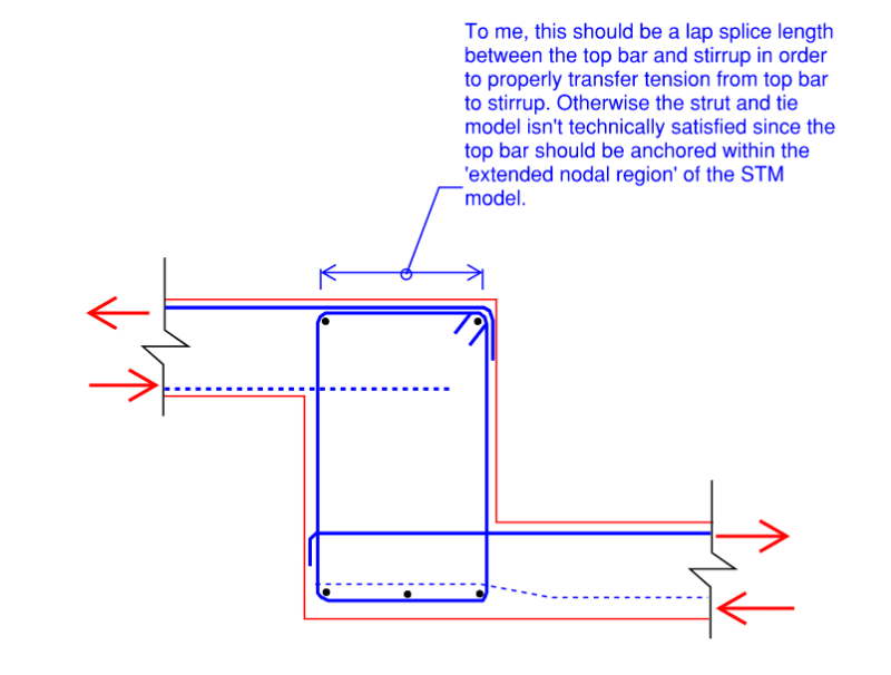

This is what I would consider the Cadillac version of the continuity detail, including closed stirrups. As can be seen, it's not so different from the previous version in the ways that matter.

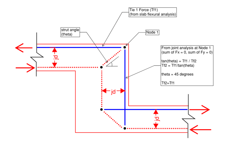

Does it make sense to treat the step as flexural member to find the tensile force acting on the vertical leg (where depth = beam width) or is this force equal to the tension coming from the slabs?
Typically, the vertical leg will be sized to match the top bars (note that if this is for a beam seeing shear in-and-out of the page that you should be providing additional stirrups for this moment transfer mechanism in order to not over-utilize the stirrups designed for beam shear).
It does not 'strictly' make sense to think of this as a flexural member since this would be considered a discontinuous "D-Region" that should be analyzed via strut and tie methodology.
That said... the construction of the strut and tie model ends up being simplified by assuming that your vertical strut and tie likely only need to be as far apart as the horizontal struts and ties because using 45 degree struts resolved in equal horizontal and vertical tie forces, see below snapshot:
Edit: You could reduce the demand on the vertical leg by making the strut and tie model wider through the beam however if you're the vertical bar with top bar you'll want those sizes to match.

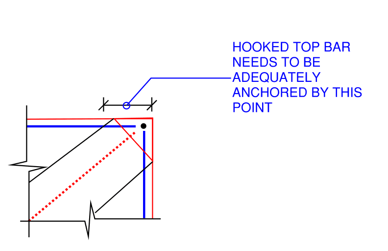

My only qualm with Kootk's "Cadillac" version of the detail is that to me the hooked bar at the top may not strictly be anchored to Node 1...
If you can't achieve that lap splice between top bar and stirrup I would tend to prefer the Z-bar detail lap-spliced with the top bar.

Does it make sense to treat the step as flexural member to find the tensile force acting on the vertical leg (where depth = beam width) or is this force equal to the tension coming from the slabs.
I would say that the tensile force would be somewhere between those extremes:
1) Reducing this tension force from the slab flexural values is one of the main reasons that we proportion the step as we do (w = 2h etc).
2) As dijon intimated, this will be a disturbed region so the flexural depth (width) will be less than the full width less a compression block. I usually take the lever arm at 0.7 x width for this purpose, paying homage to the park and paulay reduced lever arm method of deep beam design from the 70's.
3) The vertical stirrup legs will also need to transfer vertical shear from the low side to the top of the beam. This will create a continuous "hanger" situation that will add a bit to the stirrup demand relative to that predicted by straight beam shear concerns alone.
