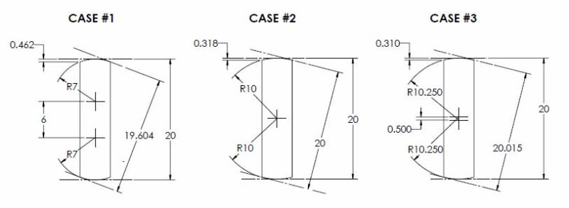

The image shows 2 cases comparable with Case #2 and Case #3 in the figure by chez311. The same issues that were associated with non-opposed geometry occur for features designed to be "well behaved" opposed feature of size. Left sides shows a feature produced with slightly convex faces, and 2 possible candidate UAMEs at different orientations. This is the "well behaved" equivalent to Case #3. Right side shows a feature with the faces produced slightly non-parallel. This is the "well behaved" equivalent to case #2.

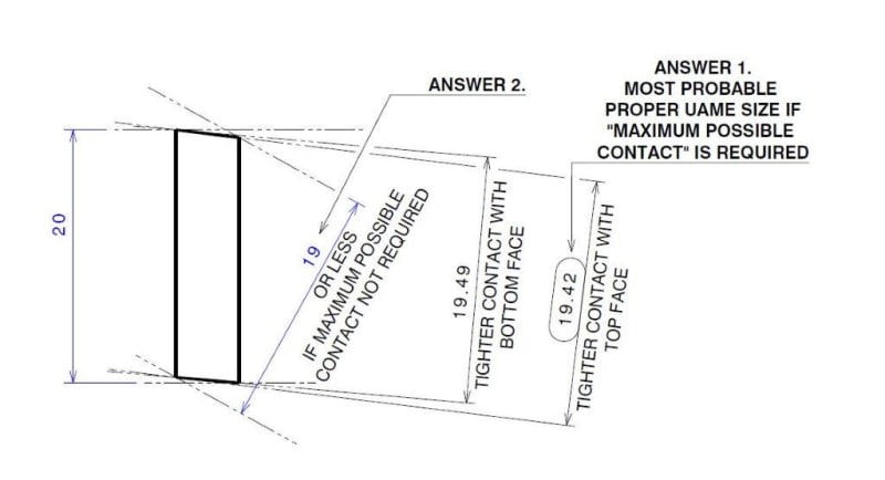

The following figure should answer your questions:
Sem_D220,
1. Ok. I simply wanted to make sure that you did not consider the 19.49 envelope good candidate for UAME.
2. I personally do not think that the '19 or less' envelope is good candidate for UAME too. It is basically because the as-produced 20 feature is not fully constrained/immobilized relative to that envelope. To achieve full immobilization, the envelope would have to contact the feature in at least 3 points in the shown view (2 on one face and 1 on second face). For the proposed as-produced geometry, it is the 19.42 and the 19.49 envelopes that satisfy this condition, but because the 19.42 envelope is smaller of the two, it is the correct UAME of the feature.
This is how I understand maximum possible contact with the corresponding surfaces of a planar (two-parallel-planes) feature of size.
pmarc,
Just to clarify in case someone may misunderstand, the number 19 ("or less") was randomly chosen to be shown as an example. If we go purely by the UAME definition as was advocated by numerous responses in this thread then "maximum contact" is not part of the considerations and therefore any value below 19.49 19.42 and above the width of the feature (for example - 5) would be a legitimate candidate too, and could be chosen as an example for the answer on your question: "is further contraction of the 19.42 envelope possible?"
Per my understanding, not even the 3 point contact you described would save the situation, because technically all three points of contact can be located on the edges intersecting the top/bottom faces and the 2 left/right surfaces. For example - 2 points on the edge between top & right and one point on the edge between bottom & left, for the 19 UAME shown. I agree that this kind of contact would not immobilize the feature relative to the envelope, as you say. The same is true for the <52 envelope in illustration C for the unopposed feature which you posted above. Both envelopes are equally appropriate or inappropriate.
For immobilizing the feature, the unrelated actual mating envelope has to do more than just contracting to the smallest size about the external feature until further contraction is impossible. It has to be sufficiently adjacent to the feature as well. Whether the faces the feature consists of are opposed or non-opposed doesn't seem to matter in this context.

In regards to your two features, for the second one I agree with pmarc that the correct UAME is unambiguously 19.42 - your alternative "19 or less" is not valid. If you consider contraction of the boundary as it progresses towards its minimum separation, 19.42 is the only solution - to achieve a smaller boundary (your "19 or less") it is no longer only contracting but also rotating arbitrarily away from the surfaces being simulated.* Conversely this would also happen if you were starting contraction with the part at an excessive angle such that it closed down on the longer 2x faces instead of the shorter 2x faces in question.
In regards to your first figure, I was intrigued as to why I did not see that on my initial, admittedly quick, look at the geometry. It looks like with features of a high length to width ratio as you have shown, with relatively loose tolerances (not unreasonably so - but definitely not very tight) on the size/form an unstable situation could arise. If I have some time I might come up with a formula to show the relationship, but in the meantime the below figure shows that in order to create the situation you showed it requires the center of the arcs which make up the barrel shape to be at some separation from each other, which also requires a relatively small radius on each side resulting in a relatively large size/form deviation. If these arcs are changed so that their centers are coincident then the feature essentially now becomes round and there is no minimum as the separation becomes the diameter and is the same at every point. If these arc centers cross the centerline then there is now a minimum at the apex of each arc and the feature now becomes "well behaved" - as the size/form tolerance gets tighter this would only become more true. I don't know how often one might encounter this as it requires a specific set of conditions, and I do not know exactly how this would be handled in regards to establishing a UAME - however I do not think it is perfectly analogous to your OP example as they are not "unstable" in the same sense - ie: I think you would find that if you contracted a physical boundary about my case #2 below I think you would find it relatively stable, despite having no minimum. The same could not be said for your OP with offset planar features.
Note the difference in the size/form deviation of each feature (.462 / .318 / .310 respectively). As I stated if this is minimized by a tighter tolerance, this instability and lack of defined singular minimum disappears.
*I know I stated in my reply (15 Mar 19 18:19) that theoretically these boundaries would coexist with the surface and maybe downplayed the physical realities, based on pmarc's replies and thinking about it some more I think I was on the right track initially by focusing on the physical realities of simulation.
**Edit - made the figure more readable, I realize that the dimensions may have been hard to read.

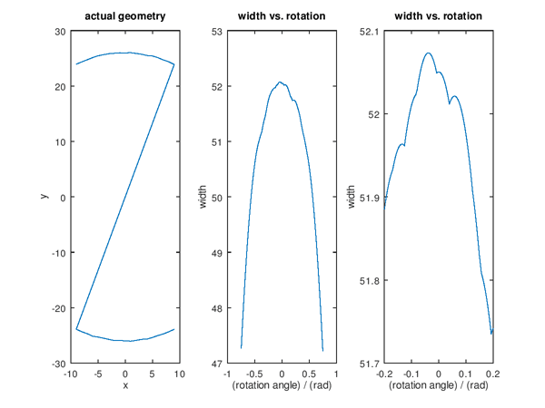

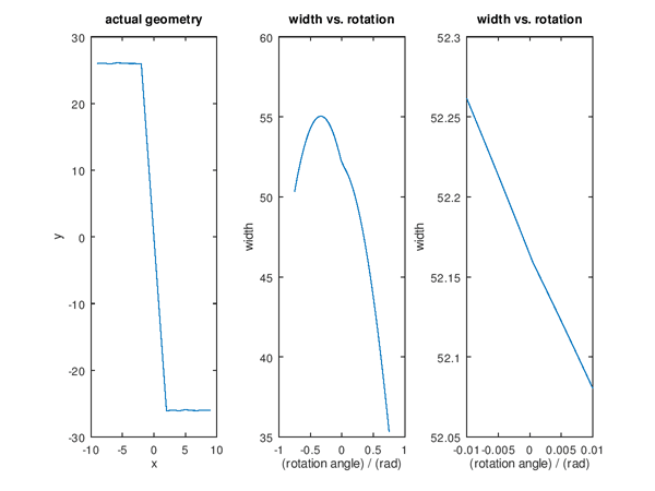

I have created some illustrations showing attempted UAME determination (in 2D) for an external feature nominally consisting of parallel lines 52 units apart:
Image 1 is modeled on the image in the original post, and shows non-opposed surfaces with some waviness but relatively small form error. The plot of envelope width vs. rotation has no local minima (or at least none for alignments anywhere near reasonable), so I conclude that a UAME does not exist for this feature.
Image 2 shows fully opposed surfaces with some waviness but relatively small form error. The plot of envelope width vs. rotation has a single clear valley in which to seek the minimum value, and this minimum value defines the UAME. The depth of the valley and the slope of its walls indicates that the feature is reasonably-well immobilized relative to the envelope.
Image 3 is modeled on the left illustration in the image posted 17 Mar 19 06:07, and shows fully opposed surfaces with relatively large convex form error in addition to some waviness. The plot of envelope width vs. rotation does have local minima, but they are not very prominent. There is no single clear valley in which to seek a minimum value. I conclude that a well-defined UAME does not exist for this feature.
Thoughts?

pylfrm said:
This indicates that further contraction is not possible without first expanding and rotating the envelope.

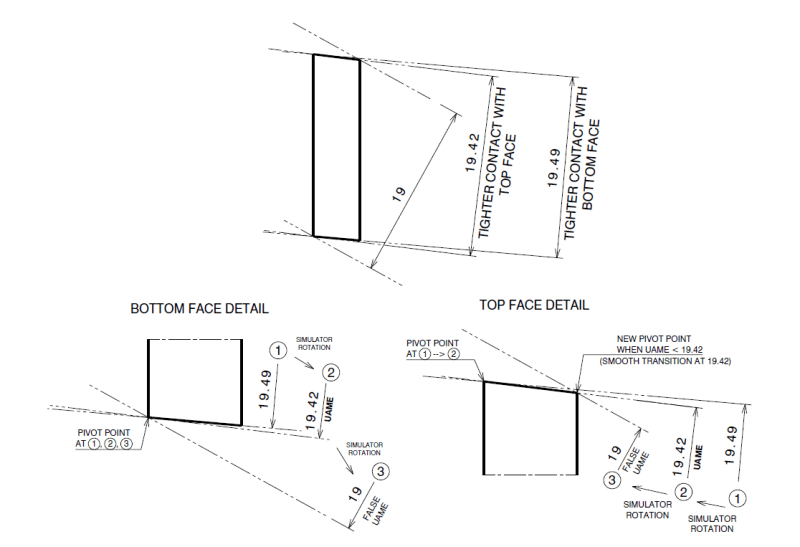

The simulation I performed tells otherwise. I will later try to make clearer figures with enlarged details of the contact zones showing the contraction of the simulator step by step.
The plots you provided look very interesting, but I can't truly relate to them without some visualization of how the movement looked like.
Regardless, image 3 supports the point that the opposed geometry of noncontroversial features of size, doesn't guarantee an unambiguous UAME.
I hope this illustration will help to visualize how the UAME simulator for a regular opposed as produced FOS might fail if the contraction is not stopped deliberately when maximum contact is achieved. Notice that the UAME envelope will not have to expand and then contracted again at any step to behave as shown. As explained, the contraction is continuous and the rotation occurs as result of the forces applied during the tightening of the simulator about the feature, the simulator simply rotates in the direction which allows it to keep contracting all the way through the process.
As noted previously, the value of 19 is presented as an example. Any envelope size below 19.42 represents a failure to detect the correct UAME size as a result of relying on the physical behavior during contraction about the feature only and trusting on the feature itself to constrain the envelope.
