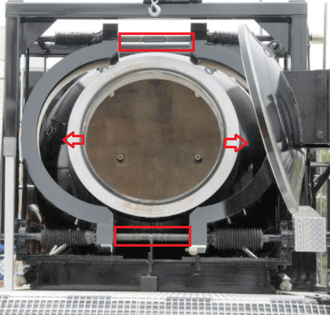

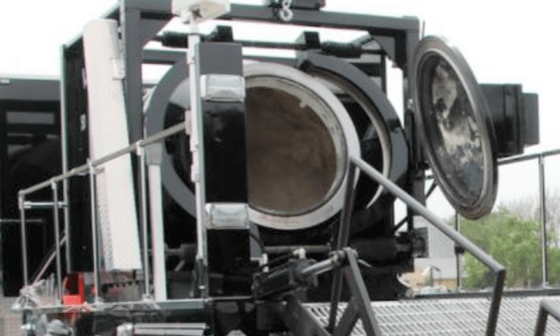

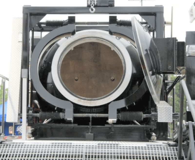

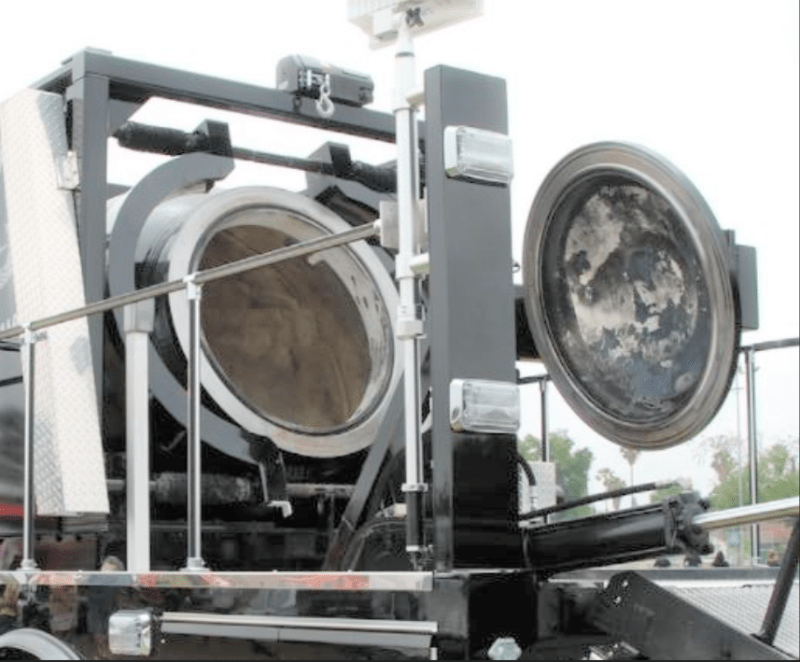

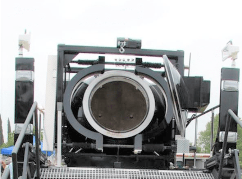

As others have mentioned, I too would only want to use a rotating breach lock type door, or at least a door that is mounted inside sphere. The LAPD design optimized robotic and remote loading.

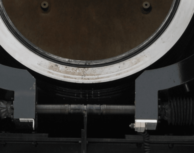

Some pictures for review.
I think this is the weakest link if the hatch for som reason isn't properly seal tight and pressure pushes the looking halves apart that threaded rod isn't going to cut it.

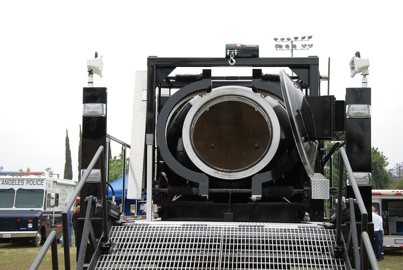

It loos like the LA one is a NABCO 64-GT-SCS.
Dose not say anything about how you trigger a explosion inside the NABCO.
The Sweidish Dynasafe you can buy a add on heating system capable of raising the temperature of the loading tray to approximately 662°F, causing explosives to burn or detonate.

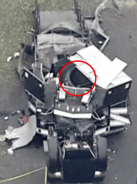

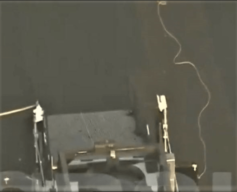

Well lots of speculation going on here, so I'll add my own:
The LAPD vessel was a proven design, but obviously, something went amiss.
At least from tugboats pictures I think it looks lik, the hatch was blow open and as you sade the explosion was quit "uniform" symmetric in the beginning.
And the blast compartment "bowl" was pushed forward as a bullet then twisted, in some video you can see that the blast fire changes to left looking from the front at the end of the explosion.
I think it is the hatch opening you see here from tugs picture.

That would be very unlikely unless the unit was used often for years, with no lubrication nor maintenance.

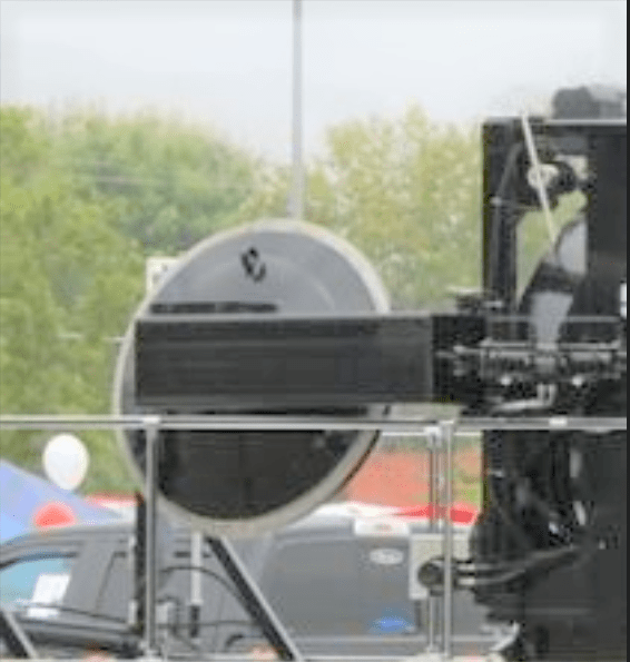

The truck is super clean in that picture but the topp and bottom off the hatch frame isn't.
There are also rubber sealings, they are to prevent gas leakage.
But it looks like there has been leakages from earlier explosions.

That could just be poor clean-up after the last use.

I don't think the seal is particularly important in this design. Dik's post alludes to the lid being found in tact some distance away so this is looking like a failure of the clamping system that retains the lid.
