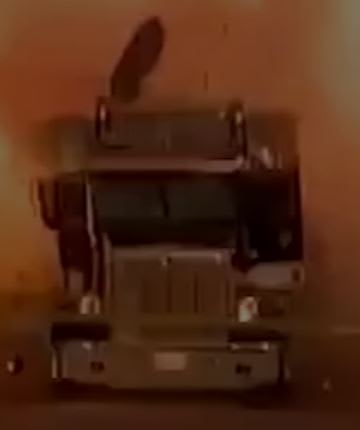

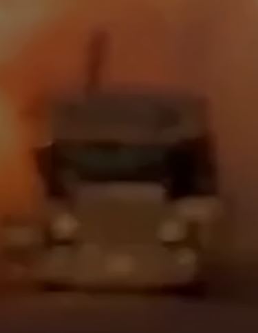

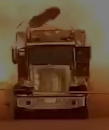

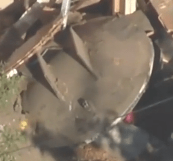

Not knowing anything about it... that would be my kind of guess... I had no idea the 'projectile' could travel like that...

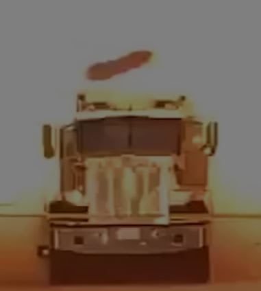

Frisbee you know. ;-)
Or maybe it's really a flying saucer.

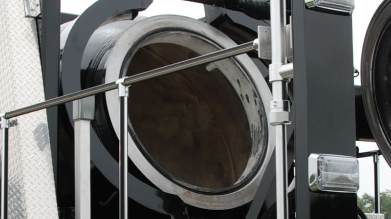

That clamp type design might look big and strong, but I think it is rather weedy and open to stress concentration, over tightening and you start at a high level of stress in the clamp to clamp it tight then go and add a load more.
We have no idea at the moment how many times that chamber was used?
But shock loading needs a FOS of at least 3 IMHO. There is no way that chamber closure is strong enough for that.
At the root cause, a clamp design is a poor choice of closure mechanism for such a shock loading condition.

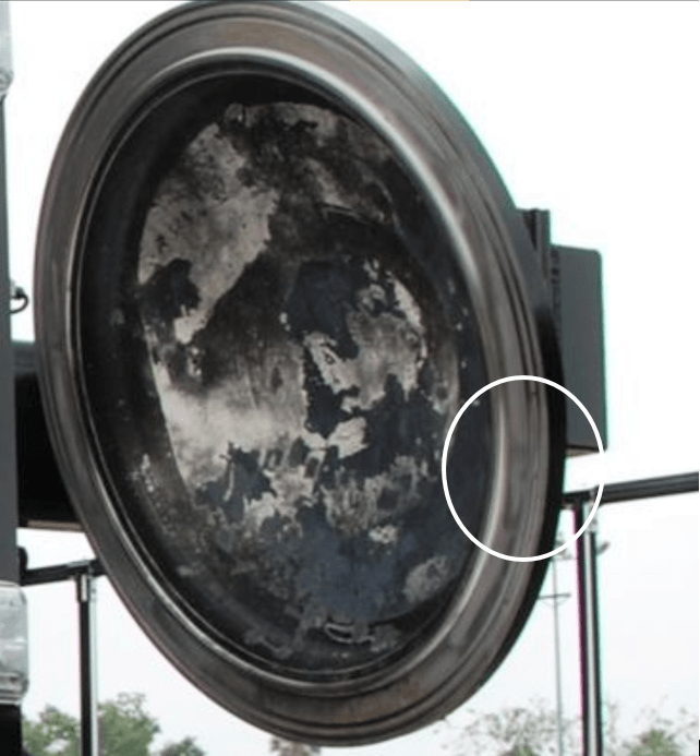

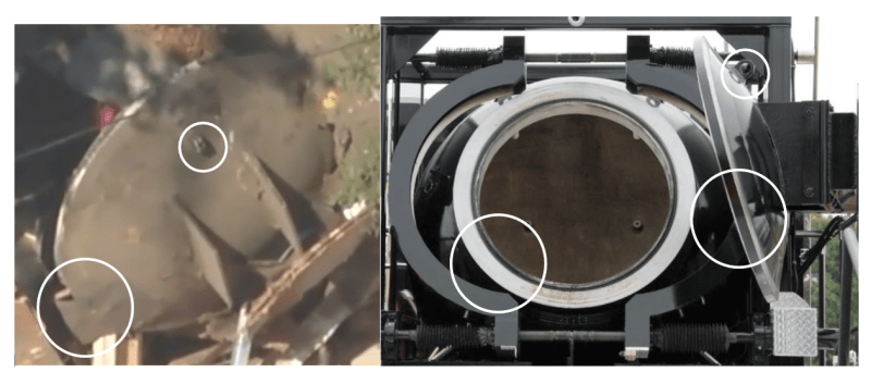

The photos of the truck from the fair are 12 years old. We have no idea of actual vessel history, but at hundreds of thousands dollars each, they are not disposable. LAPD released statements that they did not overload vessel. But they quoted onetime rating, not accumulative... This vessel would require impeccable record keeping...
On the stained flange at 6 and 12 o'clock, you can observe two clean rings in the stain. This indicates perhaps the hatch is rotating against the flange during detonation. (Note I do not mean the hatch is spinning against flange, think Challenger solid rocket case rotation of joint.) Or perhaps the rings are from vibration when the whole thing rings like a bell? Note they occur where the clamp is discontinuous.
The black material on the I.D. of the flange opening looks a little stained as well. Refer to high resolution flickr photo.

I wounder what the remains of the clamp look like.
I agree the location where the clamp halfs join is a location where strain (and possibly bending) could be important.

Another problematic design feature I see is that the mechanism that supports and operates the clamps is not actually attached to the vessel but to the frame instead. Any movement of the vessel would add additional stress to the clamps.

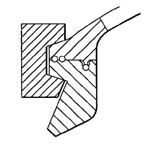

See Figure 4 in patent PDF above. Clear areas in stained flange are simply the result of O-Ring seal.
