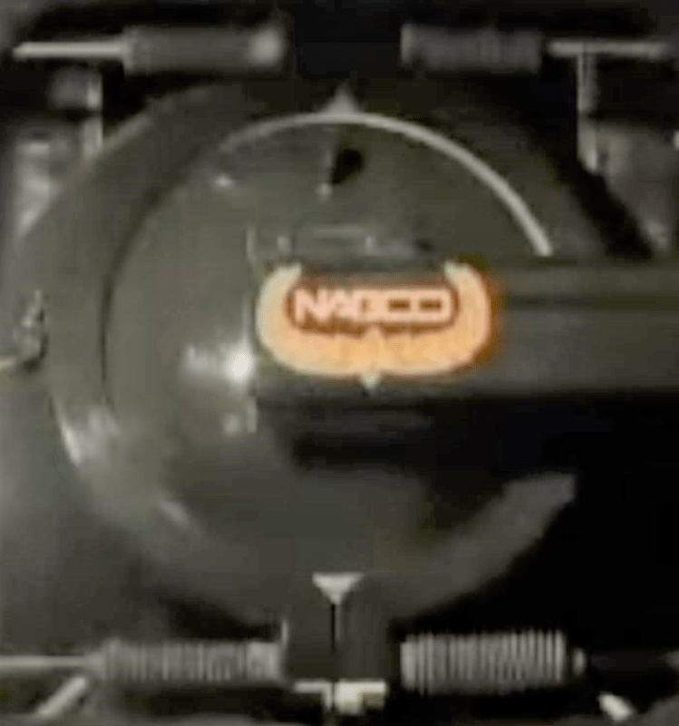

From the patent:
3-lbs TNT—totally sealed system, repeatable detonations. The UTCV 10 will require decontamination and maintenance, but no repairs.
15-lbs TNT—repeatable detonations with venting. Minor repairs may be required which include mechanical components, ports 68, and flanges (at the yoke 16, door 14, and body 12).
Can't find any discussion of the venting arrangement.
Perhaps the vessel was inadvertently not vented for this detonation?

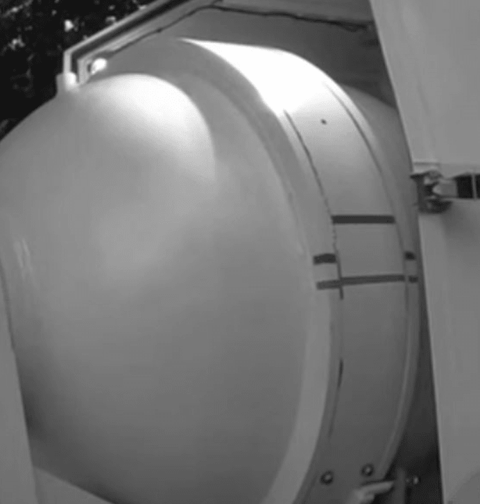

Well in that video LAPD using this truck from 2015 if you look at the pictures at the end when the looking halves are closed between 12 and 3 a clock the looking halves are not fully closed you can still see quite a lot of the flange.
And there is also smoke where it comes from, not sure.
Since the looking device is attached as tug sade to the fram and this bowl is supposed to be removed for emptying and cleaning.
What secures it in it's right place?
If it isn't properly centered the looking will not go inte to place properly or enough.

I think an important point of consideration is the dual modes of operation, vented and unvented. If LAPD detonated 10lbs of explosives thinking they were in the vented mode that could certainly have caused the failure.

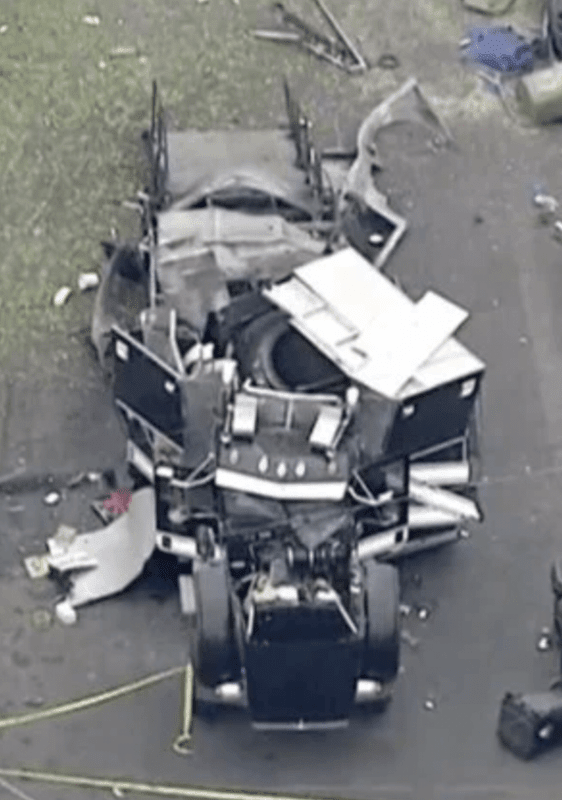

Welp, looks like it was just good old incompetence.
Investigators estimate 42 lbs of explosives were loaded. Officers thought they had loaded 16.5 lbs. The chamber has a 15 lb reusable rating and a 1 shot 25lb rating. Odd that the officers thought 16.5 was still acceptable as I would think that would still require condemning the chamber.

So the crew had to perform (or chose to perform) a triple estimate: the weight of the objects' explosive content as flash powder from a guess at the overall weight, and then estimate the conversion of that to TNT equivalent for the 15lb rating. A systematic error in the first two (0.5 oz to 1.37 oz * 280 devices) and the thing is doomed anyway but assumptions of explosive efficiency of homemade firework vs powder and then TNT added further uncertainty. Any errors * 280 is the problem. 16.5 regular lbs being 15 LAPD lbs is a headscratcher all on its own.
I'm not sure that adding a Captain to the process helps: brass just makes more shrapnel.
I think the officers were so poorly trained or so ignorant that they did not understand that 15 lbs was the MAX reusable load and that 15.1 to 25 lbs condemns the shell. I really hope they didn't think that it was any use over 25 lbs that condemned the shell. The worst part is that out of the number involved, not one raised a red flag. 5 officers are suspended.
The bomb technicians — without using a scale, as is allowed by Los Angeles police procedures to avoid additional handling of the unstable devices — estimated the weight of the homemade explosives and a counter-charge to be about 16.5 pounds (7.5 kilograms) in a standard flash powder measurement. That measurement is not the same as an item's physical weight and is instead calculated as a TNT equivalent because explosives have different concentrations and therefore have varying “explosive weights."
They arrived at 16.5 pounds by estimating that the smaller explosives — there were 280 of them — each weighed about a half an ounce (14 grams) in that standard measurement. The bomb technicians estimated that the 44 larger explosives — which were about the size of a soda can with a fuse — had about 1.5 ounces (42.5 grams) worth of flash powder.
Federal authorities who weighed the remains after the blast calculated that the weight was actually more than 42 pounds (19 kilograms) in the standard measurement. The smaller explosives were actually 1.37 ounces (38.9 grams) and the larger ones were about 5 ounces (142 grams).
The detonation chamber's maximum capacity is 15 pounds (6.8 kilograms) for multiple uses or 25 pounds (11 kilograms) for a single use, Moore said. The LAPD has not publicly identified the manufacturer of the detonation chamber, despite repeated requests.
