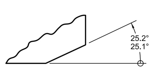

Also,
Is that tolerance "within 0.05°"?

That range is between 25.2° and 25.1°, inclusive. Values can be within that range and the range can be stated as 0.1°, but it is incorrect to say "within" to describe the half-extent of that range.
One could say the acceptable slope will be within 0.05° of 25.15°.

"means the same" in this context makes no sense. Does 25.2°/25.1° mean the same as +25.2° and -25.1°?
The tolerance for the OP is the allowable deviation to either side from the nominal.
"Does 25.2°/25.1° mean the same as +25.2° and -25.1°?"
This question makes no sense. Why would it mean that?
The mean value is 25.15°.
So, 25.2°/25.1° or the equivalent 25.15°+/-0.05° can be described as "within 0.1°".
By the same token the OP's "within 0.5°" can refer to the full range of the tolerance; for 180°+/-0.25° it is "within 0.5°".
