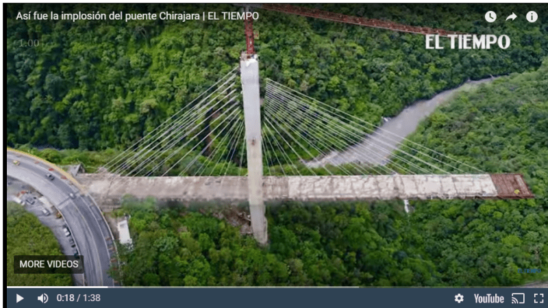

There's a roadway right next to the pylon. I think the bridge was intended to be a bypass for the road, which is still active. They stopped the traffic during the demo. Screencap from the video:
TTFN (ta ta for now)
IRstuff - the road is not in the fall zone, but it is where artillery might hit, hence concern about missing. As a practical solution, just walk in dummy rounds of matching weight to avoid unexpected damage then send the explosive ones.
I am not sure it's even possible for the bridge to be forced to hit the road - to be tall enough the cables on the road side would have to be steeper than 45 degrees and they don't appear to be. Even to start would require simultaneously severing many cables on the valley side; pretty unlikely. Even the original failure didn't require simultaneous rupture; the rapid progressive failure was enough to drop the bridge nearly straight down and it doesn't look like the explosives did any better in minimizing the debris field.
