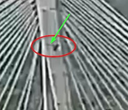

An expert says that the images, revealed by the CM & newscast, would indicate problems in the construction or design.
The Noticiero CM & revealed a video recorded by a security camera where the Chirajara bridge collapsed. In the circle it is observed how the bases of the structure yield.
Argelino Duran, President of the Colombian Society of Engineers, says that the video would reveal problems in the construction or in the design or in those two variables.
"The support column of the bridge that in that area where the road goes opens in two in a geometry as a diamond begins to move and begin to break the vertices of that rhombus and the diamond, which was elongated, ends up trying to become like square as it falls. Those columns that were part of the diamond did not support the effort that at that time they had to endure, "said Durán.
The engineer Duran, warned that it is necessary to thoroughly review the part of the viaduct that remained standing and does not rule out that it must be demolished.
