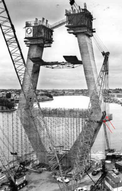

I did a bunch of 'construction' engineering for this bridge back in the early 1990's:
I worked for a consulting engineering company who was engaged by the contractor to provide engineering to numerous aspects of the bridge construction - from delta tower jump forms, approach spans, staged construction analysis etc. The element that tied the sloping legs of the delta-towers (directly below the superstructure deck) was a significantly sized post-pensioned element, with a bunch of PT tendons. The photo below shows the stressing recesses where many PT tendon anchorages were accommodated and later concrete-patched.
Delta-towers are very common for cable-stayed bridges. It would be interesting to see the engineering drawings of the tower for this Columbia bridge.
Spartan 5 - If you look at the linked photos in epoxybots post of 24 Jan 1735 you'll clearly see the tie struts to the blue tower crane.
The idea or a post tensioned element clearly makes sense and makes you wonder why the web was being constructed in the first place. Most other towers like this don't seem to have it? Was it being used instead of a tensioned element at the bridge deck level?
Interesting picture from 3Ddave if you look at the bottom of the concrete. The square base appears to be sitting on a circular shaft type foundation that is smaller than the base?

Sure it can. 'Precompress' the concrete to such a magnitude that, under the applied/sustained tension, there is still a resulting net compressive action.
