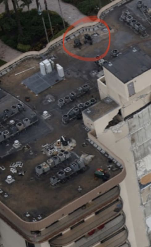

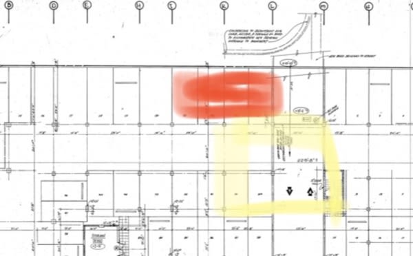

Apparently as of May 26, 2021, there was a crane on 88th (north side of building) with outriggers sitting on the garage structure carrying roofing supplies and "tar" to the roof. Maria Notkin of Apt. 302 made the initial complaint - she appears to be the same unit who called their relatives from their landline multiple times after collapse. They were asking for the crane to be moved from 88th to Collins, the association said they needed the crane on 88th to reach the entire roof. See page 40 of email communication documents uploaded by the city. Link
Reading through this I’m wondering if they could of overloaded the garage ceiling with the tar kettle. I’m having a hard time finding what the weight of a tar kettle is full. The weights I’m finding is up to 5000 lbs but I’m not clear on if that’s full. The way Maria describes the location of the kettle I’m guessing it to be on the red in the graphic. She describes the kettle being under the condo units. I’m assuming that to mean under the balcony or close to the building.
I’m guessing based on her living in a 2 bedroom 2 bath and the fact she is on the north side that her condo is located in the yellow.
I wish there was a diagram showing how it all went together. I did a bit of guessing so take this with a grain of salt.

Lizard - there were two tar kettles on the roof at the time of the collapse. They aren’t heavy. They are under the DOT limit for trailers requiring their own brakes - this includes tar kettles, air compressors, small household trailers, etc.
Those are tar buggies and are just used to transport the tar that has already been heated. The one in question is the larger type that have all the heating equipment built into them etc. I've never seen them place on the roof they are usually placed on the ground in the heated product is either piped to the roof or dumped into buggies like are shown on the roof and lifted to the roof or other place they are being used. They are much larger and heavier.
