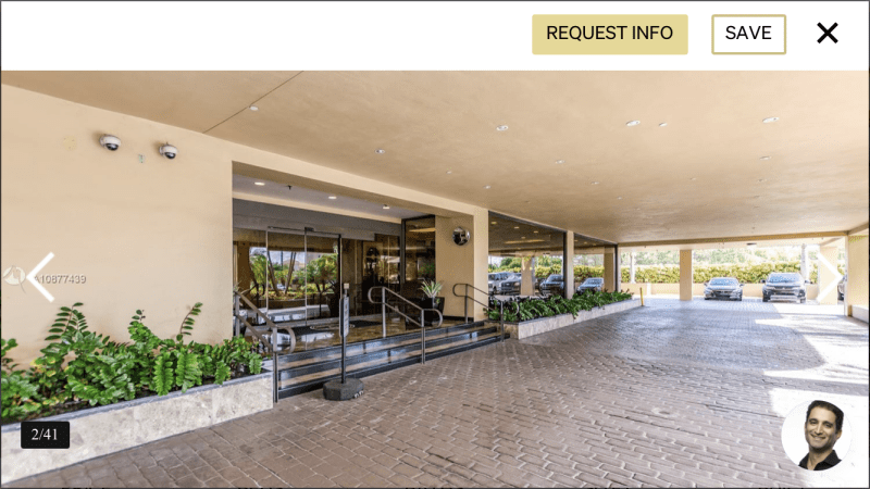

I was checking out photos of the place on
. I wasn’t sure if this was something or not. To me it look like the driveway might have a ridge. I wasn’t sure if this lined up with a beam.
The pic I have was taken last night around 10:pm ish as the building was collapsing.
They are flower pots but that's not what is in my pic. Look at it closely if you dare. I have investigators looking into it. We are skirting the realms of metaphysical engineering. I know Engineers don't like irrationality..
What KingBobo posted in his picture is in the exact same location is the "people" you are seeing. I think you may need to get a new set of glasses! ;)

The pic of the balcony looks like 2 concrete planters, one of which has a lame and crooked palm tree
