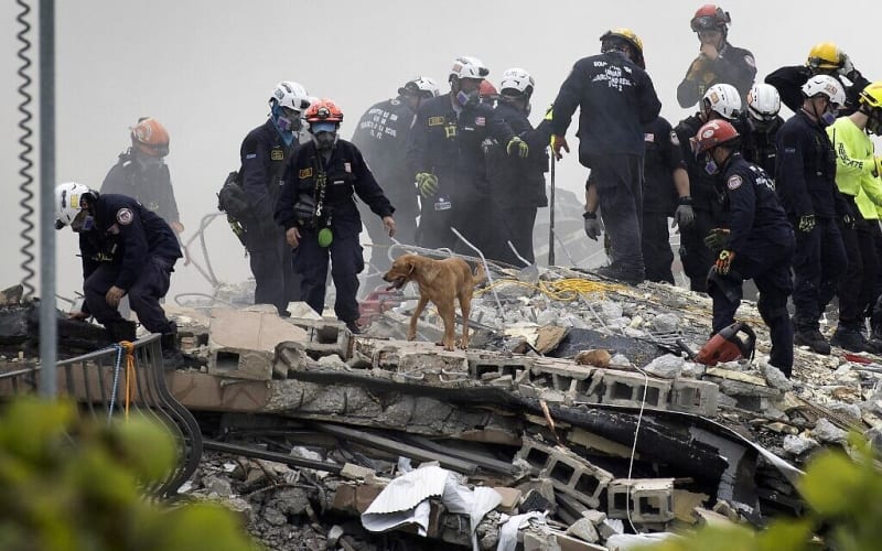

Thermopile (Aerospace) said:
My theory is that the roof column anchor that was designed to go at the top edge of that diagonal tear was load tested that day and weakened the stair sheer wall, which fell later than night/early morning. Thus this might be the trigger that started it all.
I think the bolts that hold the anchor are tested with a device that applies the load to a very small area before the anchor itself is installed. See this post above: Ingenuity (Structural) 2 Jul 21 19:42 It's very unlikely this sort of test could have done enough damage to result in a large section of the wall falling spontaneously hours later. The bolt itself would come out because of adhesive failure, or a small section or concrete around the bolt/epoxy would have come out, both immediately obvious and of limited consequence.
Questions:
Do we know what the anchor for that location looks like? It doesn't seem like it would be the same as the post anchors.
Why are the post anchoes so tall? If the load on the anchor is usually in the horizontal direction, the height provides more unnecessary leverage and load on the anchor bolts on the opposite side.
As a recreational climber, I'm very interested in tie-in points. I think I'd be more likely to put my rope around the base of the anchor post than use the ring.
Js5180 said:
Notice in the demolition video, looking south - the parapet over the x04 living room came free completely and yet remained intact. As if it wasn’t attached at all.
I believe this photo shows a parapet laying on edge on top of the cantilevered portion of the roof. The canine rescuer is standing on one of the tie columns, which provide the only attachment for the parapet. Drawings indicate the tie columns are spaced at 20 ft. It looks like the edge of the roof slab popped off when the tie columns rotated and the dowels pried out. Not implying this was a collapse instigator, just good photo evidence of that particular structural connection.
Testing of anchor bolts during assembly is a prudent measure, I always specify that with glue anchors (critical anchors get 100% pull testing, non critical anchors can get skip lot testing).
However in the case of window washing anchors, it appears that anchor bolt testing may not satisfy the OSHA testing requirements. I completely agree with the discussion above that placing a 2500 lb load between two anchor stands could create a loading condition on the roof that is outside of the loads considered for design.

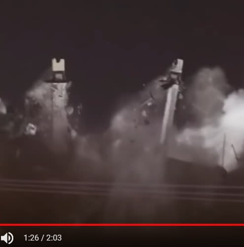

I have chosen to view the controlled demolition as an experiment on the structure (yes, evidence was lost).
Watch the Surfside demolition from four different angles
Surfside condo building: before, during and after the demolition
These contain some slow motion and close-up views including the columns punching through the roof.
The British Sun still has the live feed they started for the demo up on YouTube watch the rescue.
That, and Retiredat46's close-up of those columns once again leaves me disquieted in regards to the column-deck connections in this building. And it wasn't even just the roof deck - it appears several upper floors cleaved away cleanly from an entire row of the columns during the demolition.
If the articles stating this building's deck connections were not done to spec are accurate, then the folks in the North and East towers should insist on getting some X-Rays done on a random sampling of column-deck connections to make sure they don't have the same problem - despite both buildings appearing to be in OK shape.
