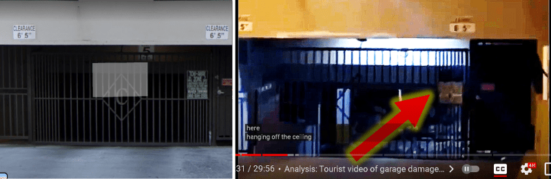

In the photos you posted of the entrance to the garage what is the square object to the upper right? A beam?? It's a sign.

I found that thread previously but I'm really not sure how knowledgeable the creator of it is. He obviously has not been on the site and by walking the video it looks like he's just trying to connect himself with name people such as CNN commentators etc. I'm not sure any of the information in that video is usable to draw conclusions from.

ChiefInspectorJ said:
Speculates that the image is the end of a broken beam.
Who is going to break it to him that what he describes as a broken beam in the tiktok video is just a TOW AWAY SIGN?
You can see the sign in the google street view.
Link
Tow away zone sign.

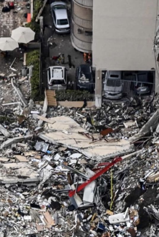

Also, isn’t that triangular hole in a CMU wall? It looks to me like the slab along that whole area has been pulled out, leaving a horizontal hole and taking a chunk of CMU wall with it over the staircase. Or is that your point? The slab was pulled out, rather than snapped like the rest of them?
Zebraso - I think that’s a staircase, from the east stair tower. Here’s a different angle, showing a prefab steel staircase nearby, and there’s a few of these scattered around in various pics but all in that general area:
The other possibility may be the fence between the upper garage and the pool deck. The black object directly behind the car’s driver side appears to be a window frame.

The Triangular shear wall missing from the stair tower adjacent to elevator shaft appears to have been damaged at upper right corner as the beginning of the tear that ran diagonal down. The lower part of triangle looks like it peeled away as it fell. My theory is that the roof column anchor that was designed to go at the top edge of that diagonal tear was load tested that day and weakened the stair sheer wall, which fell later than night/early morning. Thus this might be the trigger that started it all. The stairs in the picture just posted is of the North stairs.
