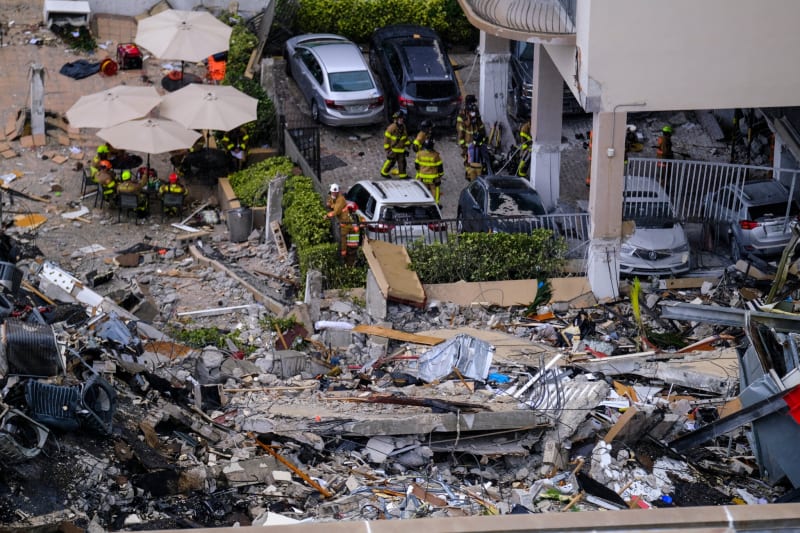

The reinforcement, I believe they were referring to was the fact that the top bars at each column was to have 25% of the bars going through the column so we should have seen at least 4-5 top bars hanging off to columns not 2-3. (Out each of the 4 sides) This of course could be because some were sheared off or some bars were placed just at the edge of the column and stayed in the slab below. Depending on the specification Tolerances this may or may not have been an acceptable construction practices…

Sure looks like a square or rectangular plate pull out at being of wall diagonal tear.
What was the original pool deck designed for? Its a slab with sand and then pavers over it. Was the pool ever rehabbed and built up where they added this layer of sand?
I posted a pic of a rehab circa early 2013 upthread.

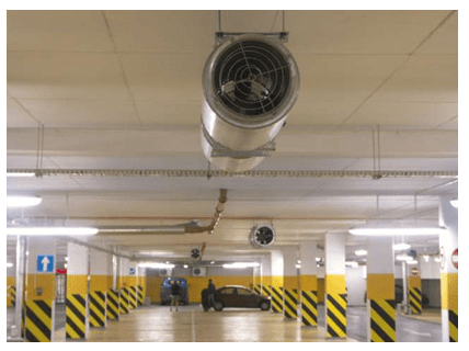

If an F350 Dualie was involved, it would be in the Tik Tok video - stuck in the outer garage opening because it wouldn’t fit in a garage with 6’5” clearance. Nor would it make any of the turns.
I’m thinking the round object is a ventilation fan, which the plans show as being in that general area.
I am not wanting to further expand the F350 Dual Axle Tik Tok, but a 1994 Ford F350 2 wheel drive has an overall height from Ford of 6 feet and 2 inches, which is less than 6'5" Entrance height limit.
