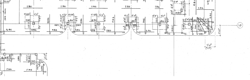

Those anchor points labeled P15, P16 and P17 are all on the cantilevered portion of the penthouse roof
P16 is on top of a column. P15 and P17 are between columns. See the column anchor on the left side of the penthouse (that anchor also could have been the failure point.)
Correction, P15 & P17 are also shown on top of columns, typically these are installed between columns, so this is odd.

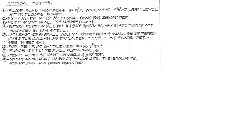

This building was 40 years old which is 14,600 days, but this collapse happened the day after a crane was loading roofing materials on the roof and the day after fall protection anchors were installed. The parapet detail Warrenslo posted has a 5'-6" cantilever, but when analyzed the moment hinge point should be center of support which is about 5'-10". The slab is only 6" thick and the reinf only #4@13" oc. Using structure dead loads plus 10 psf for roofing material and 30 psf for live load, the factored moment is 4.08 k-ft/ft and the factored capacity is only 3.99 k-ft, so assuming perfect conditions, this was a design error. Add rebar corrosion, which is likely under the hot wet roof, possible damage by the installation and testing of the epoxy bolts, and possible live load overload from roof materials or removed debris stockpiles, and it is highly possible that this cantilever slab failed first. The impact of falling concrete is the weight times the fall distance/deceleration distance. If the height is 120 feet = 1440 inches and the deceleration is 2", a 50 lbs piece of concrete imparts 50lbs x 720 = 36,000 lbs. 500 lbs = 360,000 lbs. Negating wind friction, for a 120' fall, the debris would be traveling 60 mph at impact.

the slab is only 6" thick and the reinf only #4@13" oc. Using structure dead loads plus 10 psf for roofing material and 30 psf for live load, the factored moment is 4.08 k-ft/ft and the factored capacity is only 3.99 k-ft, so assuming perfect conditions, this was a design error. Add rebar corrosion, which is likely under the hot wet roof, possible damage by the installation and testing of the epoxy bolts, and possible live load overload from roof materials or removed debris stockpiles, and it is highly possible that this cantilever slab failed first.
Minor clarification of the drawings might be needed, the steel was called out as #4@13. But the notes state that bars shown on the framing plan are top bars, in addition, unless noted otherwise. The top steel, which would be more pertinent to the bending moment for the cantilever was typically much higher is shown on the penthouse framing plan. The bars called out are top bars and would be in addition to the #4@13 call out. I think the steel for the cantilever is much a decent amount higher than #4@13
JS5180, I read on this thread page 1 I believe, that a crane had been on site the day before the collapse. The question raised in that post was where had the crane sat? I apologize if in error, but based on the fall protection plan drawings, it looks like the roof is mostly encircled with cantilever slabs. Some of these slabs have balconies below, but the balconies are not continuous.

The notes posted by Warrenslo say 8" slab floors and roof, but the parapet detail shows a 6" slab. This may be why Morabito said to verify the slab thickness. Note 6 says for reinf at cantilever #4@13". If this was additional it should say additional.
