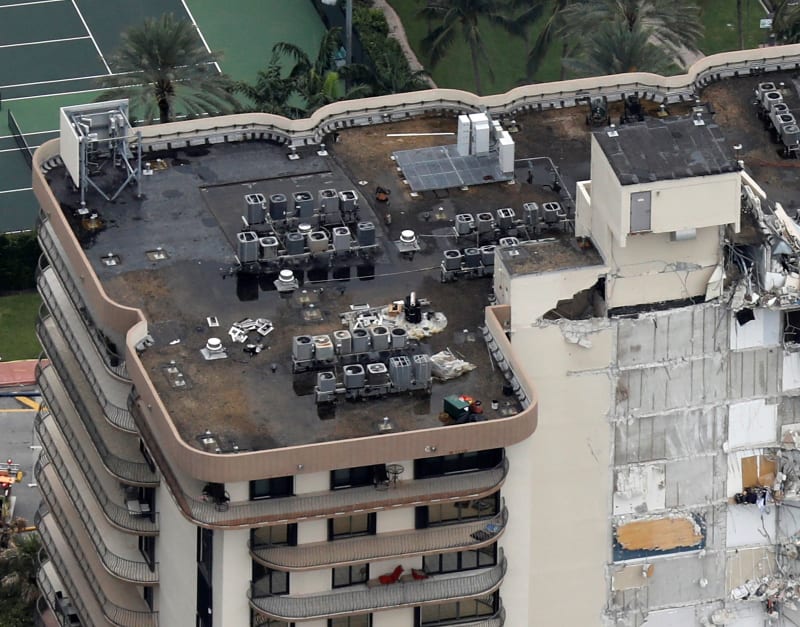

Can anyone identify:
1. The cardboard box in this picture, ending in “ECK”
2. The blue wrap
3. The approximately 4” layer of material above the slab at the far right of this picture?
(Credit Miami Herald)
These all appear to be on the roof, just outside the penthouse corridor.
2. The blue wrap
1) Looks like the Greenheck logo. Probably the box for an exhaust fan. From the photo below, the exhaust fans looks relatively shiny/new.
2) Possibly wrap from the factory for the exhaust fans.
What you also see in this picture is the roof anchors were not needed - they can access the building from the ground level with a cherry picker.
We need to reevaluate requiring them on older structures that may not be able to withstand the installation or testing requirements. This is a sort of grey area where OSHA requires the anchors and the building code generally doesn't really provide any guidance.

Also - if the cantilever collapsed and most of it landed on the 12th floor roof - that’s a drop of 10 feet or so. How likely would the building initially survive that?
Above the bedrooms of x11 only the 12th floor and penthouse had cantilevers, the remaining was the two strips of bedroom windows below. If the cantilever broke off it would have fallen into the pool deck where the column was damaged. In the surveillance footage this area seems to already be missing. I'd imagine there is more to the video they haven't shared yet unless the video was on a motion sensor and triggered when the main collapse started.
BlakeStr said:
This building was 40 years old which is 14,600 days, but this collapse happened the day after a crane was loading roofing materials on the roof and the day after fall protection anchors were installed. The parapet detail Warrenslo posted has a 5'-6" cantilever, but when analyzed the moment hinge point should be center of support which is about 5'-10". The slab is only 6" thick and the reinf only #4@13" oc. Using structure dead loads plus 10 psf for roofing material and 30 psf for live load, the factored moment is 4.08 k-ft/ft and the factored capacity is only 3.99 k-ft, so assuming perfect conditions, this was a design error. Add rebar corrosion, which is likely under the hot wet roof, possible damage by the installation and testing of the epoxy bolts, and possible live load overload from roof materials or removed debris stockpiles, and it is highly possible that this cantilever slab failed first. The impact of falling concrete is the weight times the fall distance/deceleration distance. If the height is 120 feet = 1440 inches and the deceleration is 2", a 50 lbs piece of concrete imparts 50lbs x 720 = 36,000 lbs. 500 lbs = 360,000 lbs. Negating wind friction, for a 120' fall, the debris would be traveling 60 mph at impact.
