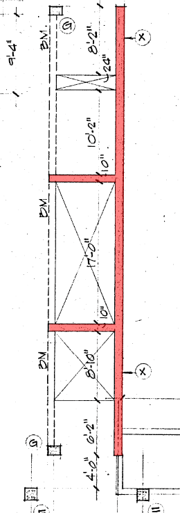

First off, this demolition is extraordinary on so many levels, but Kilsheimer's analysis is equally as dire in that the structure only has a windloaded capacity of 45mph sustained, 60 mph gust @ a safety factor of 1.
It appears that this is not going to be an implosion where the structure drops or "pancakes" in place, but is designed for lack of a better word "hinged" to fall (slide) forward (To the west on top of Collins St) basically intact
From an structural standpoint, it will be interesting to see how the sheer walls that constitute the cores(stairwells, elevator shafts) fall, or don't fall.
With such little shear walls in the E-W direction:

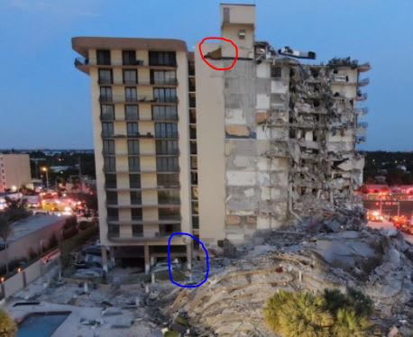

Also, the way the parapet ripped away from the remaining shear wall over the x10 units is intriguing - while most of the building ripped from the shear wall cleanly due to high force, the roof parapet did not. There was a column roof anchor into this wall. If the parapet and balcony fell onto the pool deck it would have fallen into the column that was damaged per the ENR article at about 60 mph per another post above. Per an on-site engineer, again in the ENR article, the backside of this column had impact damage clearly not from a vehicle, the transfer beam also had damage. This column damage appears to have been what caused the pool deck to collapse due to the damage pattern.
A roof anchor location hypothetically causing the roof and 12th-floor balcony to collapse is in red below. The damaged column causing pool deck collapse (per ENR report) is in blue below.

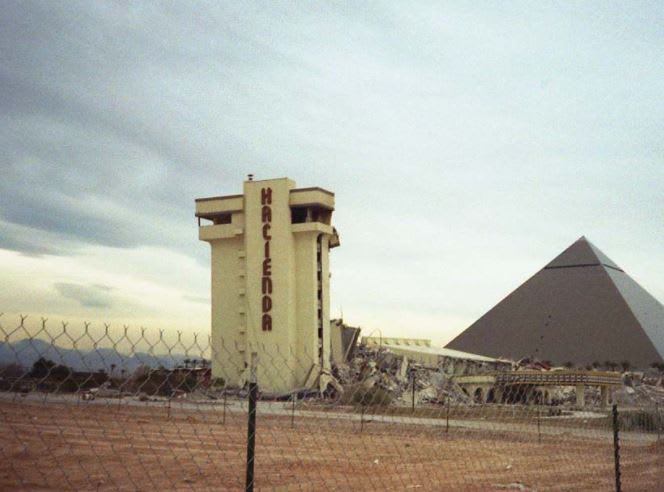

Hopefully, they are able to collapse it all the way due to the transfer beams.
The same company made this mistake in 1996 due to a similar transfer beam issue.
