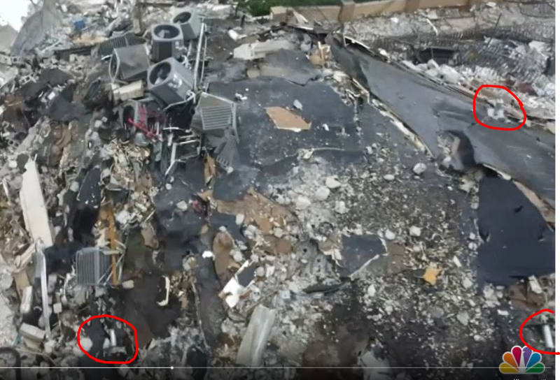

For the roof loads, I estimate qty. 150 of 3-ton A/C units (in groups of a dozen) plus a couple cell repeaters and electrical panels. That looks like 33,000lbs of add-ons distributed across the roof.
The A/C condensers were there on the original 1979 plans, so hopefully would have been included in the original load engineering. Similarly for the big HVAC unit, although it did change from spanning 4 D–E columns to spanning 4 E–H columns in a revision during the original build. The modern replacement for the big HVAC just consolidated two separate units into a combined unit on the same frame, spanning the same columns.

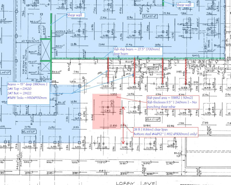

The remaining building is solid - it's still standing - with debris removed and the one column with major damage to the backside shored and braced. Most of the remaining columns from floor 2 to the ground are oversized with transfer beams.
TheGreenLama said:
Back when this building was built was "integrity reinforcement" (bottom rebar to resist punching shear) required in parking garage slabs?
Only #4@12" bottom steel each-way is provided except for the end span; for the end span addition #4@12" are added (see clip below).
TheGreenLama said:
That most of the deck slab failed successively in punching shear, with the slab remaining intact and still connected to the exterior column line. Then, through catenary action, the slab dead load pulled on that column line causing failure.
There are substantial shear walls holding the upper ground floor slab against the catenary action and all the tower columns are tied to the ground floor slab, but looking at the drawings in detail, I think the catenary action may have caused the failure of the exterior tower columns without engaging the shear walls.
See the second clip below, the slab step beam will be subjected to massive torsion when the podium slab fails and the torsion will be transferred as excessive flexure on the exterior columns.

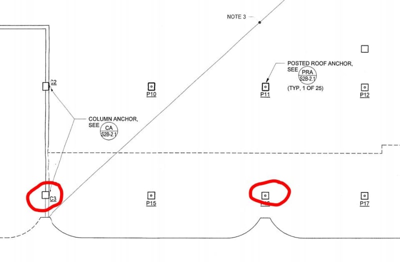

dragon6172 said:
Looks as though most of the perimeter anchors were supposed to be mounted on the cantilevered portion....per the structural drawing.
This is very very interesting, because they weren't supposed to be on the penthouse.
Penthouse anchors had just been installed, look at that fresh roofing paper.
Closest to the guest parking and damaged column, the 12th floor or penthouse roof is near the bottom of the pile, not top.
Those anchor points labeled P15, P16 and P17 are all on the cantilevered portion of the penthouse roof.
