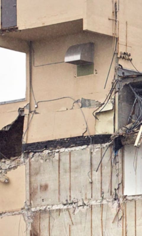

What were these two trunnion-like fixtures (one open, one closed) atop the columns used for?
I believe those are columns E2 & E4, and the western mounts for the large red HVAC support frame.
So if anchor test broke what little bond there was between concrete mid wall cap beam, then elevator vibration for the rest of the day/evening, after test could have triggered the CMU in fill wall to fall. And folks were coming and going to their condos lated at night, so elevator would have been operating.
Also what are the chances that once roof sheer wall was built they added penthouse, such that midspan elevator wall beam, spanned the whole way in one pour across the joined stair tower. A mid span lateral or diagonal pull on that beam would seem to cause deflection laterally in that beam in between block infill walls.
The black horizontal band which I originally thought was open space, is actually roof tar. The roof over the 12th floor was attached directly below it. Also visible in the picture are the broken cores of the CMU blocks in the triangular hole.
Js5180's picture also shows the broken column near tar line that anchor would have been mounted too....
Looks broken at bottom and up higher where horizontal beam would have been. You can see in the cracked stucco the lines for the elevator horizontal beam as well as the stair well horizontal beam, all connected at column anchor area

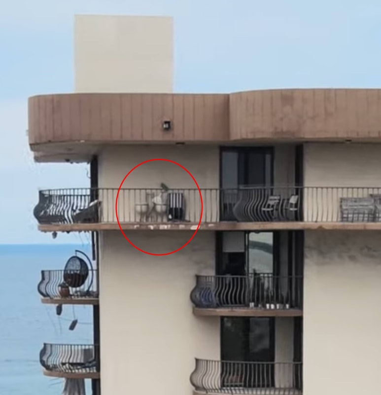

Here's the best available view of that balcony that I've been able to locate:
Well there goes another theory into the crapper.
