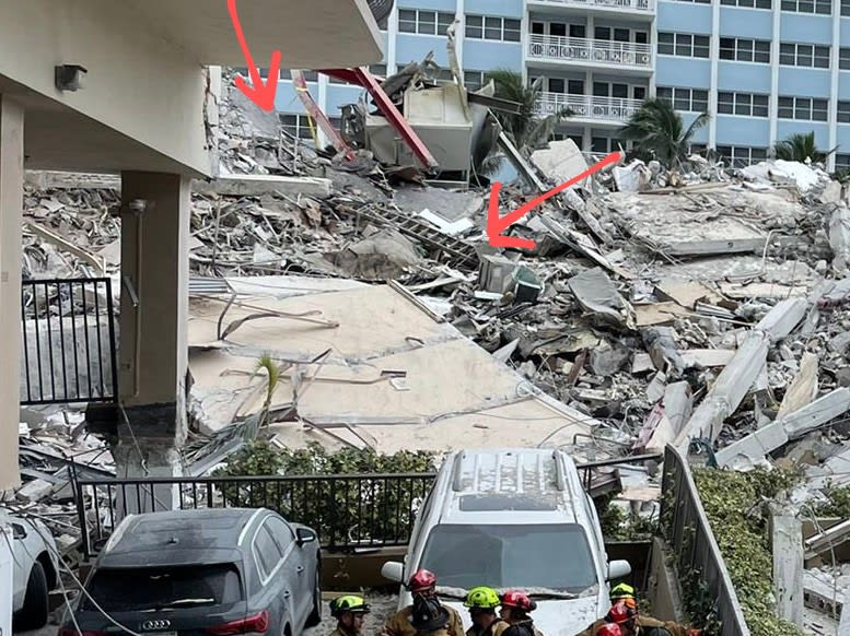

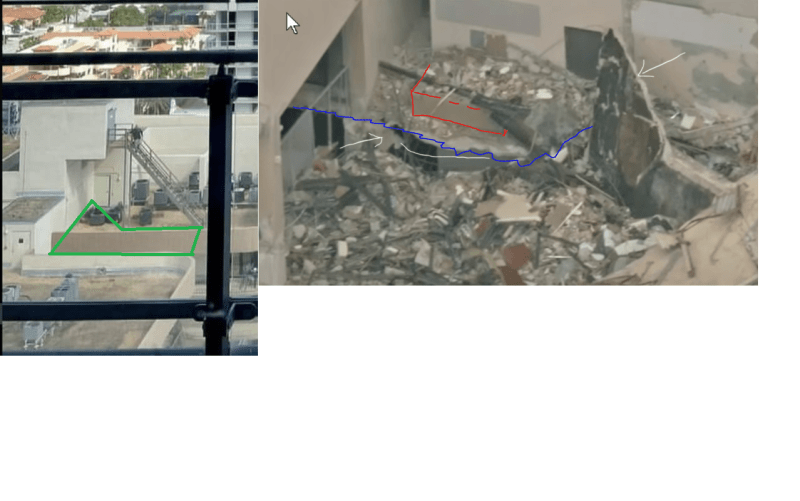

I don't think this is the right location for this to just fall down. If these stairs were fastened the way they should have been, there'd have been some, not a lot, but some, upper support on that roofing slab. If slab tor away at wall and around base, load on stairs and column would massively increase, with a rotational force clockwise.
Probably more likely more deck that sheared and tilted, possibly on a column. This again was an area of extensive concrete repair in the 90's. One of the sections that possibly only had either 305 stainless rods roughed and inserted, or 3 #5's. Hard to tell from the napkin sketch on the permit.

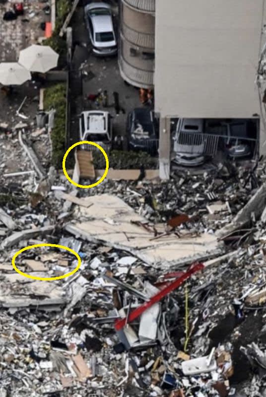

Edit 2: Has anyone found or seen the staircase in the debris? Should be at the top of the pile yeah?

Edit 3: Yeah, I don't know... Earlier large photo had a different angle.
Ah yes. You have shown the triangular tear-out is attached to......column and the wall is the portion I was calling "stained" contiguous with tearout past the column and is planted down in the debris pile. Or the debris is planted around it. Can't tell anything from a single perspective. I knew I was wrong about what it looked like. Nothing to see there. But then you can't tell when that fell in the sequence either. I mean not really. Nothing piled on top of it but that doesn't mean too much because its on the edge of the pile. is there a reaction between it and the slab or did it fall into a hole?

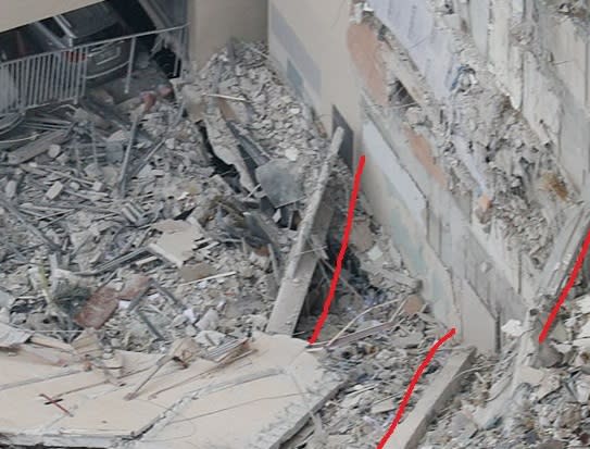

I still have my doubts about this causing the tearout we see though, but work was likely done drilling in that exact location. Would they have used the same 3/4" anchors?
The columns with the tear outs appear to be the ones that had the concrete beams that held the larger A/C unit. When the original collapse happened these beams pulled out from the top of the columns leaving the shape seen in the demolition video. It seems the lack of rebar at this point may have prevented those beams from pulling down those columns and helped stop the collapse at that point.

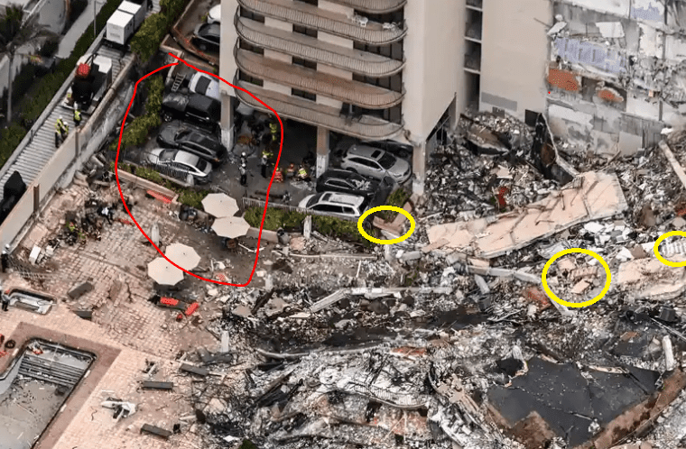

There are at least a few sections of the NE staircase visible.
Wasn't sure if you meant the northeast stairs as sgw1009 delineated above, or the exterior stair to the machine room? If I'm not mistaken, I believe these are the latter.
That photo was from July 2, but I believe they hadn't removed much from the area due to the proximity of the remaining tower. While I was searching for an older photo, I found one from June 24 at a different angle which I believe shows the same stairs (red arrows). Forgive me if this particular point has been addressed previously, but I do recall mention of tie-downs with the roof work and AC units. I hadn't noticed what appears to be a yellow ratchet strap tied off to one of those red AC platform beams, said beam kinked at that point. The other end appears to be attached to one of the new roof anchors, possibly? That kind of deformation, to me, shows the anchor put up a pretty good fight as the building tore apart, and it eventually popped out of where it was attached. (To be clear, I'm in the "accumulated pile of exacerbating factors leading to eventual failure" camp. I just found this interesting as there's been so much discussion of this area of the roof.)
253RWD, thank you for the photo showing the door to the middle roof above. Fortunately, I had agreed earlier with Santosi81 and Murph_9000 that a door was there.

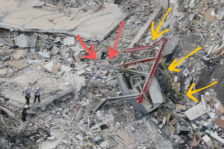

Now, if you look closely at the photo you may see something interesting that you, Murph_9000, and Demented (who also posted the same photo above), may have missed. In the photo underneath the stairs you can see three air conditioning units that are not tied down to foot-high metal supports like they should be. And they appear in a place where air conditioners are not shown on the architect's drawings. Clearly, these air conditioners are either old ones being replaced or new ones to be installed. If unsecured air conditioners can be found on this part of the roof, then it is likely that others also can be found on the penthouse roof adjacent to this area, from where one or more of them could have fallen down to the deck below.
Question. Do you know when this photo was taken?

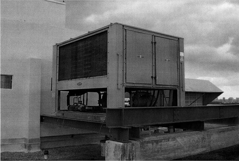

I'm not too sure a ratchet strap would be strong enough to kink that beam but a lifting sling would be. I can't find a spot on the still standing portion of the building where the other end may have been attached so it could have been attached somewhere on the part that collapsed.
Edit: It also looks like the beam twisted nearly 90 degrees if that helps anyone.
Looking at the roof view from 2021 (with the new unit on it), the eastern (right) two beams are painted red, while the two beams under the HVAC unit are not visible. So the crimpled beam would have to be the eastern-most beam of that assembly. This is away from the standing portion and towards the portion of the building that collapsed. Looking at the roof view from 2021, the crimping would have occurred on the right-most (east-most) beam, about 1/3 of the way up from the bottom (from south to north). This is essentially the center of the roof, so no obvious need for an anchor point at that location. No ideas on what that was about.
I agree with all of that. Among the things we don't know is why was the sling there? Did the red iron fall first and rip out the anchor, or did the point it was attached fall first and pull down the red iron? It almost looks like the iron was bent upwards but it my have bent when it hit the debris pile.

So one would think that the larger beam would be under the four smaller beams, giving them support. But looking at the photo below, it shows that the opposite is true: the larger beam is on top of the four smaller beams. So this means that we are seeing the bottom view of the assembly (colors of which are unknown), with the crimped beam still being farthest from the standing section of building. Note that this is the old HVAC unit, and the new unit was installed to its right. But the support assembly is the same.
sgw1009 said:
So whatever was tied to the beam was to the west of the HVAC assembly, not the east.
And if we're not confused enough already, did the strap go to the east, or maybe under the unit to the west? Were they using it as fixed point to test the new roof anchors? Maybe it went over the unit to hold it down because they were changing the method of securing it to the steel? Good questions often lead us to more questions.
