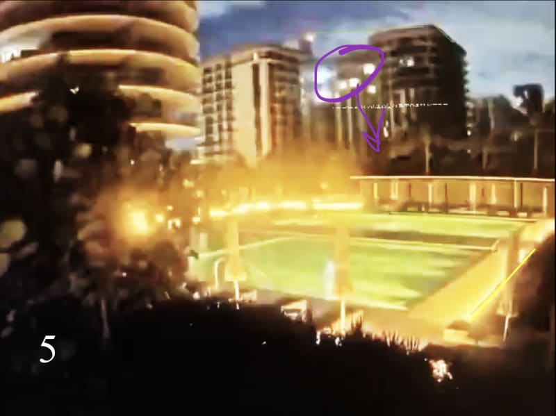

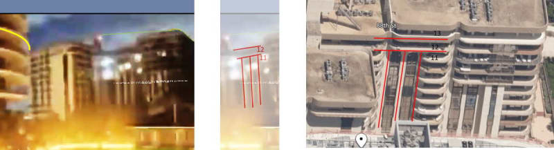

The next and most startling thing I see, is that the collapse does not happen as a single fall, but in stages.
Starts at the lower x11 stack, then the UPH hinges along the E-W interior at or just before the corridor showing the PH (12th floor) soffits proud to the camera, PH-11 balcony gives way and swings vertically to the east, striking the lower x12 units, where the columns supporting the massive eastern lobby level beam group fail, and so on.
A lot of motion not only in this area and direction, but towards and away from the camera as well.
The biggest problem for the 'roof first' theory (at least the variant of it that has something drop off the roof to start the plaza failure) for me remains the fact that no-one, especially 111, reported anything falling from the roof. If it had bounced off all the balconies on the way down then 611 would have noticed that. We know the plaza failed before the main building, and we know it failed somewhere in front of 111, if not first then certainly early on (from the TikTok video).
There are certainly lots of reasons to be suspicious of the roof work. It's even possible that the roof slab failed (we know it was water saturated in areas, particularly around the area that collapsed) and maybe even that the penthouse roof crushed the whole penthouse with nobody noticing, if it was empty. And it does seem too much of a coincidence. But I don't see a mechanism for that to result in plaza slab failure, which I think we all agree happened before the building column failure.
@SFCharlie, thanks for fetching the freeze frames. I am now somewhat more convinced that by the time of building collapse, the 13th floor is missing in the collapsed section. I've taken a grab of frame 3 from your set, where you can clearly (well, by the standards of the video) see the floor correlation, along with the Bing aerial shot for comparison.
You can clearly see the strip of paired non-balcony windows running up to the 12th floor balcony, and the 12th and 13th floor balcony parapets. But the 13th floor itself is missing (at least the front portion) in the collapse area. We don't know if that happened 5 seconds earlier or an hour earlier though. (Someone posted a few threads back that the alarm should go off if sprinkler lines are cut, but I think everything is serviced via the corridor, so if the slab is hinging and only the front part is dropped, they might well not be cut.)
I interpret that first frame of video as being after the central south facade has dropped roughly 1 story. Of the 5 lights in that section, I see the living rooms of 1010, 1011, 1210, and 1211; with the lit pair of non-balcony windows being the 1111 bedrooms. I also see the master bedrooms of the x12 stack hinged downwards to match the drop of the x11 living rooms. The lights are still on briefly because everything is basically just hinged down at that point, so the cabling has not yet been ripped apart.
For me, the PH floor and roof is there, not sure about the PH and roof parapet over the x11 units, and it's the basement or first floor that is missing at that point.

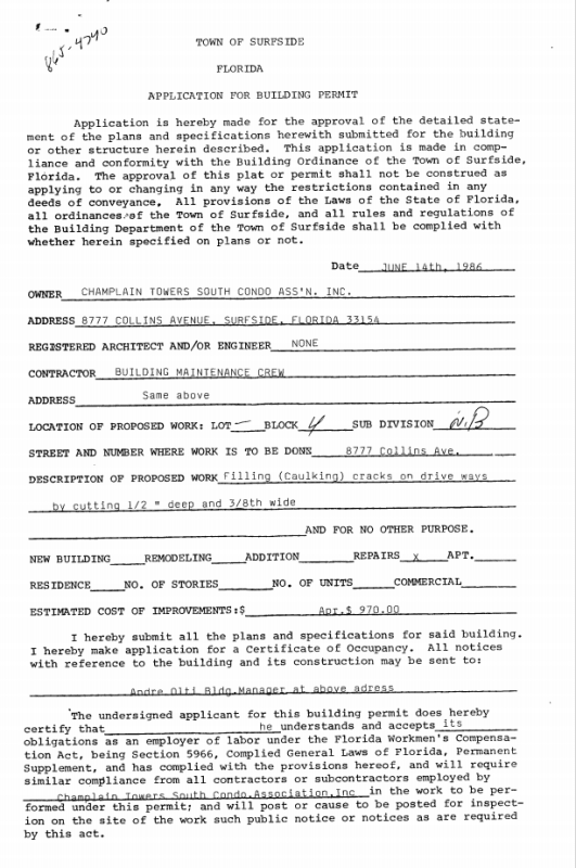

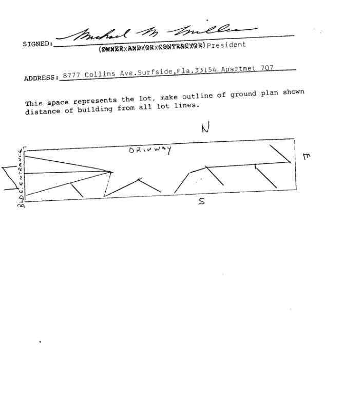

Caulk?
Who thought caulk crack repair on a slab was a good idea?
This would have been hidden from view and covered with pavers. Man was that parking deck full that night.
Also wonder where that .5" depth actually landed.
I think it's quite clear that there isn't a parapet directly above that lit pair, and there is an unlit pair above? So that must be 1011 (lit) and 1111 (unlit) because there is a parapet going across above the unlit pair and not directly above the lit pair.
It's also actually an interesting question as to why we can't see the balconies on the collapse section. They are quite clear on the S part (that never collapses) and upper floors of E part, and you can clearly see the (what I'm saying is) 11-12 and 12-13 full width ones. Is it just because it's moving so the video artifacts obscure them?
1211 did not have a parapet, it had a full width balcony with railing. I think the balcony slab is there directly above the lit pair. To me, the continuous vertical line in the facade, between the x11 bedrooms, is interrupted directly above the lit pair, by the 1211 balcony.
The upper PH balcony has a parapet over the x11 stack.
Edit: Yes, I think the movement is blurring all of the x10 and x11 balconies. x12 has essentially not moved much at that point (on the east end, the master bedrooms on the west end of x12 are probably moving)
