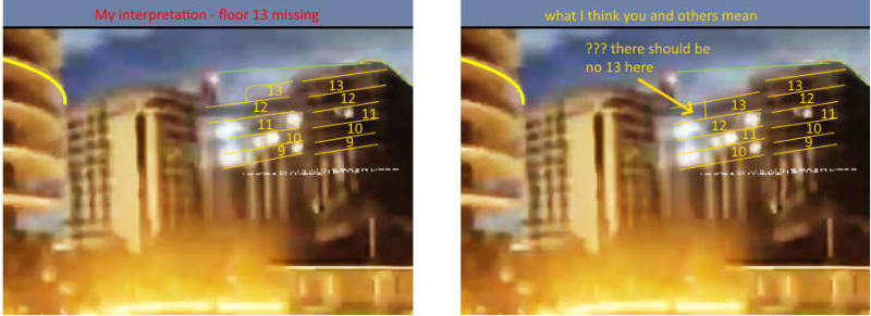

> @LionelHutz To me, that column without lower level balconies is ending with the 11th floor balcony right above the windows with lights on
That just goes to show that different people will see what they think they already know, when presented with unclear imagery. To me, frame 3 (the one I posted in my comparison pic), and also 18, clearly show the strip of separated windows below the 12th floor balcony going up one floor above the lights. Frame 0 (although full of artifacts) and 1 also appear to show something where floor 13 should be, at the right hand half of the collapse area.
The 13th floor should be present over the double pillar, and the right side, but not over the left side (there was no floor 13 there). I'm struggling to see in your version what the visible structure on the left side on that floor is.
I also put the (not under dispute afaik) floors on the right side in so we can see how much the building has dropped. In my interpretation the camera has actually triggered pretty much at the start, the floors still align well, only floor 13 is missing, and it looks like (with the eye of faith at least) you can see that collapse in frames 0-2.
> @Santos81 Most of the “lights” in the x10/11 stacks are reflections from glass that is no longer in place. The two bright flashes from the X10 stack are reflections from a fire alarm signal on the exterior landings of stairwell 1. There are a couple of exceptions but it’s a very macabre subject I don’t feel is appropriate to discuss in detail.
We're looking up from ground level, what are those windows reflecting? Surely we'd be looking at the sky reflected? The 'lights' in 911, 1011 and 1111 look like real lights. But yes, if they're real lights that means people turned them on and didn't get out in time - nicer not to think about that. I don't think it's particularly relevant to the engineering 'what happened' side.
Do you know what floors those fire alarm signals were on? That would clear up which floor is which.

I still favour a plaza-first failure, but if you think that frames 0-2 of the collapse show floor 13 collapsing first, perhaps a partial failure of M9.1 from the loss of support from the pool deck is what causes the roof slab to let go.
Since you asked, I looked again and yes from the start all along I have actually believed the lights are on the 11th floor which puts the 12 floor balcony above the lights and the the double rows of parapet above that. I'd get the floor numbers right if I would stop counting the roof parapet as the balcony for the 13th floor.
I don't agree with the angles on your right side floor lines.

They’re reflecting the ground lighting. The exterior luminaries are not the only part required to be sea turtle compliant; the glazing is as well to minimize interior light transmission. The only interior lights that are visible in the footage are at locations where the balcony doors are either open or the glazing units have detached from the envelope or shattered before power was lost. Several balconies were occupied. People seem to be omitting material displacement when analyzing the footage.
The flash heads are on the north elevation of the floor landings at every floor. I believe the artifact I circled in red is from one.

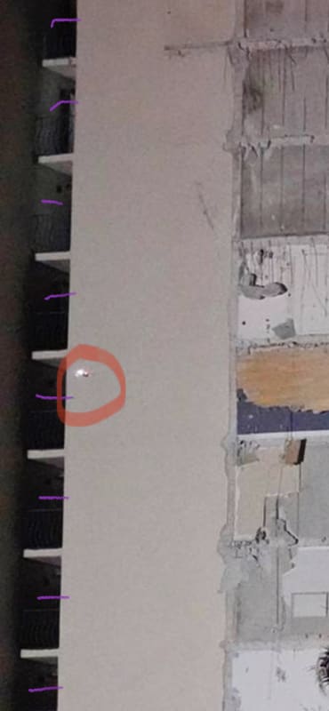

I don't think that can be. Those flashes illuminate a bit of the left side of building, and they last way too long. Were the light sources from the opening next to the western stairwell, they'd illuminate a good chunk of the mid section building instead. They'd perhaps be synchronous unlike in the video, and much shorter than electric sparks. A typical xenon flash is 5 microseconds. (One can be seen on exposed 13th floor passageway - two strobes, a few seconds, another two strobes, each strobe occupying exactly 2 frames.) A typical arc/induction spark is ~10 milliseconds and the were 12 tubes going east from each meter room. A single exposure at 30 fps naturally maxes at 33ms.
Edit: I see the fixtures on every floor in the surviving open area next to stairwell. I'm just not sure they flashed at all. Maybe they're unusually dim for how recessed they are, or you'd expect almost uniform illumination bouncing off building or smoke.
Also some of those window lights were not reflections... too square, and reflections move as the building tilts. The flecks seen in 1112 and then 912 could very well be reflections. The lights that vanish at the same time as 1209, not so much.
