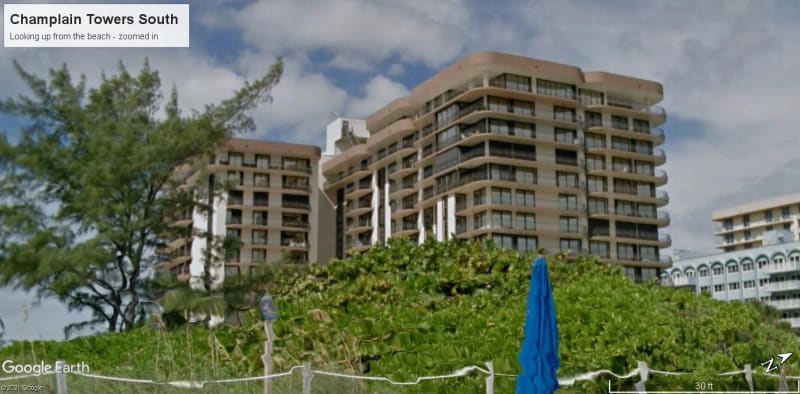

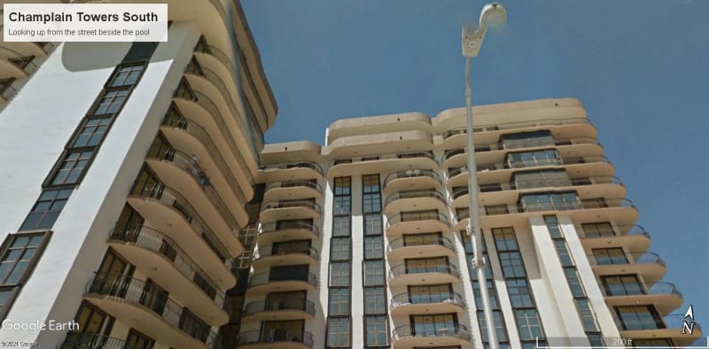

Red Corona (Computer)28 Jul 21 23:33 said:
why we can't see the balconies
I'm trying to corollate what I see in the video with the real building, so I took a couple of snaps in Google Earth Street View
and
I think it is difficult to see the balconies edge on...
