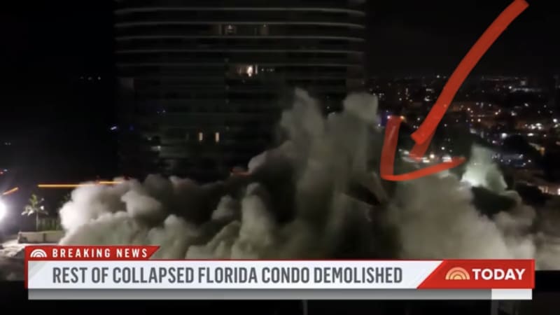

Spartan,
You say, “Sketch out where this >15’ piece of parapet wall cleaves itself from the building. What’s that weight? What mechanism of failure are you proposing?”
Watch the controlled demo video. The parapet over unit 1205-ish clearly “cleaves itself from the building.”
EDIT: the parapet cleaves itself at 0:11.
It isn’t “wild-eyed” to see that in the video, the upper PH roof slab left/west of the M is missing, and the right/east section is not.
You can pull out your thesaurus and throw a few more adjectives around, but I see blue sky, beginning just left of the M column line. That’s a clean break. What’s your explanation for this?
