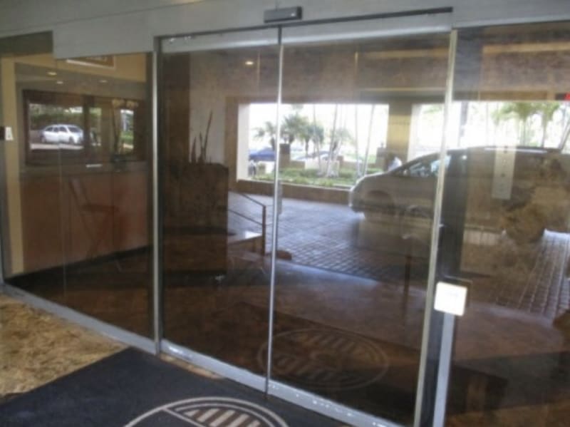

When the bulk of the collapse happened, it seems in photos that the stucco ceiling going across the front of the first floor detached from the slab and fell across the driveway and right over a black SUV parked there. I suspect that this blocked the front doors and it wasn't immediately realized in the dark and confusion.
The Automatic Doors at the main entrance don’t appear to have Emergency Breakaway operation marked at minimum; at worst they don’t have breakaway from the interior.

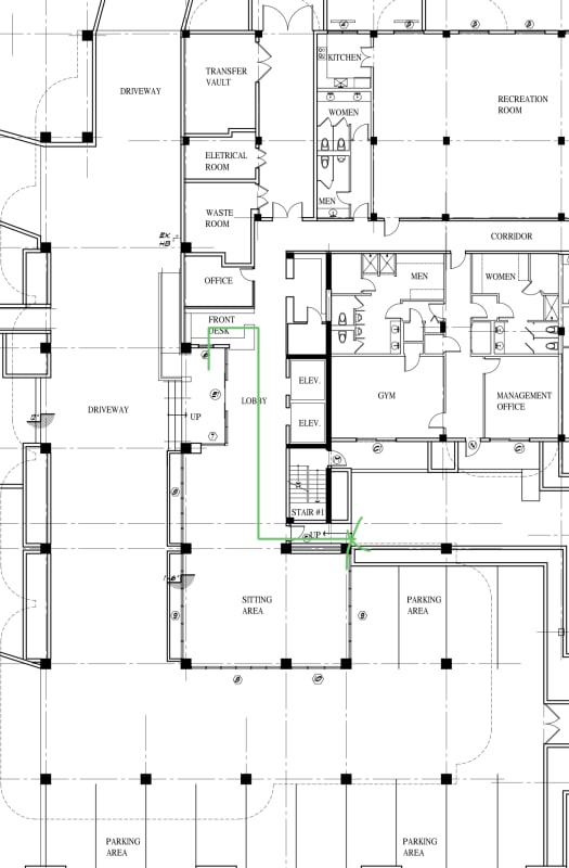

I also questioned this, as it would be a long walk around to the beach side to get easy access to the pool deck. I imagine she could have climbed down near where the sideways car was, as she got an injury at some point.
The interior route perhaps? This is the path followed according to her own statement.

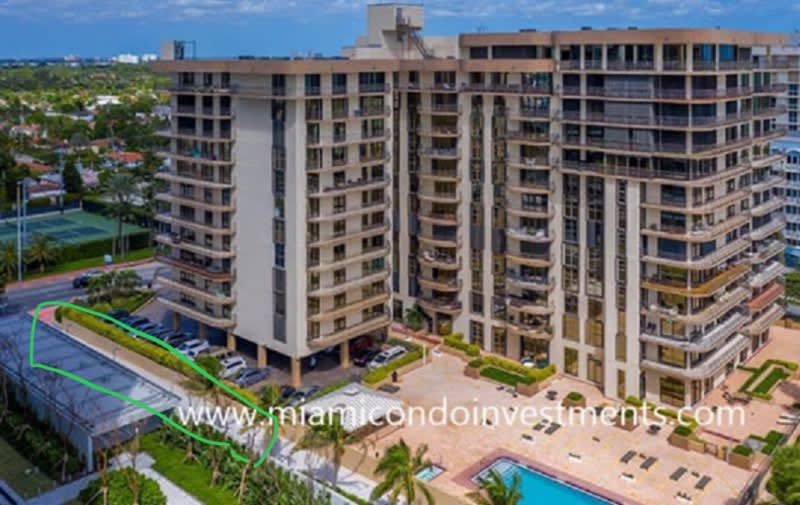

The guard was helping people escape from the basement. It's unclear how she got there, being as how there's no access to the stairs from the lobby?
I too questioned this. In reviewing Ileana Monteagudo’s (611) interviews, it seems that she made it all the way down to the ruined garage and there encountered Shamoka Furman who guided her out.
>>>>>Edited. Ms. Monteagudo mentions climbing and having to get across a gap that was so wide that she would have had to jump if she hadn’t found a place to put her foot so she could instead step over the gap. Per the WaPo feature, they ended up in the visitor parking lot.

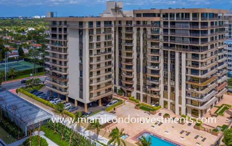

rodface said:
Rendering with reference objects aligned with CCTV frame for reference. Something is still not quite right about the positioning of the camera and/or the reference objects.
The camera is located at:
N 25° 52.32451069'
W 80° 7.21234571'
Elev: 15’ NAVD
Direction: 326° Magnetic
Azimuth: 0°

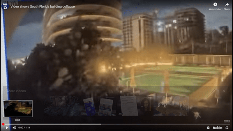

LionelHutz said:
Js5180
Can you explain what parts of the building the 3 arrows are pointing to?
From top to bottom:
PH parapet wall
12th floor parapet wall
11th floor balcony
All of which appear to have followed the stories below them down the 1.5 floors or so that were in the process of collapsing when the video started.

The first photo below shows the first frame of the surveillance camera video. On the extreme left-hand corner of the Champlain Tower building we can see that both windows and parapets appear to be dark while the undersides (i.e., ceilings) of the balconies appear to be light. This is because: 1) the camera is located close to the ground, which gives it a view of the undersides of the balconies, and 2) the photo has been taken at night when the only illumination of the Tower is from the adjacent building, which means that we are viewing features by reflected light only. Since more reflection is produced by the undersides of the balconies they appear to be light, while the windows and parapets reflect the light away from the camera causing them to appear to be dark. The relative brightness of these same features appears to be noticeably different under daylight illumination as shown in the second photo below.
Since both windows and parapets appear to be dark while the bottoms of balconies appear to be light, there should be the following layers on top of each other over the right middle section of the building (from bottom to top):
1) 12th floor window (dark)
2) 12th floor balcony ceiling (light)
3) 12th floor parapet (dark),
4) PH windows (dark),
5) PH balcony ceiling (light), and
6) PH parapet (dark).
Note that the PH windows in this section of the building are obscured by the 12th floor parapet, which should make them appear to be half the height of the PH windows in the right corner part of the building. But the 12th floor parapet also appears to be dark to the eye, so the PH windows in this section of the building actually appear in the photo to be the same size as the PH windows in the corner of the building.
Over the left middle section, above the partially lighted 12th floor, the following layers should be seen (from bottom to top):
1) 12th floor window (lighted)
2) 12th floor parapet (dark).
Note that the light 12th floor balcony ceiling merges into the lighted 12th floor window, making the lighted 12th floor window in the photo appear to be taller than normal.
If we now look at the first frame of the best imagery we can find of the CCTV surveillance video, and not merely the blurred image shown above, what we actually see over the middle right section is this (from bottom to top):
2) 12th floor balcony eiling (light)
5) PH balcony ceiling (light) - but thinner on the left than on the right
6) No dark layer above the light layer.
This implies to me that the entire PH parapet over the right middle section of the building is missing, along with part of PH balcony on the left-hand side of this right middle section.
The simulation by rodface appears to be quite realistic, and he should be congratulated for his effort. But I would recommend that he change the brightness levels of the balcony ceilings and parapets to better simulate viewing them in reflected light than in daylight. This should then bring his simulation even closer to the CCTV video.

Windows only appear dark if the room lights aren't on. We can gauge the reflected light by the large vertical stucco stripes. The appearance of the parapets can be gauged by the remaining parapets on the eastern most section. It is the same for the balcony undersides.[neutral]
(Please note that the first frame is uniformly dark, and the frames gradually lighten up until at least the fifth frame.) (This is why I use brightness and contrast setting to attempt to obtain uniform appearance through out.)[pipe]
Nice theory, but by the time you find a clearer frame, like the one I captured part of, the camera can no longer see the under side of any of the overhangs in the collapsing part. I’d say it’s more likely those slabs have hinged down so the parapets are being more lit than the other parts of the building.

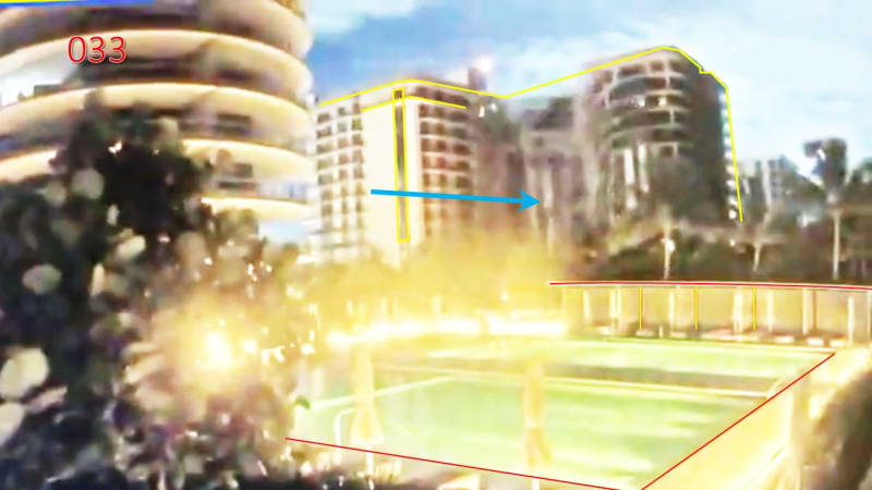

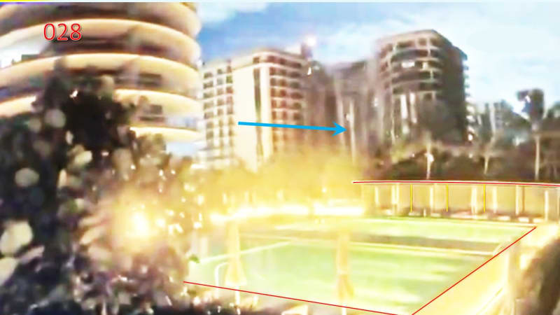

SF Charlie said:
It strikes me as strange, that you should choose a frame where one of the vertical white lines is obviously broken to make your case?
Well, the choice of that frame was unintentional.
But - since you point out the broken band - is it showing any downward movement? Clearly it has some sort of break or damage at a particular spot. Now you have a point of reference - does it descend at all in the time it is visible?
Yes (I believe that the frame you choose is #28. If I look at frame 33, without moving the blue arrow, I see that the brake has fallen and is fragmenting.)
