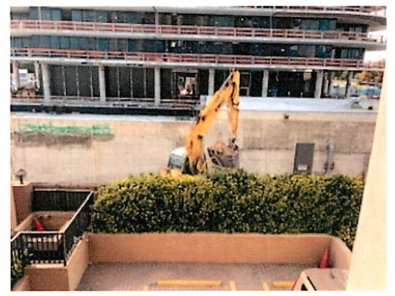

As reported to Mr. Pietro on the 23rd of January, 2019, with not a care in the world given.
Gotta love that location for some trenching action.
Care to explain what the perceived problem is?
