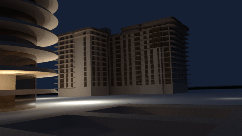

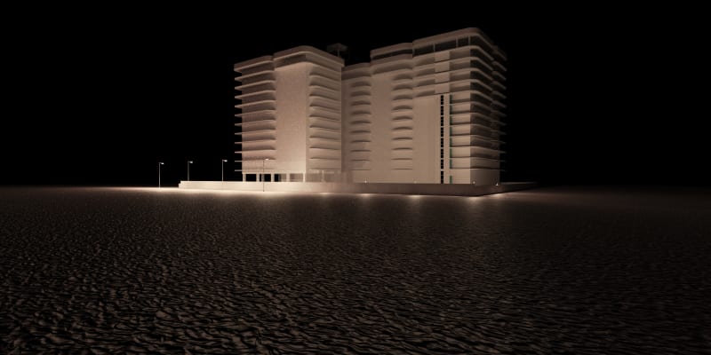

Update on the rendering. I have
-Modeled the PH level columns and glazing
-Completed glazing of East facade
-Took a shot at the lighting
-Adjusted camera (@Santos81 thanks for the coordinates), still just eyeballing it but feels very close now
Full-res attachment:
Link
Impressive. It shows the skyline of the first-collapsing area as noticebly darker and harder to see than the eastern section. I think this poorer illumination may have contributed to an impression of missing components.
Not too shabby there rodface. If it helps, the camera has a 108° FoV and focal length of 127’
It’s a start…
Whether it’s worth investing much time on is questionable
(Applause) now *that* looks right.
I’m definitely only going as far as needed to provide the “initial frame” of the CCTV. I probably won’t bother with floor 1, the garage, the pool deck and beams, etc... all of which your model is clearly incorporating. Not to mention the columns and interiors etc.
I did have a go at modeling the cooling tower and ducting, 100% eyeballed with no accurate dimensioning (LOL). But as it turns out it’s completely obscured from the camera angle.
I *am* putting effort into getting the windows just right, they help make sense of the mush. Already I think I can better identify where exactly the collapse is happening.

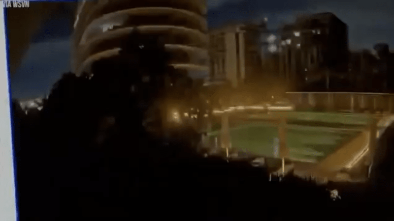

SF Charlie,
I can’t argue with that - it has clearly moved between 28 and 33.
Looking at the video, it also appears to be present in frame 1, but not on your version of frame one:
Source is:
Any agreement/disagreement?
It is a bit over the top but was not really intended for this purpose. There’s an absurd amount of data in the model which helps for accuracy; just makes it very slow to render despite hiding 80ish percent. I wanted to focus on the lighting for now as it provides the most clues to work with. Windows, doors, and hurricane shutters are very important.
HVAC models as delivered to job per spec were provided by the manufacturer.
It is a bit fruitless though as the collapse is already quite far along; everything east of Shear Wall 1 is in motion and no longer in the position it was just prior to the beginning of the failure. The distortion on the right side is not caused by the lens.
Instead of seeking proof that the roof was the cause, examine how it may have been the key to the collapse NOT occurring sooner.

The comment about the dust makes a lot of sense - the area of the “missing parapet” could be interpreted as a dust cloud.
Thank you for calling our attention to the nytimespost - June 26, 2021 Article
Two engineers who reviewed a surveillance video of the collapse in slow motion said it appears the upper part of the building’s middle section collapsed before the lower part.
If the collapse had begun with the foundation, geotechnical engineering professor Steven Kramer of the University of Washington in Seattle would have expected to see everything going together. Instead, he said, the top several stories appear to fall first.
A clue was when dust first appeared in the image.
“The view [in the surveillance video] of the base of the building is obscured by the trees, but I think that dust would have appeared above the trees earlier if the failure had started [at the base],” he said.
We have had a lot more time to round up more evidence. The witness interview contradict middle floors first.
As for dust, trying to separate dust from camera and compression artifacts (fuzziness etc.) requires more that just viewing the video in slo-mo IMHO.
SF Charlie
Eng-Tips.com Forum Policies
The on-shore wind wasn’t light that evening either which would have forced most of the initial dust into the now windward open garage and exit through the ventilation shafts and any vertical chase not sealed; for instance the elevator shaft. Now where does that exit again? Hmmm…

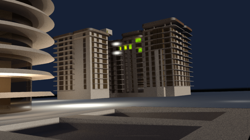

Created this mainly to scratch a mental itch. Attempting to replicate the appearance of CCTV frame 1.
The model cannot actually be distorted so this was done in Photoshop.
The central section has been moved downwards by about 1 floor. No attempt made to render the interface between sections; just treated it as an (unrealistic) clean slice.
Lights have been added to aid positioning.
I have not added/shown the interior/rear of building which appears to be visible behind descending central section.
All based upon my amateur observations.

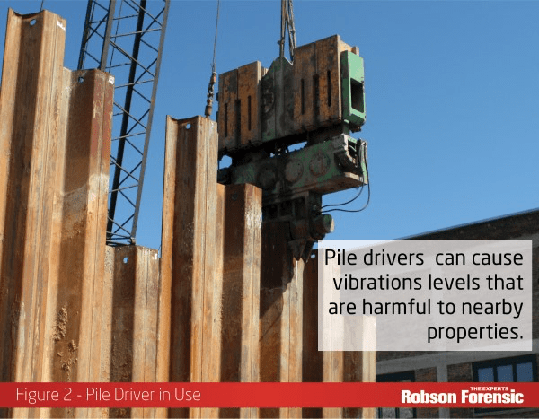

Excerpt from Structural Damage from Adjacent Construction Projects – Expert Article from Robson Forensic website, link below:
There are several ways that harmful vibration levels due to construction activities can cause damage to neighboring properties and structures. The most common include; damage to a structure directly from the energy of the vibration source, resonant structure response (i.e. the natural frequency of the building and soil matches the frequency of the ground movement causing uncontrollable shaking) and/or the densification of soils supporting a building structure resulting in settlement. All these vibrational effects can result in cosmetic damage and/or irreparable structural damage.
Vibration can occur from numerous construction activities, including:
Blasting
Pile driving
Compaction / dynamic compaction
Jackhammering / chiseling
Vibrofloatation
Pavement breakers
Demolition
Trenching activities
Heavy vehicle traffic
If construction activities which include potentially damaging vibration are scheduled to occur on a specific job site, it is imperative that one or all of the suggested measures below be implemented:
A well-planned due-diligence investigation and project coordination of neighboring properties. An example would be to determine if a neighboring facility has sensitive electronic, instrumentation or imaging equipment such as an MRI that may be disrupted by construction related vibration activities.
A pre-construction survey of all adjoining structures
A geotechnical report that clearly identifies the underlying soil strata and geologic conditions
Specifications for the control of construction vibrations
Pre-planning to avoid potential vibration damage by selection of alternate construction equipment. For example, auguring/pre-drilling piles as opposed to pile driving.
Construction logs of equipment and approximate time frames of construction
Vibration monitoring by a licensed testing agency
Building movement monitoring of neighboring structures by a licensed testing agency
Prior to construction activity, it can be desirable to establish a benchmark, especially if there is pre-existing damage such as settlement or structural deficiencies to neighboring structures. This particularly holds true if the building is older and would have a tendency for a lower tolerance of vibration induced damage.
Furthermore, forensic studies following a claimed damage event, to determine if a building was damaged by neighboring construction vibrations, should include knowledge of the geological conditions, where the vibration producing activity took place on the construction site, if there were any monitoring devices, and whether there were pre-construction surveys that could be evaluated as a bench mark for pre-existing damage. Therefore, it is imperative to document the location and type of construction activities which occur relative to the potential damage.
