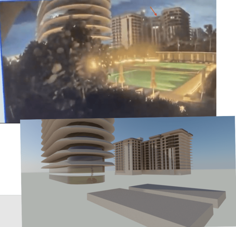

The new one I posted still goes to frame 33, but I removed the apparently duplicate frames.
I'm still working out some process issues, before I go full bore on the some 200 odd frames I have dumped out.
(the attached is a work in progress. I stopped because I was too tied to risk flummoxing it up...)

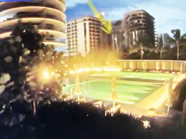

And despite the video being blurry, it’s also easy to make out the white stucco band on the K column, and it doesn’t seem to have moved in the first 34 frames, despite the collapse being well underway.
Post a picture with an arrow to this white stucco band, because I don't see it. Maybe you think the dust cloud is a band?
Js5180
Can you explain what parts of the building the 3 arrows are pointing to?
SFCharlie - There is a computer app named VideoPad Video Editor that has a video stabilization feature. You can easily find it through Google. I downloaded and installed it to play around with the video stabilization on the Ring camera video. If you have a copy of the collapse video in video form (a stream and not just a collection of individual pictures), you might try this app. For me it was free. And it did stablize the Ring camera video, but the stabilized video was really no more informative than the original. But it might be worth a try on the collapse video.
Lionel - those are the upper floors, collapsing mostly inward.
White stucco bands are the two vertical white lines:

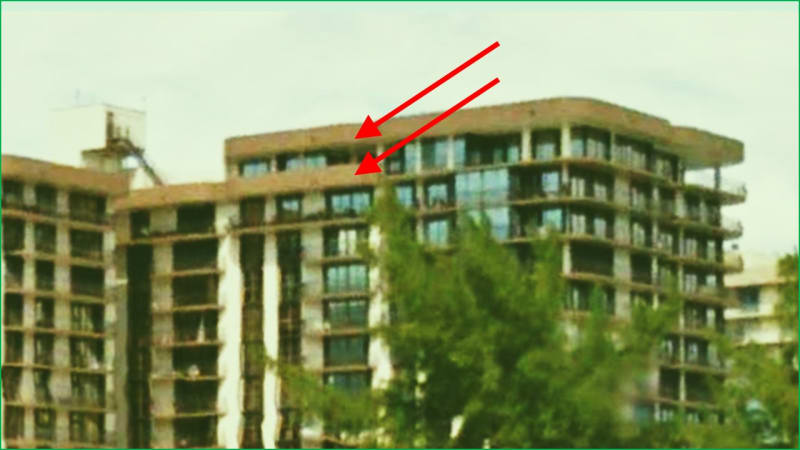

Js5180, Please correct me if I'm wrong, Thanks
The top two point to the 13th floor PH roof parapet, and the 12th floor PH roof parapet that wraps around the PH.
3rd_Attempt_to_duplicate_approximately_the_view_from_the_CCTV_twitter_vid_of_the_collapse_PowerPoint_pybbrr.jpg

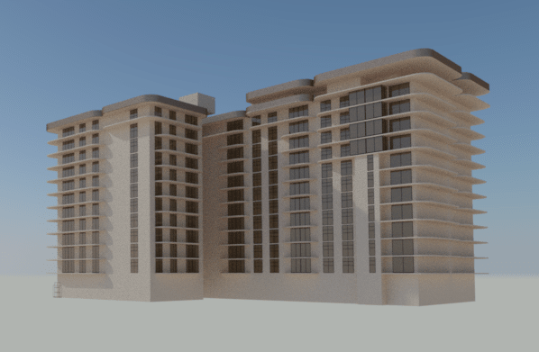

Thanks to those who pointed out the issues with the model.
The main goal of the model was to get a sharp view of the intact building's forms as seen from the CCTV perspective. I don't know the exact location of the camera on the adjacent property, nor its height above ground, so I made a best guess and adjusted the camera focal length until everything looked close.
I have added :
-the missing parapet on floor 12
-improved windows/glazing
I have not yet modelled:
-glazing on West facade
-glazing on 1st floor
-glazing on 13th floor (PH)
-balcony railings throughout
-I see now that 2 columns of windows are missing in the "elbow"
New rendering:
Thank You!
Thank You!
I know this represents a large amount of work!
It looks great!
Maybe the camera could be a little to the left, a little down, and closer (more wide angle)
I'm probably asking too much, sorry.

Edit: Thank you sir, I will try fine-tuning the camera. I have never received proper training in AutoCAD rendering for architectural presentation so bear with me please [bigsmile]
Edit2: And yes please feel free to use these.
Rendering with reference objects aligned with CCTV frame for reference. Something is still not quite right about the positioning of the camera and/or the reference objects.
Added the missing columns of windows. Noticed another missing column of windows at far right on floors 2-9.
I recommend that people rewatch the Building Integrity video from 3+ weeks ago where he conducted an analysis of the potential that the roof had collapsed first based on the CCTV video and debris: Did it start at the roof?
It also seems apparent to me, without powerpoint analysis, that you can see the whole penthouse roof with intact parapet tilting forward between the 2 and 3 second mark of the video.
