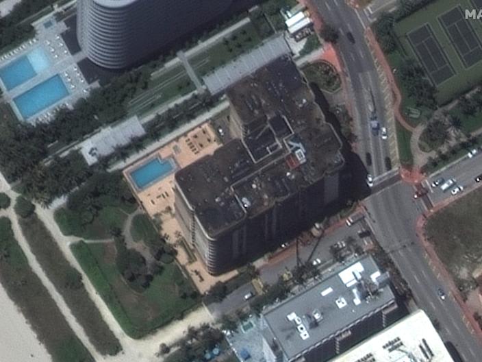

What’s tricky about the 1:10 AM Collapse 1 (which sounded like a wall collapsing above) is that the Vazquezes didn’t report seeing concrete rubble in the garage when they came in right before the 1:15 AM deck collapse
I think we have to treat all witness statement times as approximate. Who goes through their day watching the clock constantly? I remember taking my trash bin to the curb this morning around 0645 but it could have been closer to 0700. There's no way I could say precisely what time it was. Know whut I mean Vern?
If the progressive failure of the patio slab originated at the construction joint nearest the pool (and furthest from the building) it would explain why there would have been no concrete rubble debris visible at the ramp. As that would have been the last area to have failed of the slab if the progressive patio failure slowly chewed its way towards the building.
It would also explain why the noises in 111 got progressively louder and more intense. Culminating with the collapse of the parking area immediately adjacent to the lobby as witnessed by Nir while she made the complaint related to being disturbed by construction noises.

Debirlfan said:
Where was the crane located? Where was the tar kettle located?
Easier to just look.
