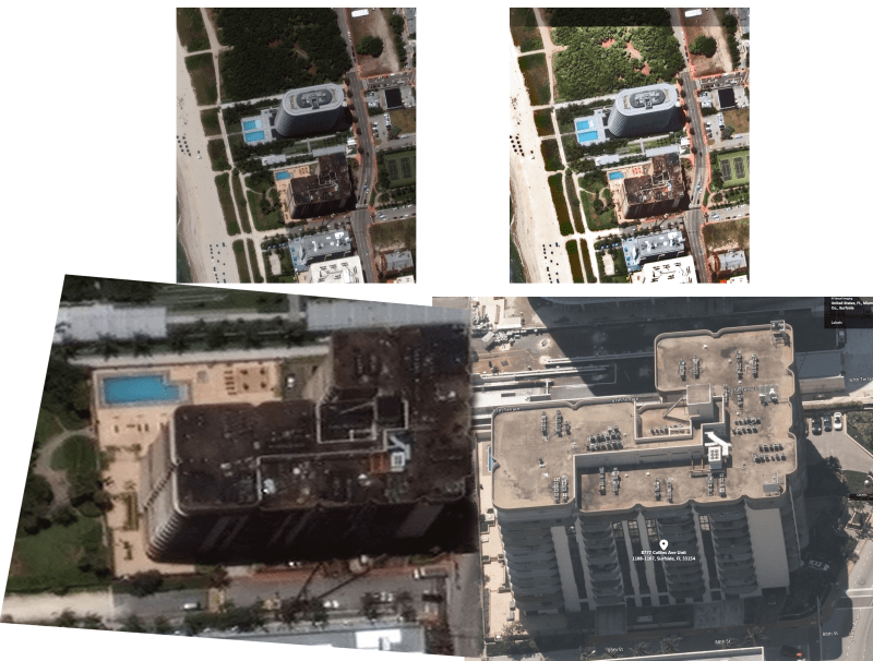

What was the date on that image?
It’s indexed as 2021_06_23. I believe the flyover was the 22nd as all the other usable imagery from the 23rd is partially obscured by cloud cover.
There isn’t a geospatial metadata file along with it and no date in the exif data to provide the exact time.

Re: Roof Image with Crane

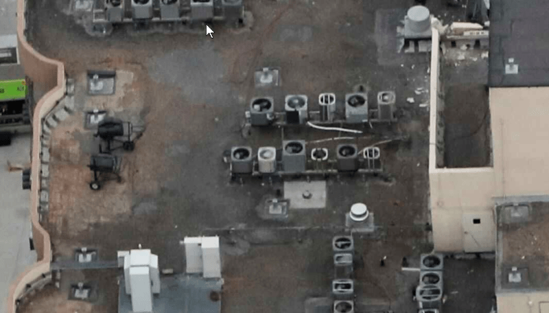

That is odd because we know there were pallets of tar paper and small kettles still on the roof June 24th. There doesn't look to be anything like that on the 22nd, yet there's a crane in the Bluegreen Hotel's parking area? Granted that's a very grainy image.
What's the source, Google Earth? How can we get dated imagery?
The whole purpose of having a crane is to lift things up to the roof that are too heavy or bulky for the elevator.
From the shadow of the building I would guess the time to be around 11:00 AM and if quitting time is 4:00 PM that means they have four hours to lift those items up to the roof and one hour to break down the crane for road travel.
Also, it looks like the roof anchors were done early.
Edit: Yeah, they also used the crane to raise and lower the tar buggies up and down from the roof to the tar kettle that stayed on the ground.
Tar kettle heats up tar, buggies are like wheelbarrows that are used to move the hot tar from where the crane can lift to, to where the workers need it.

Nice image @Santos81.
I have placed the June-22 aerial alongside the hi-res Bing aerials and distorted/resized it so that the roofs line up (june 22 at bottom left, Bing bottom right).
I have enhanced the untouched June-22 aerial to try and bring out details (original top left, enhanced top right).
Full res attached:
Optical98 said:
So they wouldn't keep the crane there until the job is done to lower the kettles/buggies back down?
Not likely. I haven't seen the work schedule but they would need to patch the roof where they put the roof anchors and it looks like they finished the roof on the elevator machine room. It would make sense to wait for the AC guys (and other crews) to do their work before the new roof gets done so they don't damage it. The crane was probably scheduled to return in a couple weeks. There was no where near enough roofing material up there to finish the job and it would be in the way of the other trades. Job coordination sets the schedule.
Maxar provided the image; I realize now where it came from and probably shouldn’t have uploaded it but what’s done is done. It was linked into a briefing to show the staging area “the day before”.
The parking spaces on the north side of 88th don’t belong to that hotel. They are public pay parking that were blocked off for construction staging per permit issued, M-F 8:30a-3:30p, Public Safety Officer on site for parking enforcement and traffic control.
The items you mention are very close to, or in some cases, exactly where they were positioned at the time of collapse with the exception of the crane and boom lift as they were stored off-site. The tar kettle trailers were stored outside the building on the north side behind the half wall spanning between the garage ramp and contractor parking.
rodface said:
Nice image
Heh…I may have inadvertently stepped in it this time. Thanks WhatsApp.
The only two notable things are:
- UPH work had progressed to the north side;
away from the magic parapet/heat pump/davit/737-8/Ro-Ro/etc…
- Heavy Equipment staging position
