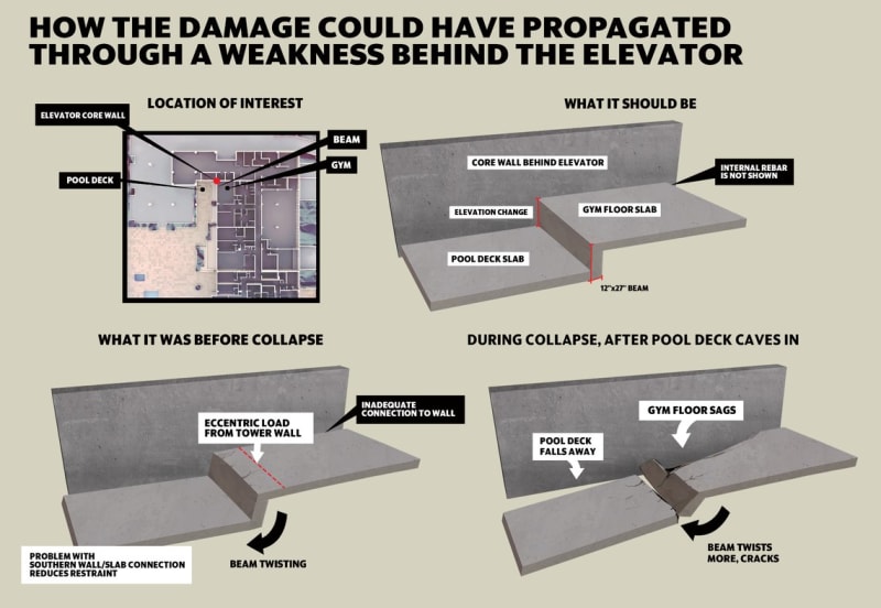

Demented
I think we were onto something regarding the elevator shear wall area. If I can figure out how to share things on here from twitter...
Here is one image -
This is more from Dawn Lehman and the Miami Herald. I can see snippets on twitter but links are behind a paywall.
Lehman said the witnesses’ collective memory suggests that the collapse likely began when steel reinforcement fractured at or near the southern edge of the first-floor slab, in the valet parking area at the western edge of the pool deck.
The tower’s night security guard, Shamoka Furman, provided the framework for the Herald’s investigation when she described a sequence of three distinct failures:
One small, the next large, and the final unspeakably brutal.
The Herald identified six people who heard the first –– boom, boom –– but saw nothing. Engineers said that’s indicative of steel reinforcement inside the concrete fracturing.
A minute later, 10 people heard the pool deck collapse in one thunderous crash.
Seven minutes later, the tower fell.
Lehman worked with a team at the University of Washington to build a complex computer model to identify pre-existing stresses in the structure and test various collapse scenarios.
It was a process of trial and error.
Collapse scenarios were rejected if they contradicted the timeline of events. They were also rejected if the model produced a different damage pattern than what was visible in images of the collapse.
Lehman zeroed in on the connection between the pool deck slab and the southern perimeter wall, where post-collapse photos showed pre-existing problems in the area.
The rusty rebar fracturing could have made the “boom, boom” sound, engineers said.
A computer simulation of the corrosion and missing reinforcement along the wall showed rebar fracturing down the line –– “boom, boom” –– before cracks spread across the deck and into the tower, following similar patterns seen in post-collapse photos.
The Herald’s forensic investigation was based on observable conditions in photographs and videos from before and after the collapse, more than two dozen interviews with people familiar with the building, and the review of thousands of records.
In addition to Lehman, who worked as a consultant to the Herald on this project, nine other engineers reviewed the results of the Herald’s reporting and model.
“If the slab lost support on the southern edge where it was sitting on the wall ... then there could be an unzipping effect because you get more force on the nearby rebar,” said Shankar Nair, an engineer with 50 years of experience with large structures.
Credits: Miami Herald, Sarah Blaskey and Nick Nehamas
