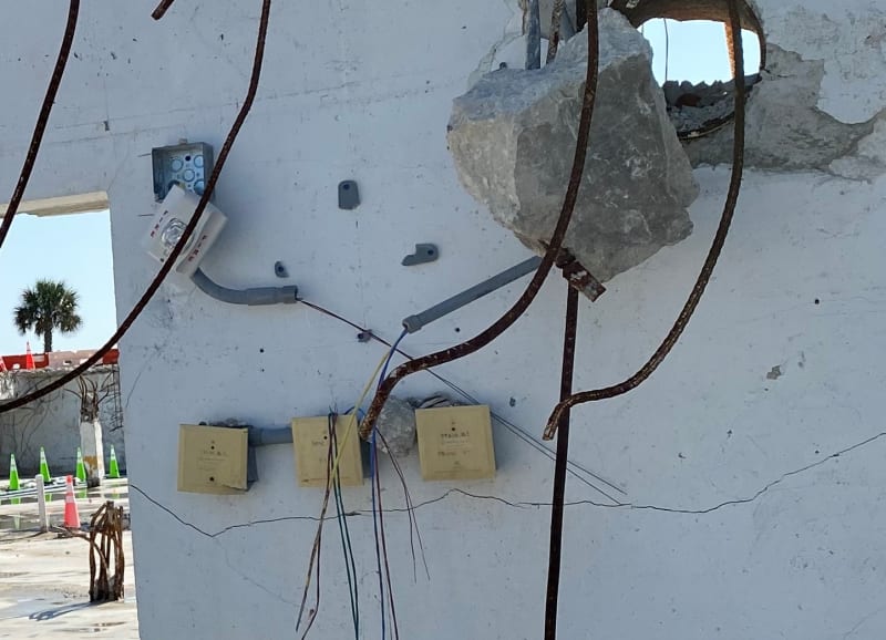

The fire alarm not sounding is not surprising because it was most likely a fault detected by the supervisor circuit caused by the loss of continuity between the pump and the fire panel.
You are definitely on the right track. A loss of continuity in any wiring or loss of connection to any wireless device in the fire alarm system will give a trouble alert at the panel and may call the monitoring company if it is set up for that.
One thing people often don't understand is that the sprinkler system is a stand alone system separate from the fire alarm system and will function fine by it's self. The fire alarm does not start the fire pump. A loss of pressure in this sprinkler system would start the jockey pump first and if the pressure continues to drop, like from an open sprinkler head or a broken pipe, the pump controller will start the fire pump.
The fire alarm system monitors the sprinkler system primarily for "water flow" and "fire pump running" because those imply a potential fire condition. The fire alarm also monitors valves on the sprinkler system and if a monitored service valve gets shut off on the standpipes or at the pump, the fire alarm will have a trouble alert but not an alarm signal.
If there were speakers or strobes not operating on the parking level, it is most likely that those wires were severed by the "deck" collapse or a programed time delay was still in place.

Unless they were installed after the 2018 inspection, both the above ground deck and the garage level did not have fire alarm devices. The fire pump base in the mechanical room was also severely corroded, throwing the alignment of the shaft off and the base and pump were both in need of replacement. With nothing to trigger an alarm, no alarm would be trigged, or so I think.
Since one of the main purposes of a fire alarm is to get people outside of the building in the case of a fire, no alarm devices are required on an outside deck unless there are other special circumstances.
The original drawings show all the required devices in the garage level and we have Jeff and Mr. Kilsheimer to thank for the photographic evidence that there were new devices installed. A strobe and three addressable modules that appear to be for the flow and valve tamper devices for the surviving stair well standpipe. These are in the maintenance room and a pvc conduit leads from here to the stair well.
As for the pump, even if they didn't do a band-aid repair, the sprinkler system would still operate from city water supply and flow switches should still function. The new fire pump was going to be larger to meet new code requirements and that required the larger generator.

Have we any indication when these were installed? I'm looking through the released permits and cannot find anything for the fire system within the time frame.
The special circumstances mentioned by the PE who did the electrical and fire system evaluation for the deck requiring lights and fire alarm devices was that it was a path of egress. Devices were in the stairwell, but not in the enclosed deck per the inspection.
Code compliance cases, there's also nothing beyond mid-2018 in regards to the fire control panel needing recertification and delays due to inspectors cancelling. The mechanical issues regarding the rooftop A/C's, roof vents, garbage chute, and holes in the 12th floor wall were all addressed, but the status for the fire panel inspection has never chanced from scheduled. Permits shouldn't have needed to have been pulled for fixing the code violations, but I don't seem to see any indication of work on the panel or adding fire alarm devices having ever been completed/inspected. Pages FP-1 and FP-2 of Moarbito's don't show anything in regards to new locations either.
Edit: Should be Permit 17-00000602 from 05/08/2017, but this was over a year before the inspection report claiming these devices needed to either be replaced due to corrosion of the electronics, or just overall missing. Permit issue date 02/11/2019.
