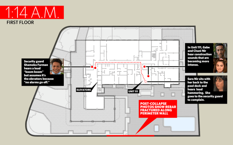

1:14 am
Sara, Gabe and Chani Nir Sara Nir and her children Gabe, 25, and Chani, 15, had just gotten home to their two-bedroom apartment on the first floor. They began to hear noises that sounded like their neighbor was doing construction work. “It’s like one of those things like when you bang on the floor,” Gabe Nir told the Herald. “We thought like people were changing tiles or doing some flooring or possibly banging on the walls, people hammering something.” “The funny thing is we just got home maybe 25 minutes before this happened and we didn’t notice anything at all. We drove in the garage. ... I went and parked the car in reverse. I went upstairs. I didn’t notice anything at all,” Gabe Nir said.
“At first it was like knocking sound. Like somebody is hanging pictures. It would stop. Then more knocking. Then it was more intense,” Sara Nir said. Then came a particularly loud sound, she said. “I was really mad and I left the apartment,” Sara Nir said. She knew the exact time. “My phone was in front of me and I was checking my emails and messages and I thought, OK, I’m going for a few seconds to go to security,” Sara Nir said.
Shamoka Furman, the guard, had heard the sound, too, but told Nir she thought it was the elevator. “I heard like a boom boom but I thought it was the elevator because no alarms went off or anything like that,” Furman later explained to police. Her account is captured on the footage from the responding officers’ body cameras.
1:15
Shamoka Furman “Another boom boom comes. That’s when I heard a Throooom,” Furman said when she was recounting the story to police officers later.
When she calls 911 she describes it as an explosion.

Adriana Sarmiento, “I sit in an open space in the [Solara] pool area and I feel a collapse — boom — and a puff of air, a wind kicked up, after the collapse of the roof of the [Champlain] parking area,” Sarmiento told the Herald. “A wind came out of the garage because the area where we were was in front of the [Champlain] garage. We had a line of sight. This wind passed in front of me and moved the plants in front of me but didn’t move those where I was sitting or other areas,” she said. “And car alarms began to go off. And the streams of water began. And I began to look around everywhere, and try to determine where the sounds were coming from because it was strange and I knew something was happening.”
I'm not going to paste the entire article but y'all need to actually read it to follow the time line.

These sounds were heard BEFORE anything was seen to have fallen. So no it was not the damn pool deck.
Knocking and banging were heard from about 12:30am, that steadily got louder to the point the noises were described as BOOMs.
The progressive failure of the pool deck, originating away from (adjacent to the pool for instance) and progressing towards the building would explain most if not all of the noises that have been described that evening.
