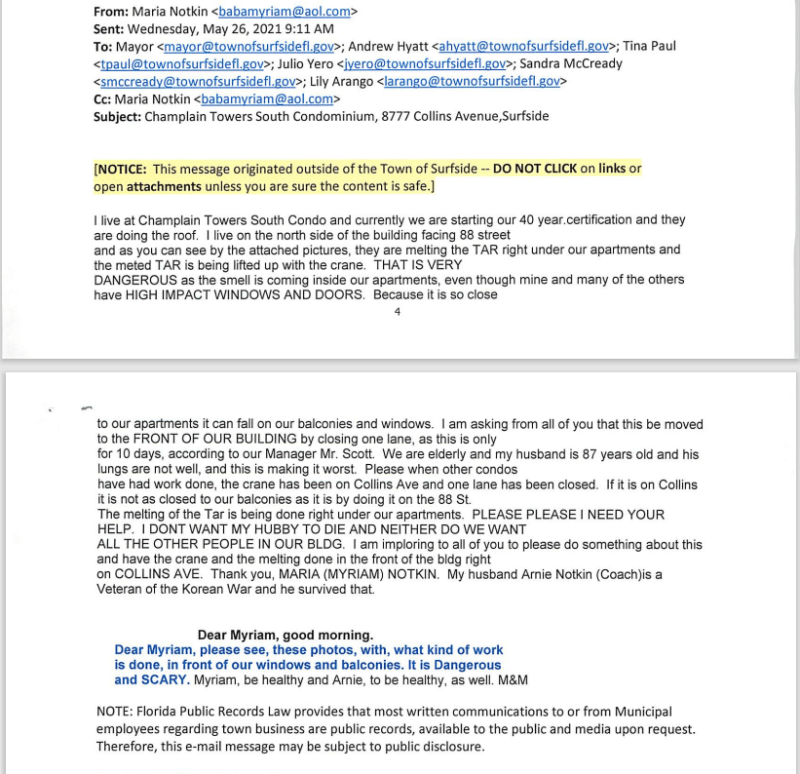

Now regarding the roofer's kettle, it is not practical to lift one of those heavy things all the way up to the roof with a crane you would have to do it every day and you don't want to leave it up there. So what they do is they often pump that tar up there through these hoses into a smaller portable type of tank on wheels that they can roll around the roof and empty out as they need to.
The hoisted buckets, not pumped. Still unsure if it was a parapet davit or an outrigger beam hoist used later on, but early in the process it was a mobile crane.
Allow me to quote a resident's email.
"I live on the north side of the building facing 88 street
and as you can see by the attached pictures, they are melting the TAR right under our apartments and
the meted TAR is being lifted up with the crane"

Edit 2: Screenshot of email from resident confirming hoisting, not pumping.
Some concessions were made to move the tar kettles to the south side of the building for some hoisting, but overnight storage was moved back to the maintenance area on 88th.

Also, your evidence above of the resident's complaint, is from May 2021, a month before the collapse, complaining about what happens during the day. So the flaw in your statement is that you're trying to prove that something happened to him during the day a few months ago is what was happening at 1:00 o'clock in the morning the night of the collapse when nobody is working, the kettle is most likely turned off and is not burning any tar The point I brought up is why did the cops who were walking all over not report any tar smell?
