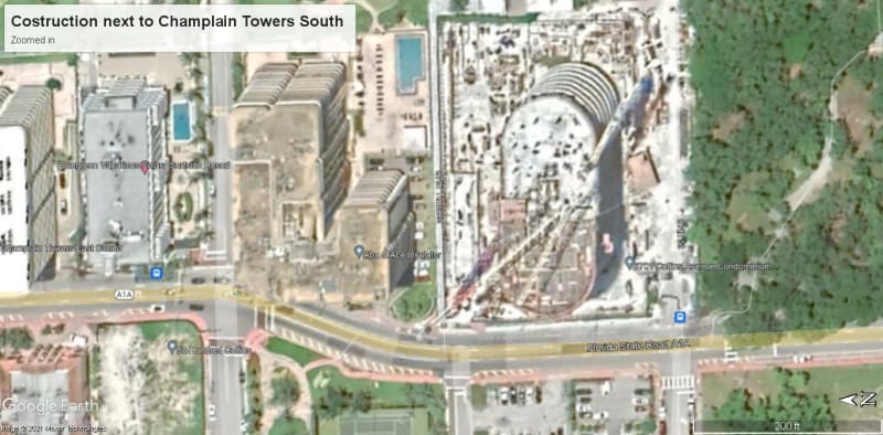

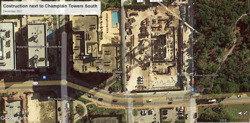

Charlie, good luck with that. The work next door didn't seem to damage the part of the building closest to it, only that furthest away.
"The construction of a new luxury condo tower just feet away from Champlain Towers South caused severe damage to the fragile, poorly designed building in Surfside, eventually leading to the collapse that ..."
In their own words they damn themselves. Well designed and built structures, even averagely designed and built structures cope with adjacent construction. City buildings are always "just feet" away from something else. They go on to claim the building needed only "routine" repairs and maintenance. $15 million worth of routine to head off structural deterioration becoming exponential according to their own engineer? Blaming a building finished in 2019 for years of water incursion and damage noted in a report from 2018?
I feel this case is structurally unsound, and its collapse will not need 14 threads of investigation to understand.

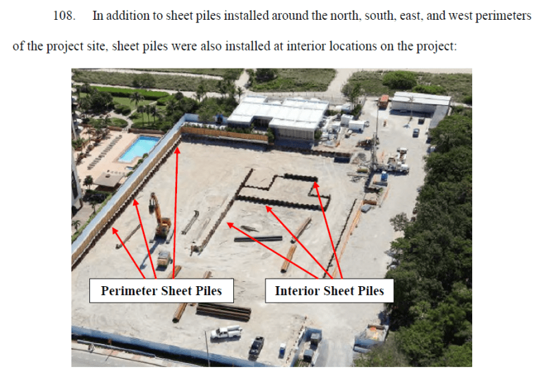

In paragraph 108 of that document, the perspective looks VERY wrong. The CTS pool looks way too small. It's as if the foreground construction area is many floors up in the air.

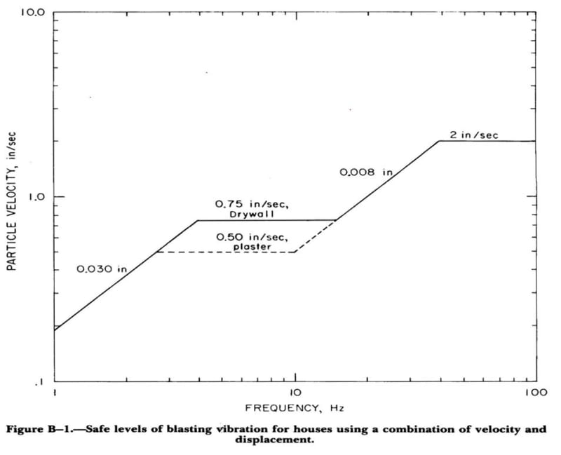

In the building Integrity video, the quotes from the lawsuit mention a rule-of-thumb for vibration damage around 0.5 in/sec and state that this was exceeded many times. I think this is a reference to this diagram:
...that I found here:
Above the line is unsafe, below the line is not, although local conditions and investigations prevail above all. Note the velocity "safe" limit increases with frequency. Note also that the damage referred to is to wall plasters, not to fundamental structure.
I learned a lot about sheet pile driving from this document:
It suggested to me that both the operating frequency of pile driving equipment (around 40-50 hz), and the resonant frequency of the example soils in the paper (15-26 hz) are higher than that part of the limit-line where 0.5-0.75 inches/second pertain (4 - 11 hz). Vibrations at >0.5 inches/sec at those higher frequencies could be staying mostly in the safe zone, leaving maybe some minor surface damage predictable.
To shorten a long story, the complainants will have to prove that the excessive vibrations were occurring in a portion of this chart relevant to structural damage, as well as as dealing with the other issues of why it took so long to express itself and why it was not mentioned by Morabito. It will be interesting to see this play out.

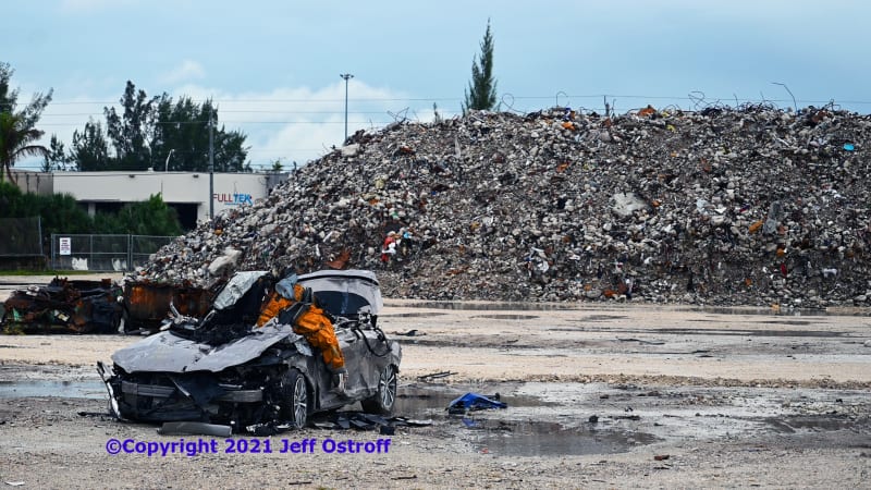

Here is a photo I shot yesterday at the NIST investigation and storage site for the Champlain Towers Condo collapse debris and cars. They had many of the crushed vehicles from the garage there in the NIST lot.
If you look at the 2 crumpled vehicles to the left of the main vehicle in my photo here, you will see these appear to be the tar kettles from the roofing company. I read reports from annoyed Champlain Towers South residents about the noise from the roofs drilling into the roof for the new window washer anchors. if I remember correctly, these vehicles were brought into the Champlain Towers parking garage every night for storage.
It's already been determined that they were parked in the maintenance spots on the side of 88th and not on the roof or in the parking garage
