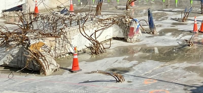

most of the concrete at the bottom would be crumbled leaving 6 to 12 inches of rebar sticking out. A concrete nail doesn't need to penetrate all the way through a slab to hold tight and the rebar, acting like a concrete nail, wouldn't need to penetrate all the way through to remain in place. This would improve the probability.
This is something I hadn't considered- that the end of that column was probably crumbled and the rebar may have been exposed upon contact with the slab. I see your point, that makes this scenario significantly less impossible.
I still think there would be some cracking on the surface.. I can't remember, but isn't that #8 or #10 bar? I can't imagine simultaneously driving a dozen #8/#10 "concrete nails" (perfect analogy by the way) within a square foot area without the top surface of the slab cracking/spalling at least somewhat.

I think it was number 10 and I would expect plenty of cracking and spalling on the surface as well. Unfortunately we don't have clear enough pictures to make anything more than an educated guess.

The steel that remains for the “known” columns is bundled a lot neater and tighter than this mystery mess. There’s also a lot more kinking near the immediate surface when compared to the others.

second, there is no 'exit'... below that first floor slab is dirt. The compressive strength of dirt is not infinite, but all of these elements are incompressible (the dirt, the concrete, the rebar, etc) which means any punching through of the basement slab would mean displaced volume that has to go somewhere.
I hear you. But I know from experience that you can drive pieces of rebar into the ground pretty easily with little to show at the surface for it. Think about pounding in the drill rod when using a nuclear density gauge for compaction testing.
The question to me is can a piece of rebar moving at 20 mph punch cleanly through concrete with the weight of a building pushing behind it? Right now we are missing other plausible explanations.

Why is the top of the Northeast corner of the "H" almost free of rebar?, and what's that crop of rebar on top of the Southeast corner?
Ah, the south side of the "H" is the exterior wall of the building.
$500 for more pixels plz... but looking at the pic above it looks like the cross beam is fractured near the southern end? Maybe it didn't drop all at once and 'maybe' the southern end has been snugged back together..
I noticed looking at the aerial photo that the southern beam looked a bit curved or slightly slanted.

My thought was that if the "K" column broke off from its supporting beam, most of the concrete at the bottom would be crumbled leaving 6 to 12 inches of rebar sticking out. A concrete nail doesn't need to penetrate all the way through a slab to hold tight and the rebar, acting like a concrete nail, wouldn't need to penetrate all the way through to remain in place. This would improve the probability.
This is my feeling as well. Especially with the demo guys having reported the concrete in the columns was soft. The bottom could have easily crumbled prior to hitting the slab.
The rebar is deep enough in there however that it was not affected by heavy machinery in the clean-up process, unless they were ultra delicate and removed most of the debris around it by hand. It's still really farfetched, but so far seems the most logical.

If I'm not mistaken, some of the actual structural guys pointed out early on that forces from the deck collapsing would put a lot of stress and leverage on beam 33. This section of the building also stood for nearly 8 seconds after the initial collapse, and the twisting and swaying motion of the building at that time too is also likely to have played a roll in snapping it. The rebar cage appears intact from all of the photos I've looked at and beam 33 is canted vertically and slightly northwards. If it were not for beam 33 failing, or possibly a column N10 failing, I would not be surprised if this section of the building would have still been standing. Not structurally sound because of the inadequate shear wall, but standing none-the-less.

Maybe it's just some random rebar sitting on the ground? How do we even know it's attached?
There's nothing around it supporting it. The bar with the S bend, among others, on the east most side would be defying gravity if it were not attached/embedded somehow.

Speaking with one of the crane/pile driver operater at work today. He's fairly confident 5kips would dig that rebar in deep enough to stick into the concrete assuming they're #10's. A whole lot less than I was expecting. Actually doesn't sound all thay crazy now.
