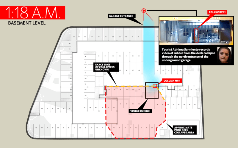

The TikTok video was recorded at 1:14AM, uploaded at 1:15AM.
The timeline stating the deck collapsed at 1:16AM is inaccurate.
And yes Optical, I read all of your post. Swinny is correct in my feelings.
The deck collapsed sometime before 1:14AM if the TikTok video captures only the aftermath of the deck collapsing.
The timeline is pure nonsense meant to twist the narative.
Edit: we are also dealing with at least 4 different, non syncronized devices that all limely show different times at the same time. So we cannot fully pinpoint the times. The additional security video from across the street that can see the deck will confirm the timing and sequence.

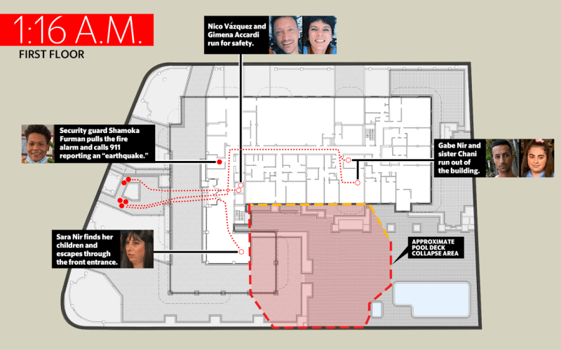

What time do you think the pool deck collapsed?
Sara Nir says she was looking at her phone and it was 1:14 when she got up to walk down the hall to speak to Furman. It was after or during their convo that she saw the valet parking collapse.
Demented (Industrial)22 Nov 21 19:09
"The TikTok video was recorded at 1:14AM, uploaded at 1:15AM."
You were arguing the time of the video, not the 911 call.
My point being, the silent alarm and first 911 call from the deck collapse were before 1:16AM.
Optical98 said:
Spartan
The “valet parking” ≠ “the pool deck.”
I don’t think the whole of the pool deck collapsed in its entirety during a single instantaneous event at a specific moment in time.
I’ve been saying that since the first thread, second at the latest, before this place was overrun with garbage. And I restated my thoughts on that specific matter just several posts ago. You chose to ignore the salient point I made and instead went off on a tangent about how I was badgering you.
I think it's been forgotten that the valet deck, which had extensive slab damage and was partially over a pencil thin and cracked column as well as with a damaged outside support wall, collapsed before the rest of the deck. Cars jutting up in the air BEFORE residents even began to see the actual pool deck collapsing into a "sinkhole".

I don’t believe that a deck collapse sequence has been established by witness statements. The Herald’s engineer makes the case for the failure of the attachment to the south perimeter wall. Josh Porter supports Jinal Doshi’s theory that the long span and last minute elimination of transfer beams are likely culprits. As for witness statements, they tell us that:
[ol 1]
[li]Nobody who survived to tell about it actually saw the deck as it collapsed.[/li]
[li]Sarah Nir ran to the lobby window immediately and saw that the valet parking area, which was the closest part of the deck to where she was standing, had collapsed. We do not know if she could see beyond that, considering the clouds of concrete dust in the dark of night.[/li]
[li]No witnesses described a series of deck collapses; all survivors experienced a single deck collapse.[/li]
[/ol]
Within a day or 2 of the collapse, I read an interview with the tourist who said she recorded the video at 1:18. I believe the pool deck collapsed at 1:16.

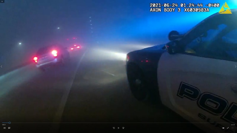

My other video of the police bodycams, shows the first officer pulling up in front of the building at 1:24, 2 minutes after the collapse, but 7 minutes after the 911 call.
The timestamp on bodycam shows officer getting out of his car at 1:24:44, but he actually pulled up to the building at 1:24:14
