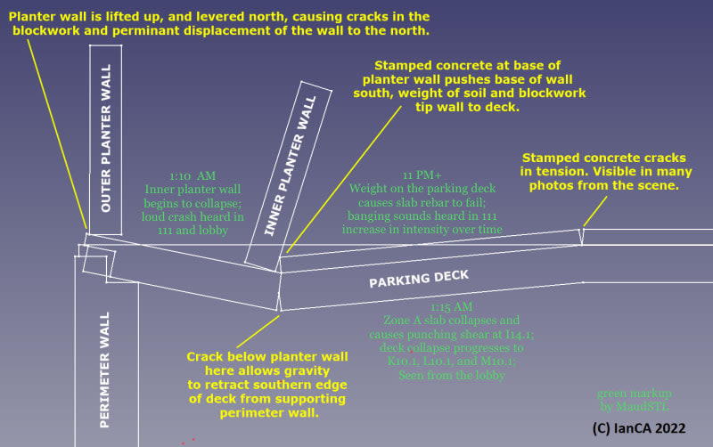

Maud, I am thinking first cracking noises may be slab under inner planter wall failing. I think that area drops creating punch shear at I14.1 next while tearing East as well. Clearly later rebar shears at South wall could be gun fire type noise.

Can there be a five minute gap between the planter area dropping and the punching shear that brought down the deck?
We have to think about the loud crash at 1:10 that was followed by rumbling and the deck collapse at 1:15. The tricky part is that whatever happened at 1:10 was not noticeable to the Vazquezes down in the garage right before 1:15. So if it broke through into the garage, it would have to be of limited size.
This level of detail is why I think it’s a good idea to talk about all the logical narratives that could make sense within the context of the theory.
Maud, I wish other folks would chime in too. I think it is possible the slab broke under inner planter wall and fell or sagged some distance, prior to progressing further. Perhaps a little time delay?
I do too. I come from a field where there’s no penalty for brainstorming solutions. I have the impression that structural engineers don’t feel comfortable doing this.
I was imagining that if the rebar under the inner edge of the planter started failing earlier in the evening, the pull on the slab that ultimately tore it off the south wall could be gradual. At 1:10, some of the the Zone A connections to the south wall could have failed and made that loud crashing sound. The edge of the Zone A slab section could have balanced on the top of the garage wall for five minutes until enough load was transferred that the slab punched through I14.1 at 1:15…and then it all went down fast in the paths we’ve theorized.
Maybe someone else can imagine a different narrative that would make more sense.
Maud, I think you have a good narrative, based upon evidence we have. I have a feeling that slab was source of noise heard a day or two earlier as it sagged and cracked.

Thanks. I’ve mapped the narrative onto IanCA’s annotated drawing for the sake of discussion.
==> IanCA, I’ll delete this if you like.

I’ve attempted to map the Parking Deck Failure Theory onto the Witness Observations from the Timeline. Please review and provide corrections to this draft.

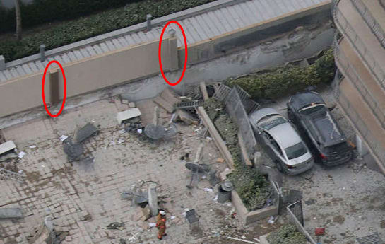

I would like to share another observation related to the dust which is mentioned several times in the witness statements.
In several photos, including the one posted by thermopile on 3 Feb at 22 23:35, the column at the transition from the 8-foot wall along the pool deck, to the 4-foot wall by the planter is much lighter in color than its neighboring column to the east, as shown in the cropped images below. Notice the East side of both columns is brown in the first image.
Credit JoeRaedle Getty Images
I first noticed this back on October 30th and it took me until Nov 3rd to come up with a good explanation. I think it is simply dust causing the lighter color, both columns are the same color again in later photos after it has rained. But the dust didn't come from the collapse of the building, because both columns would be equally exposed to that dust. I believe it most likely came from the pile of rubble below the column and was blown vertically by the air being exhausted from the garage as a large section of the pool deck collapsed, coinciding with the air pressure described by Adriana and Roberto at ~1:15. I believe that the air pressure was caused by the rapid reduction in the volume of the parking garage. I don't think there would be as much dust on that column if the failure had progressed from north to south. I suspect the dust adhered to the column because surfaces were wet following the rain the afternoon before. If the failure had happened first near the building then later to the south, dust in the parking garage near the building would have been blown north towards Adriana and Roberto. But they didn't mention dust and it doesn't look dusty in their video. For me, the dust is another big topic in itself. Why was there so much dust? I think it was caused by the chemical action of acids produced by salt and pool chemicals (exhausted in that area) leaching calcium compounds from the concrete (seen forming what appear to be stalactites in the garage tour video - not the cylindrical injection ports with flanges) leaving a very weak powdery concrete behind.
I hope that helps.
I will try to catch up on responses to other posts tomorrow.

The person I would like to ask is the security guard. No one has ever asked Shamoka Furman if she was able to hear the banging sounds in the lobby. We do know that she heard the loud crash at 1:10. It is my understanding that the sound of rebar breaking travels through the structure more than the air. If that is so, then it makes sense that people on the first floor would be more aware of it. Various early interviews did say that people were used to hearing all kinds of banging from the roof work that was going on. But that would have been in the daytime.What made Sara Nir go to the lobby to complain is because the loud crash occurred at night.
IanCA, your concrete deterioration along South wall due to pool chemicals is interesting as to why concrete at south wall perhaps failed from chemical reactions, and perhaps just let go of rebar at first. The pool curb and top edge was rebuilt in the past. Perhaps partly due to pool chemical failure or the fact that they were raising the patio deck height by decking over the old pavers. Lots of poor operational and maintenance decisions going on. BTW, I wish I had worded my radio silence better, as I was trying to thing out loud to brainstorm what I think your complete theory is, and I really looked forward to you either confirming some of my thoughts or pointing us to your complete logic.

Edit: IanCA, I believe I am following your logic on initial event under planters at transition between slabs and privacy wall transition.
I am seeing tension reinforcement in bottom of 13” slab not lining up with tension rebar in bottom of 9-1/2” slab, and possibly a construction joint at slab transition.
I will just wait for your complete logic and evidence to flow.
