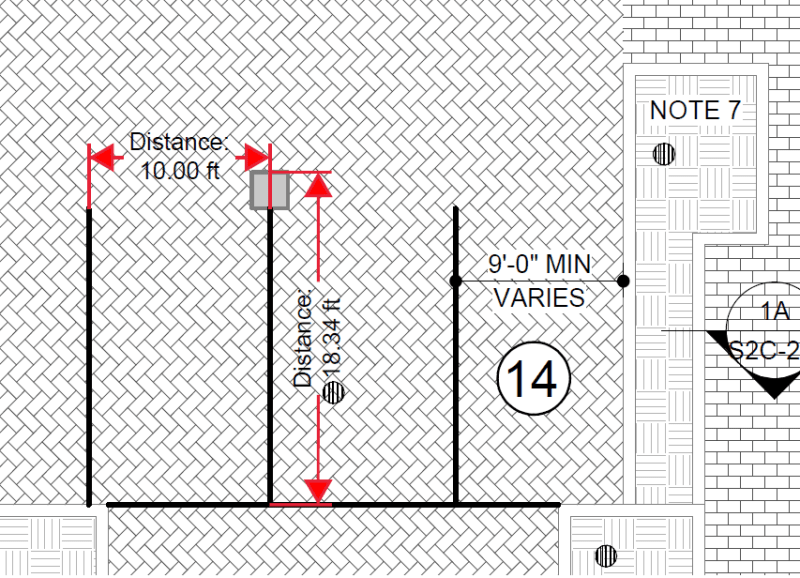

According to Morabito's Sheet A2C-1.0, the parking spaces in the area that we have been focusing on are approximately 10 feet wide by about 18⅓ feet long. Column I-14.1 would only have had 2 parking spaces in its tributary area. If you assume that you have a heavy vehicle and a sedan, the actual load for those two parking spaces would have been about 10 Kips in the tributary area for column I-14.1. Because of where the axles would have been (due, in part, to the planters), I don't think the weight of vehicles would have been attributed to the wall tributary area. So the vehicles would not have, theoretically, contributed greatly to the loads at the wall, but I would have to double check that. The thicker slab and that Column I-14.1 is bigger than K-13.1 should have helped.
One of the reasons I have focused on the pool deck is that the dead load for it is about 168 lbs per ft², whereas the parking deck's dead load is about 171 lbs per ft² or almost the same. Yet, the parking deck is thicker and has bigger columns. Columns K-13.1 and K-15 should have been the same size as the parking deck columns.

Thanks Geezer, I was referring to the planter area calcs as not being necessary. The others I find useful. My concern about the weight of the vehicles is their potential impact at the slab/column connections to which they are adjacent in addition to any slab deflections to which they contribute.

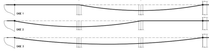

IEGeezer said:
For the deck to fail at the southern wall first (i.e. without any punching shear in the interior columns), I would think that the only way that could happen is if the deck failed in shear at the wall.
Please can you try to explain to me why you would think it would not be possible for the deck to fail in the way I depicted in the image shown below:
IEGeezer said:
For the wall to pull out like it apparently did would be difficult to explain unless the interior columns failed in punching shear first, causing a catenary that would clearly have pulled the deck away from the southern wall, like so.
Thanks very much for the diagrams I find it helps the discussion. The columns we are talking about are 24"x24" columns, aligned on I, that supported the southern portion of the building that remained standing. The columns absolutely did experience some lateral deflection as witnessed by the cracks in the stucco at the south and north corners, but I have not seen any evidence to suggest that the deck was displaced somewhere between 8 and 16 inches to the north as it would need to be to allow the deck to detach from the wall.
Here are my thoughts about the three cases you illustrated:
Case 1 shows the deck still attached to I14.1, so the northerly deflection of the deck is comparable to the northerly deflection of the column and as such minimal.
Case 2 shows the deck after I14.1 punches through, I agree significantly more northerly displacement is possible in this case due to the downward displacement at the column and the length of the arc, but the top of the deck would not crack in tension (as we can clearly see it has in the photos) and at the end of the collapse, the deck would be draped against the wall as we see in zone C near the jacuzzi.
Case 3 again the top of the deck would not crack in tension and the end result would be the deck draped against the wall.​

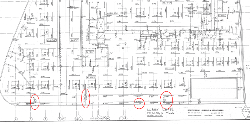

Unfortunately, the parking area encompassing spaces 44, 45, 46, and 47 had weaknesses on both sides. Certainly a construction joint to the west and probably one also to the east beneath the planter running south to north to the pool deck gate. Is there a way to explain the rotation of the planter wall and fence in the foreground of the image below, if the initial failure is column K-13.1?
That condition can be explained by failure initiating at the southern wall because there are multiple cracks in the parking deck (a large diagonal crack is visible behind the silver Honda) and the southeast corner is able to rotate down, lifting the north end of the wall up and right, before the column below punches through.
I completely agree that the columns on K should have been 24"x24" to support the parking deck loads, but I would also include K-11.1.

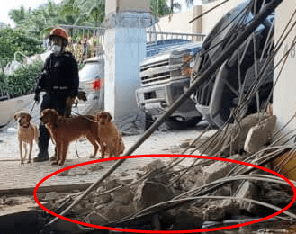

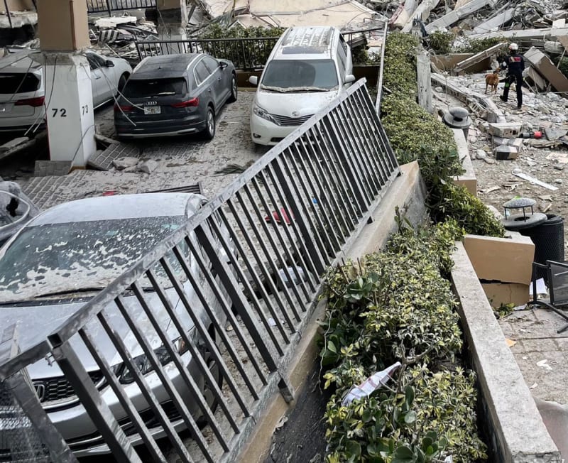

Optical98 said:
Closer images, actually that looks to be a hard cover for the truck bed that's been dented in
Thanks very much for those images, much appreciated. I hadn't noticed the apparent hole in the wall in the channel 7 screen shot.
The explanation I have for the hard cover being dented in is perhaps that Ileana Monteagudo and/or Shamoka Furman stepped on that surface, and fell, while trying to reach the street. They are seen/heard standing right there in one of the police bodycam videos and Shamoka says the lady is injured.
In one of the previous threads there was a linked document where someone was trying to pin blame on 87 Park (before the whole lawsuit set of videos in this thread). One of the points made in there was suggesting that the series of images you're talking about again suggested the collapse initiated in that surface parking area - iirc either K13.1 or K15 was implied. I don't remember exactly when but if that rings a bell for one of you and you can find it quickly it's worth revisiting.
I think any rotation in the final orientation can probably be explained by falling onto an uneven surface underneath i.e. the part on the right of that image landed on a car and the part to the left didn't so it is lower and rotates the fence. Those tension cracks could be due to the loss of support after a column punches through rather than the cause as well, couldn't they?

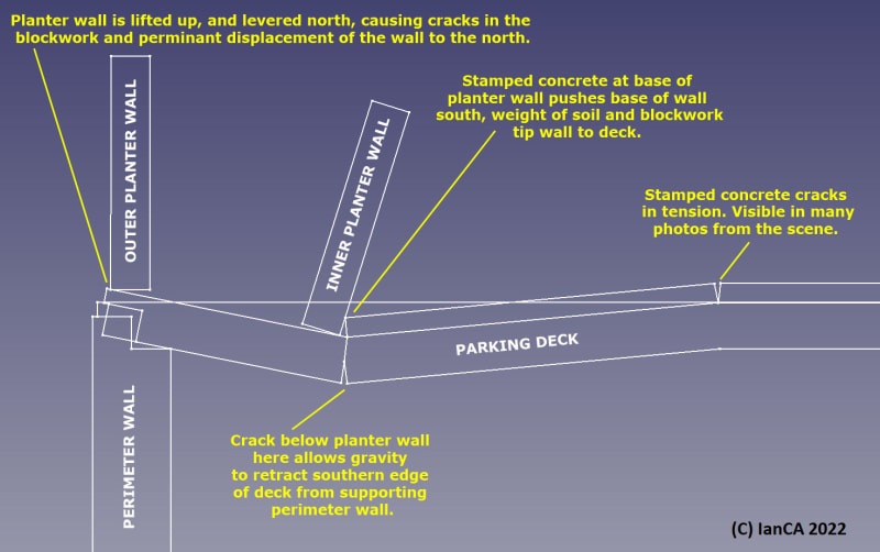

I'm struggling to see how the slab could be pulled off the deck if it was sitting on top of it (which seems to be the case from the diagrams earlier). Even in @IanCA's diagram, it is far from pulling off entirely. Only after it punches through the 14.1/15 line would the geometry for that work for me.
If we're looking at this area of the building it seems more likely to me that the slab was starting to punch through, that was being restrained by the horizontal rebar at the wall/slab connection (providing catenary tension), and when that rebar failed it meant the punching shear was high enough to completely fail. Probably at K13.1 because all the calculations (@IEGeezer's the other day and those summarised in a BI video a few months back) indicate that is the most highly loaded and also one of the small section columns. That would then put a lateral load on the slab/wall joint and could pull it off, and the redistributed load would immediately cause a punching failure at the other columns under the deck (which were all highly loaded already).

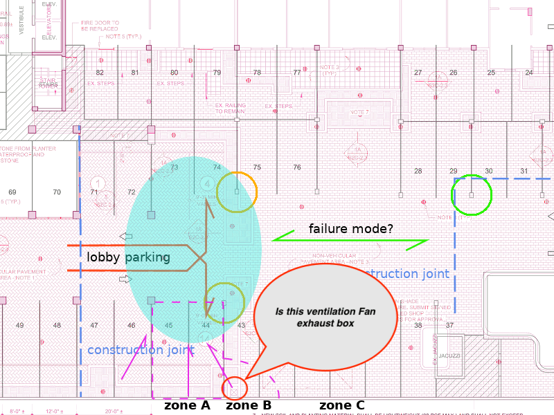

It would appear the relationship between location of pool chemicals, the ventilation fans in garage, and robust water source, would point to direction of weakest slab areas due to chemical reaction. Then there are natural designed in weakness like construction joint locations along this path, as well as other inherit weaknesses.
Is the box identified by the speech bubble, a potential exhaust point for ventilation fan?

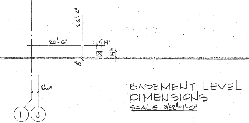

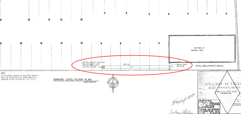

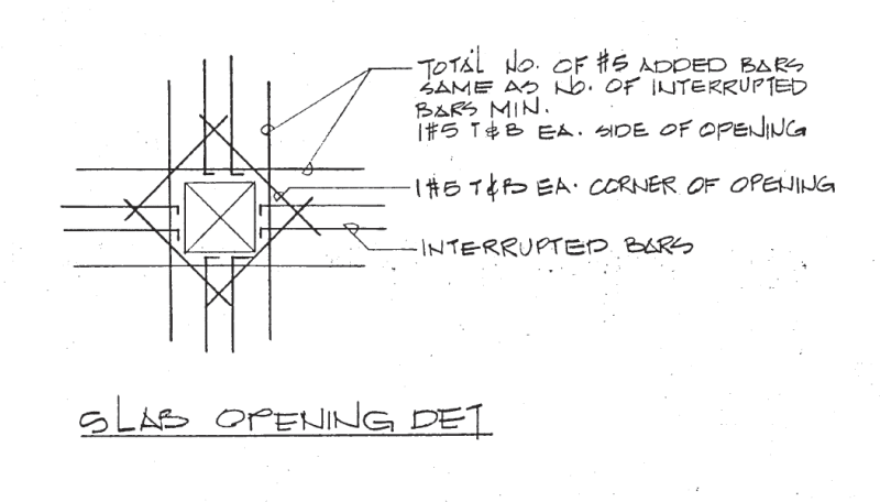

Yes, that is exactly what that is. The ductwork is shown on sheet 22 of 336 in the 1979 plans.
There is a 30x10 duct from the pool equipment room to EF-23 via a 19x19 opening on the pool deck as shown below:
But the detail for the opening on sheet 33 of 336 (S2 of 14) was inaccurate because there was a dimension missing for the distance of the opening from the wall:
Which would make the framing detail shown on sheet 38 of 336 (S11 of 14) difficult to follow
We already know that the atmosphere in the pool equipment room was detrimental to the concrete from the photos taken by the pool service guy a day or two before the collapse. I acknowledge that the loose concrete in the pool equipment room had been removed in preparation for repair, so it looked somewhat worse than it would have otherwise. But the effects of the chemicals are still significant.
@ Red Corona, thanks for your input. That diagram was at a time fairly early in the sequence of events I am proposing. I will create another showing the positions later in the sequence.
IanCA, So we have interrupted rebar at opening, that could be in a line under inner planter wall and great location for chemical reaction to concrete
thermopile said:
So we have interrupted rebar at opening.
@thermopile Yes, but as far as can see on sheet 31 of 336 (S5 of 14) the bars in the deck along the wall were on 12" centers, so it would be one or two bars, top, and bottom.
IanCA, Understand not many bars but if also a N-S or E-W construction joint in area, coupled with chemical reaction in area, things get very interesting in this area.
