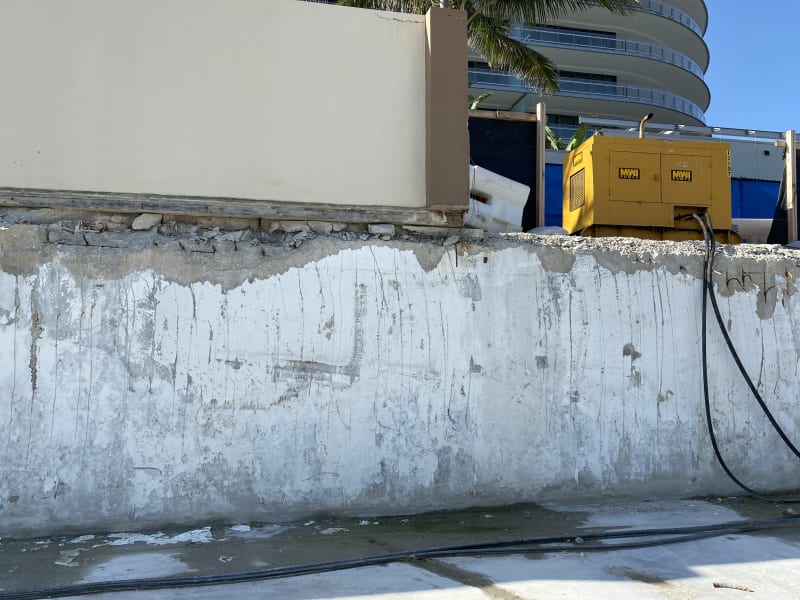

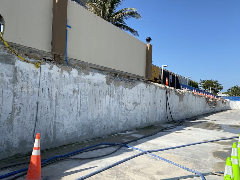

I had posted these photos back in September, these were shot during a walkthrough of the collapse site on 9/10/2021. These show pretty close up if you can zoom on them, look at the damage atop the wall and slab connection.
Also, look where the dark brown stripe on the wall meets the slab, you can see very clear detailed damage and the rebar sticking out.
Does the concrete erosion the base of the wall look significantly worse where the generator happens to be sitting? Is water continuing to run in at that spot even after the site was cleaned up?
Well not to say "even after". I think it was a reasonable question to ask how water was entering the basement before the collapse. But I never saw much said about it as they struggled to dewater. Was there a lack of access to observe those details?

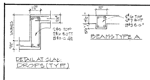

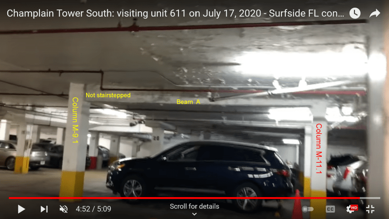

What happened to the structure in front of KLM-9.1 is a head scratcher. Here are some thoughts. The illustrations may not all fit in one comment, so I may have to post them in follow up comments. First of all, here is the detail for the step beam and "Beam A" (see Figure 1).
Figure 1:

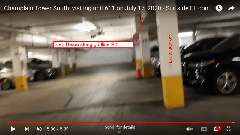

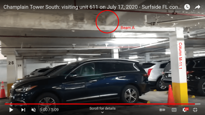

Between K and M along 9.1 the slab drops 7 inches instead of 18 inches. There is a further 11 inch drop between gridline 9.1 and 11.1 between K and M. According to Figure 1, beams type A should have been stair-stepped along KLM between 9.1 and 11.1. However, if you look at Figure 2 (from the garage video), you can see that along M, beam A is NOT stair-stepped. The garage video does not show beam A along K and L very clearly. However, we can surmise that beam A along K was also NOT stair -stepped and that it WAS stair-stepped along L, because the step-beam along gridline 9.1 was shallower between K and M along 9.1. That would have made L-9.1 the weakest column. Apparently not built according to plan. Thus, beam A at column M-9.1 would have had a deeper section that in the drawings and might have been been more resistant to shear. Just a thought.
Figure 2 (three views of column M-9.1):

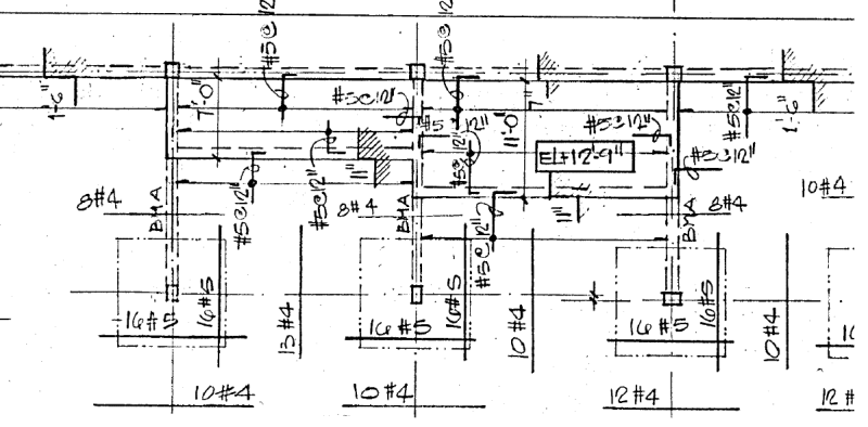

Here is the detail of the structure in front of KLM-9.1. It is from the original Breiterman drawing s5 of 14 with 1/17/80 revision titled "Lobby Level Framing Plan."
