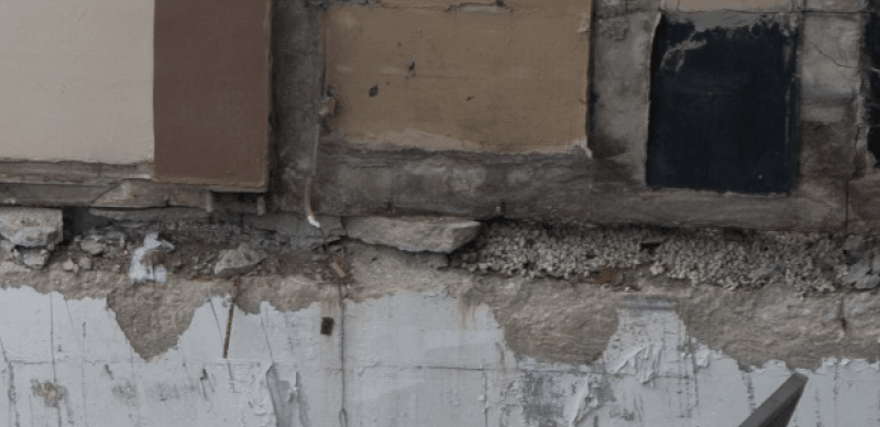

@IEGeezer,
Looking at that image I'm not sure what material strengths to put in for my calculations. Any suggestions, please? I see one piece of bar that pulled out, it looks as though the rest, were missing, already failed or sheared off due to embrittlement.

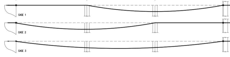

A quick calculation shows that for a 25 foot span to pull 8" off a support, the far end would have to drop almost 6 feet. To borrow Geezer's catenary sketch, this would be easier to accomplish if a line of multiple columns punched through as opposed to only the closest one and suggests that a broad area of punch out was required to pull the slab in zone A off the south perimeter wall. The lowering of the lobby parking into the garage level may have been graduated by a succession of failures rather than all in one go.

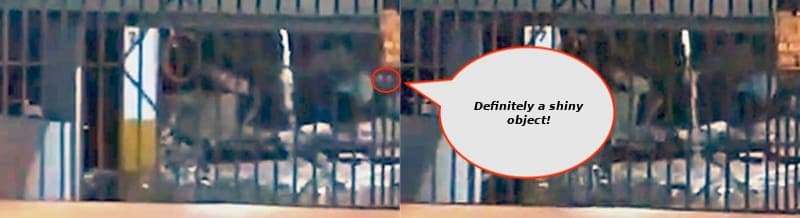

a rough and ready stereo 3D garage image with one frame from the USA today video and one from the TikTok video. Hint: concentrate on the far items, not the gate.
I'm reupping the video's in case anyone can improve on this. Attached USA Today video:
Sym P. le, I confirm your 6 foot drop at far column. I came up with 5.74'. But then I decided what if break in slab is at 10 feet from wall. When I did this, it only took 3.16 to 3.6' range drop at break to pull slab off wall. If slab has two opposite breaks, seems the drop would be even less to retract slab from wall. A V-shaped Fold if you will as seen on after collapse damage around rear of DuraMax
Sym P. le said:
…we do not know if witness accounts reflect one or more, or which event in a sequence.
Although there is a gap of about five minutes between the first crash heard on the first floor at 1:10 (which apparently did not cause noticeable debris in the garage) and the deck collapse at ~1:15, the witness statements we have in the Timeline do not describe seeing or hearing a deck collapse sequence. They all describe hearing a single, very loud crash when the deck collapsed at ~1:15, rather than a multi-stage deck collapse.
And don't forget to look cross-eyed until you see three images with the one in the middle being 3D. There is a deleted post which I missed. I will say there are some planters there but that's about it as far as recognizable items. Albeit the parking deck would not be that far east. right? Is the point what can't be seen? At one point it was claimed by someone that car(s) are visible along the perimeter south wall. I think I felt that was true at the time. But that's a lot of staring cross-eyed, and it hurts after a while.
I threw it up in case it triggers some creative brainstorming.
Got it. I am thinking single seminal loud crash heard by pool attendees across the street from garage entrance. After that thought, I don't know in light of the south wall failure theory. It probably put things into focus but it's not coming to me. This theoretical wave progression could have happened so very quickly. That's a problem.
Could be something reflective bifurcated by the gate. Another thought I had which probably isn't worth much is that if 13.1 punched first before the section along the wall then you would not be able to see any cars along the back wall. And there was a general feeling that I recall when these images were being looked at ad nauseum, that the back wall and car or cars were visible. Of course this suggest that the pool deck area had not completely collapsed yet when the tic toc video was made. Because I can't quite imagine how you could see autos along the back wall if the pool deck was as low as it is in the final collapse. But that's a lot of unconfirmable crap too.
If tail lights, where along back wall is that auto? Was someone in that auto or could initial rubble fell on car and triggered lights to come on due to impact with auto? Does this suggest collapse started from West side of that auto and perhaps North of that auto?
