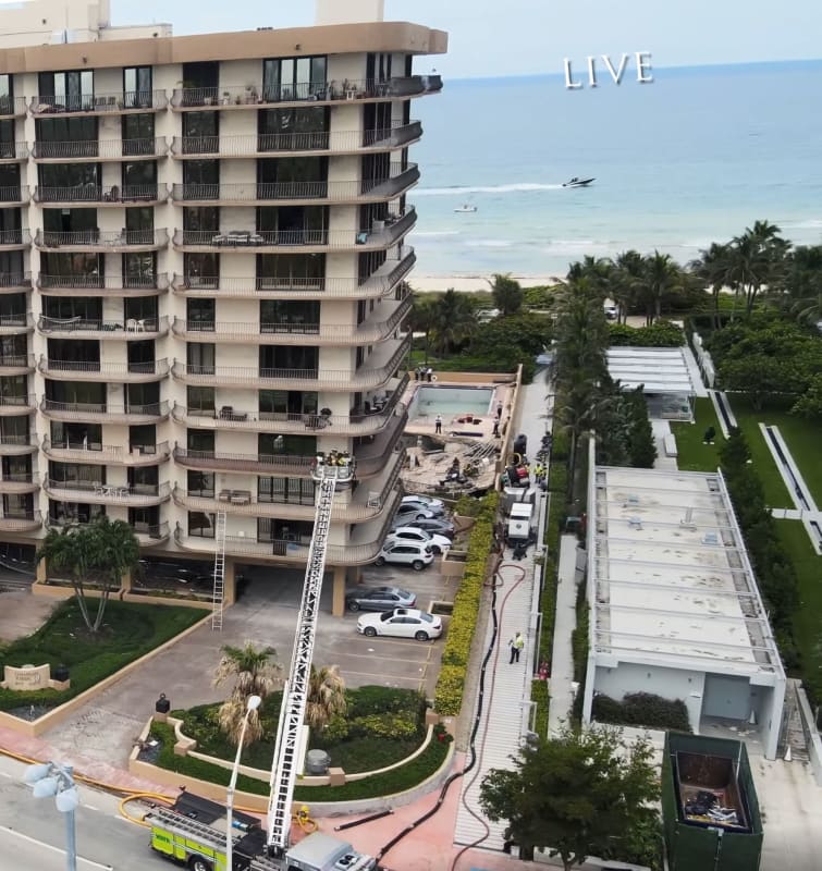

Which scenario of Sym P.'s case 1,2, or 3, makes it more likely that the inner planter wall in zone A falls substantially below the level of the visible stampcrete along the tension crack line. Is there any case where you would expect to see the planter wall lying over on top of the visible stampcrete or wedged against it?
Zebraso, I am thinking the diagonal movement in Zone 2, and break up of planter between 1 and 2 indicate movement or failure at or west of K-line first. Zone 3 and beyond where deck at south wall is draped, tells me the wall won there and pulled building columns South.
Also, with wall winning Zone 3 and east, would explain missing column early in garage video
Are you saying there was rotational torque on the "missing" column?
Does that explain all rebar sheared of but one?
Sorry typo above. Replaced deck with south wall winning. I think IEGeezer’s one way slab idea makes since. Perhaps some rotational torque on The missing M11.1 deck column from weak deck attachment,at South to North construction joint on East side, letting go to create one way slab with catenary tension tug of war between missing M11.1 column and L11.1 and South wall.
Can anything about the amount of diagonal movement be inferred here:
south-north-planter-failure_Miami-Dade_Fire_Rescue_6_crop_uddvpl_punch_and_shift_dgxwjy.jpg
Ok the idea I'm reaching for is that there could have been a large horizontal moment about a vertical center in the area of the step beam if the large area of the pool deck moves west even slightly. Obviously the columns that punched are more or less vertical but I don't think that means a significant horizontal moment did not exist.
What I find interesting in the red-circled area is that there is so little damage to the column. The pavers tilted up as the deck fell down. You could almost just fold them back, and get back to normal.
Y'all might want to integrate that into your views of horizontal movements of the deck.
How is it that the deck dropped down that column like it was lubricated by KY Jelly?
I am sure NIST will reveal all, at some later time.
spsalso
stampcrete held together better than the deck parking deck? KY? It's the basement parking so maybe. Too much KY. Must be the transients.
Edit: I find it improbable that the folded up stampcrete rolled or fell over the top bar and landed in that position. So I am rejecting any conclusions based on where it appears in these photos. IOW I think it was moved. I'm not drawing anything nefarious but I don't see any other way than someone did not like it where they found it. Maybe the hole there was a safety issue.
